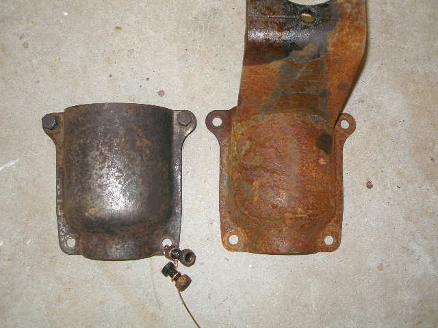

After watching the "take if off" thread I was intrigued to give it a try myself.
I was given a phd from my Uncle Tom (thanks UT!!) He had a barn burn down and the phd was near the barn. Paint was burned off and all the plastic was gone. Insurance bought him a new one and they didn't wan't the old one. The gears still turn and it was full of oil. It was outside for about 6 months before I got it, so the rusting was in full swing. I was in the market for a phd anyhow, so here's my chance to get one for low cost. I considered taking it in to get it bead blasted, but thought I would give electrolysis a shot first. It's a Danuser btw.
Got it home and started tearing it down for a rebuild. Here's a look at the progress after a week in the tank. I used a 5 gallon bucket and a small battery charger. Nice stream of bubbles comes off the part when it is on the 10 amp charge or the 55 amp start assist mode. So far I am using one pice of 1/2 rebar. Every other day I would wire brush the part and the rebar and turn it so both sides get even exposure.
For the bigger parts I will use a trash can and give the welder a try.
So far my impression is... this will take forever! Hopefully the welder will greatly speed things up as the battery charger will take forever when I put the big parts in the tank.
I'll try to keep this thread updated, but so far, so slow.
btw you can see the rust still on one nut. I guess there wasn't good enought contact to the bolt. It's been tightened up so it should come clean now. Both parts were equally rusted.

the one thing that may have slowed you're process down was the rebar, using only 1 bar in there may have slowed the process a lot. I did both 12" long I beams in one bucket over night using my 2 amp charger and 5 hunks of rebar. these had set in the back of the pickup for about 4 months and had sat on the building floor for who knows how long. I hit them quick with a soft wheel just to know off the easy outer rough stuff. hooked up the charger ran it on 50 for a min, switched to 10 for a few more min and set it at 2 over night. the parts were in a 5 gallon bucket. came out blackened but 100% clean. I hit them with a hot water bath & wash to remove the black gook and dried them & painted... :D these parts were probably less than 3" away from a hunk of rebar. all the rebar were tied together with steel tie wire, same with the parts tie wire that is. the wire bubbled a lot but was rust free ;)
also note a lot of chargers will not run on boost 50 amp very long, auto shut down. also you may not have had the soap enough to the one which has both carbonate and bi-carbonate. that soap don't work so well... I found the arm&hammer stuff at Meijer's store. none of the other stores had the carbonate stuff but rather had the stuff with baking soda in it (bi-carbonate) which is bad... I also added some rust remover that is almost a bleach type crystal stuff just as a experiment. can't say it helped or hurt though since this was my 1st try at it.
markM

Spiker,
Thanks for the tips. I'll try to add some more metal and make a grid.
I was wondering about the black gunk. I wasn't sure if that was part of the process, or something that would come off with more time.
I'm using Arm & Hammer washing soda - found it at my grocery store.
Going out to the farm this weekend, so I will bring the welder home with me for the next part.
Mike
