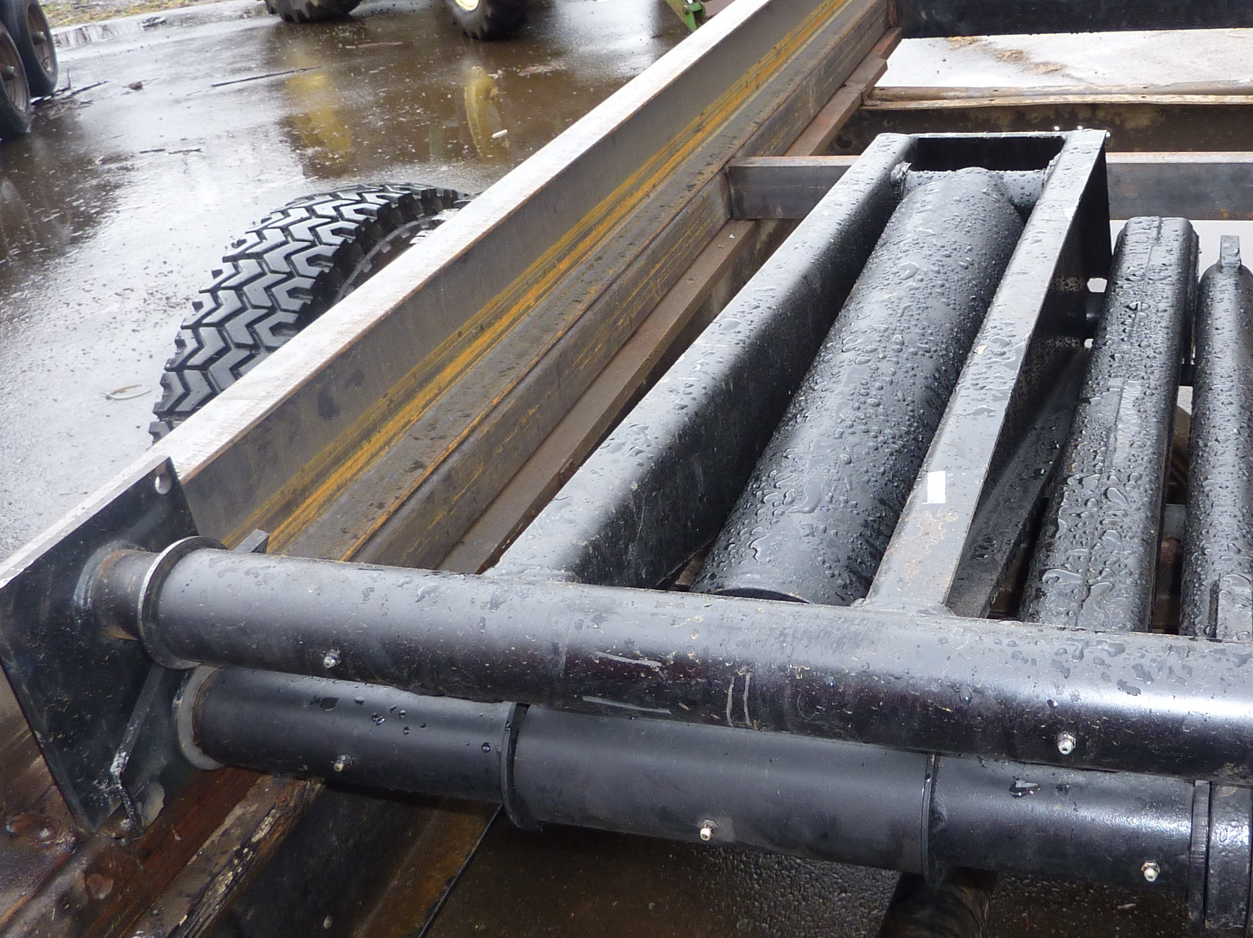

You are totally right on rob and duplicate Hooked on HP. The cost of the cyl is the main part and the amount of steel is offset by the bracing you need on just a straight push system.
I know about pricey, this one set me back just a hair under 2g. It is a 14 and a half ton unit.
To build one wouldn't be that expensive at all. 4 lengths of tubing or channel, depending on the strength you need and 3 pins, and something to make the flanges where the rod end of the cyl connect to the top part of the scissors. To make the pivots, I have used pipe to put the pins through. Welding the pipe in for all the surfaces that the pins go through make for a plenty strong unit.
Here is a pick of it extended. Wish I had a better pick of it folded.
The main thing if you notice is that the distance from the center pivot to the ram pin is half the length of the extention of the cylinder. It is important to have a bend still in the scisssors when extended. If you will notice the pivot pin goes all the way across under the cyl rod when extended, and when closed the cyl is raised where the rod pin is for leverage on initial push.

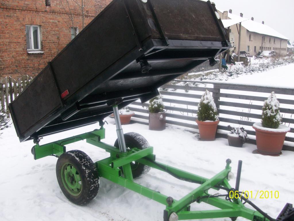

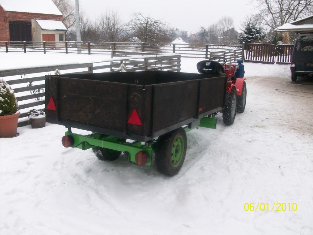

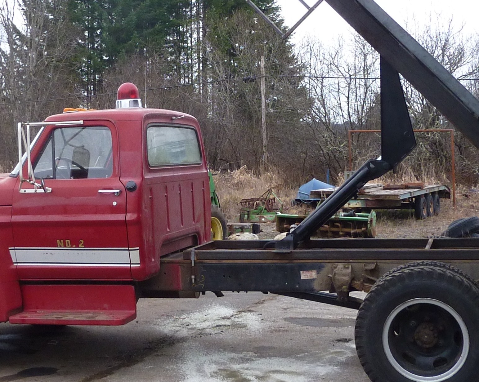

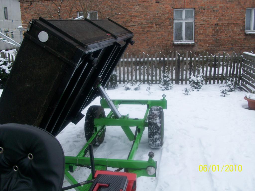

This is an example of a home made dump trailer that I saw advertised for sale for about $1700. It is interesting in that it can end dump or side dump! I had never seen that before. I will include pics. It does use a telscoping ram. I do not think that the sides are all that strong, but it is interesting, nonetheless.
Mike
   / My dump trailer build #58
Yes it is. I like how they use 'trailer balls' to hold whichever side they want.
   / My dump trailer build #59
Mike
And it's JD green too!
I'ld love to see better pix of the dump hinge setup.
