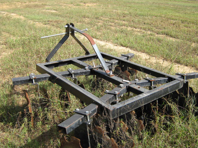

I have a 66" operating width Monroe Tufline 18/20 Disc Harrow weighing 915 pounds, pressuring each pan with 46 pounds.
I have attempted to aerate Saint Augustine turf and Argentine Bahia pasture grass with the pans set straight. The straight set but concave pans simply roll over the sandy-loam pasture like thin wheels, making no impression whatsoever, though pans are notched, front and rear.
Now I use a Field Cultivator for Bahia pasture grass aeration. PHOTOS.
My Tufline maintains 1-1/4 miles of fire breaks with Top Link adjusted short but with front and rear gangs in soil contact. The somewhat rough output encourages the disturbed verdure to die and decompose fairly quickly in Florida high heat and high humidity. I also de-crown sandy farm roads with the Top Link adjusted short.
There are great variations in conditions within the several United States. And considerable variations in the results desired from Disc Harrows.

I added 5 100 pound tractor weight's to my 6' KK disk without any issue . I also changed up the angle of the front by moving - rewelding the hangers , thus to get more bite . I use mine only for weed abatement and fire line building around property , thus not concerned about " level " ground . It is just a angle framed disk and have had no issue's with any part with the added weight . Weigh's over 1,100 pounds now with the disk , weights and some I beam steel I added to hold the weights . Notched disks front and back . Here in Southern Oregon , I have a lot of red clay , thus If I can catch the moisture right , it will sink it to the axles but won't gum up with clay .
Pull it behind my TC 30 with HST . Going downhill , I use middle range and can get really good turn over of soil . Uphill , Well with the 12% - 14% grade , low range is best it will do , but still gets decent soil break up .
As I stated though , My use is different .
I initially had a galvanized water tank as weight . Maybe a 40 gallon ?? ( was over 4' tall and maybe 16" in diameter ? ) . It worked okay , but I knew I needed more , thus removed tank and picked up the used tractor weights from a metal scrap yard . I just used a couple of ratchet straps to secure the tank . Even with that tank though , you knew there was extra weight back there .

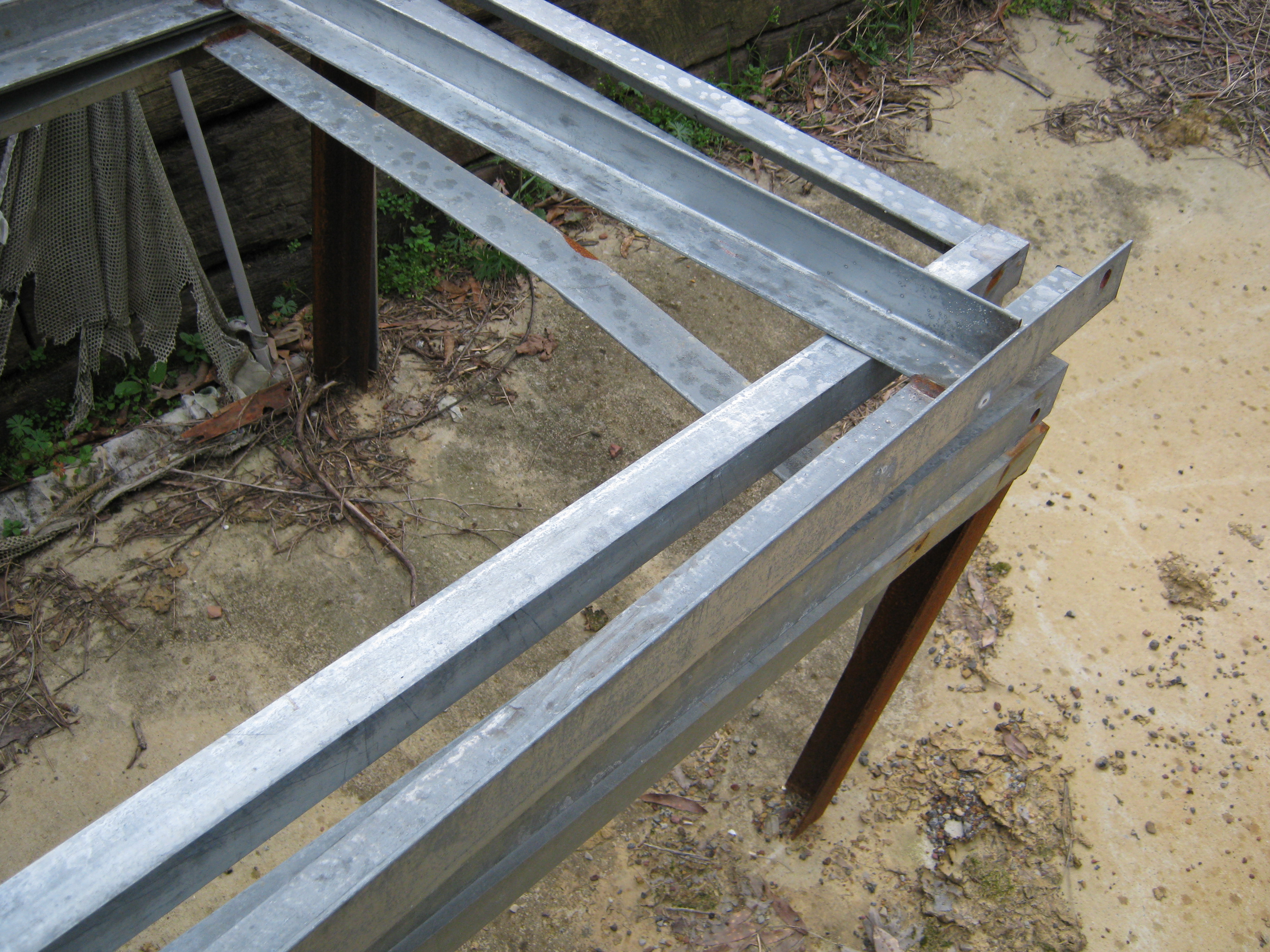

I have a light weight disk( Land Pride 1048 ) and a 475# "blob" of concrete. Together they are just one tiny step short of damaging the disk. I have to be VERY careful when using this setup. Particularly, with the M6040.
If I were to do a lot of disking - I would get a much heavier disk.

I use 5 gal plastic pails filled with concrete (~110 lb each) with a length of galvanized fence post to make handling easier.
Good luck
