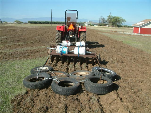

I added 5 100 pound tractor weight's to my 6' KK disk without any issue . I also changed up the angle of the front by moving - rewelding the hangers , thus to get more bite . I use mine only for weed abatement and fire line building around property , thus not concerned about " level " ground . It is just a angle framed disk and have had no issue's with any part with the added weight . Weigh's over 1,100 pounds now with the disk , weights and some I beam steel I added to hold the weights . Notched disks front and back . Here in Southern Oregon , I have a lot of red clay , thus If I can catch the moisture right , it will sink it to the axles but won't gum up with clay .
Pull it behind my TC 30 with HST . Going downhill , I use middle range and can get really good turn over of soil . Uphill , Well with the 12% - 14% grade , low range is best it will do , but still gets decent soil break up .
As I stated though , My use is different .
I initially had a galvanized water tank as weight . Maybe a 40 gallon ?? ( was over 4' tall and maybe 16" in diameter ? ) . It worked okay , but I knew I needed more , thus removed tank and picked up the used tractor weights from a metal scrap yard . I just used a couple of ratchet straps to secure the tank . Even with that tank though , you knew there was extra weight back there .
Fred H.
/ My disc harrow needs to gain some weight #17
I have a light weight disk( Land Pride 1048 ) and a 475# "blob" of concrete. Together they are just one tiny step short of damaging the disk. I have to be VERY careful when using this setup. Particularly, with the M6040.
If I were to do a lot of disking - I would get a much heavier disk.
View attachment 595906View attachment 595907
/ My disc harrow needs to gain some weight #18
I use 5 gal plastic pails filled with concrete (~110 lb each) with a length of galvanized fence post to make handling easier.
Good luck
