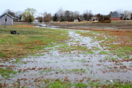

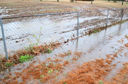

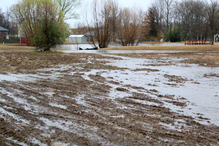

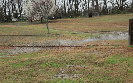

OK guys, last week I posted a thread asking about box blading with turf tires on my tractor. It rained a LOT last night and my back yard swamp has reappeared so this morning I went out and took some pictures of the raging waters. This is NOT the worst it's been. It has come down to the point that I would've been scared to cross this area it was running so fast. But this gives an idea of what I'm dealing with. I've attached pictures of the runoff and also an overhead view of the path it takes. I know the pictures don't give a clue as to the actual terrain and slope but I'll try to get elevations of the areas once it stops raining to add to this.

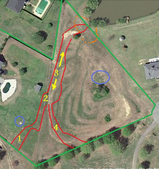

The red lines on the picture indicate the path of the water as it runs across the properites. The orange circular area is where it pools up when the pond gets too full and the blue circles are mounds of dirt left over from previous digging (before I owned this place). The smaller one is from the dig out of the pool in the upper left of the picture and the larger one was moved from where the pond was dug out. I own both lots in the picture (green lines) so making grading changes is entirely up to me. I've got a son in law who works for a company that has bobcats with FELs that I can get onsite.
Here are my initial thoughts:
Area 1 - use dirt from the mounds to build up on either side of the water run just to try to keep it focused as it runs.
Area 2 - I'm thinking of digging out where it runs from my back yard to the back lot over towards the pond, again just to channel it. I'm not talking about digging it out much, just to define the run more.
Area 3 - I would use more dirt to line and define the edges.
Area 4 - The runoff from this neighbor's yard is much less than the others but it too needs focusing so it's not so wide as it runs down. I would try to build it up again on either side to do this.
I've still got to cut both lots so anything I do can't be so drastic that it prevents that. Do these ideas make sense?

I didn't study every detail, but in general you want to enhance what the water is trying to do now and provide a defined swale to the pond. a box blade would work nicely for that job.
I dried up a low wet area on my property with a drain swale down the middle. the trick is to work with the topography as much as possible, the best way to do that is to observe it when it's flooded, like in your pictures.

JB4310 has a good idea, a boxblade could do you a world of good in this instance. You don't want a river, just a diversion.
Seeing the property would be the best thing, but, it looks like you have a workable plan.
The treeline at the back, and down the right side............doesn't show much on the pics, is there a potential problem there also?
The orange area...........'without seeing the lay of the ground in person'.............I think you may be stuck with it.

I looks like you have a natural swale that provides drainage. You just need to enhance it so the middle is a little deeper and turn it from several yards wide to just several feet. It doesnt need to be a deep ditch to drain that land. If you have a good eye you could do it with a box blade, but to get the correct fall all the way so you dont have any standing puddle areas, you need to be using a surveyor level or laser level to check the grade all the way. You could start with just a few passes with a straight blade or box blade that is tilted slightly to make a slight swale and then wait for the next rain to see what happens or rent a level to check your fall as you ditch. You would need to run a land plane over the low areas after you ditch it to make sure you arent leaving some dams that block the inflow of water. THis could make it worse than it is now if you throw up a berm between the swale and the the higher land, it will move the standing water back up the hill. We had a swamp on our land that ran parallel to a creek. It couldnt drain into the creek because there was a high ridge that blocked it from getting there so it was always full of water. We finally got a dry spell last year that allowed us to move that ridge into the swampy area and allow the whole thing to drain naturally again.

Gradually defining where you want the water to flow towards the pond with a box blade (and quickly re-seeding to prevent erosion) sounds like a good plan.
Can not tell by the picture, but where does the pond water overflow to when the pond becomes full? It sorta looks like the far side of the pond (opposite your property's drain flow swail) is the overflow for the pond for when it becomes full. Regardless, I would want to know where the pond overflow is and where the excess pond water has to go before I altered things.
