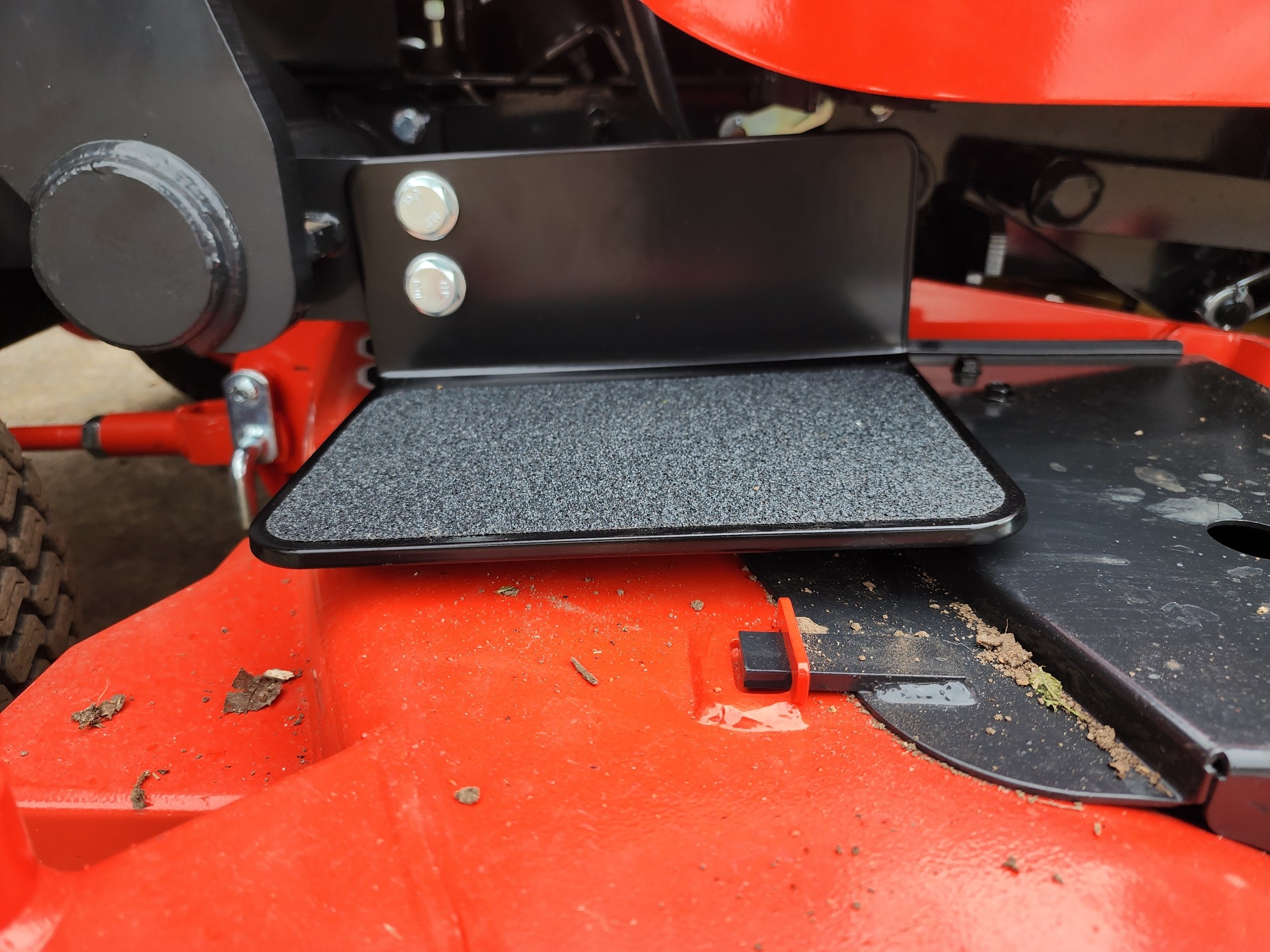

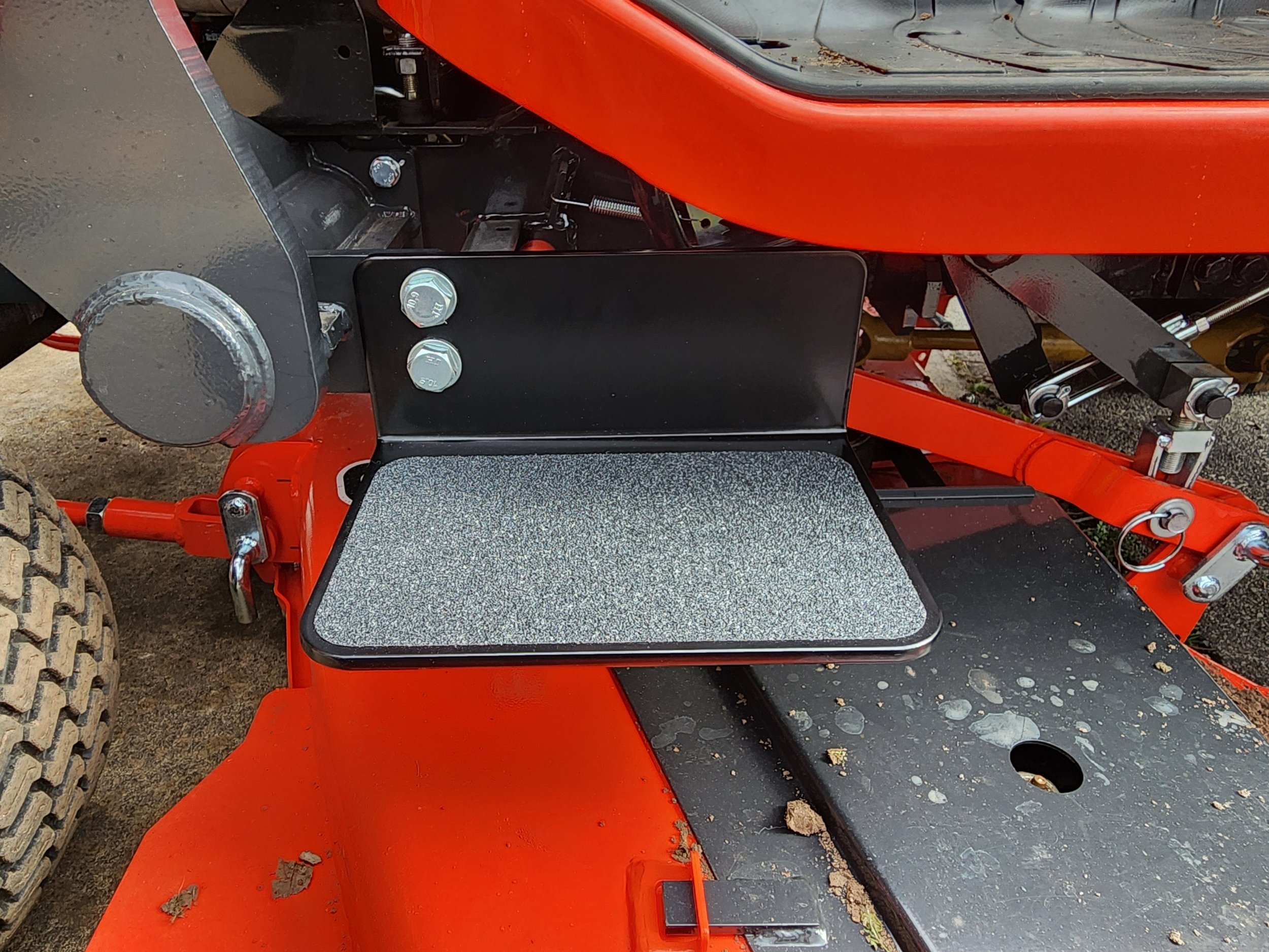

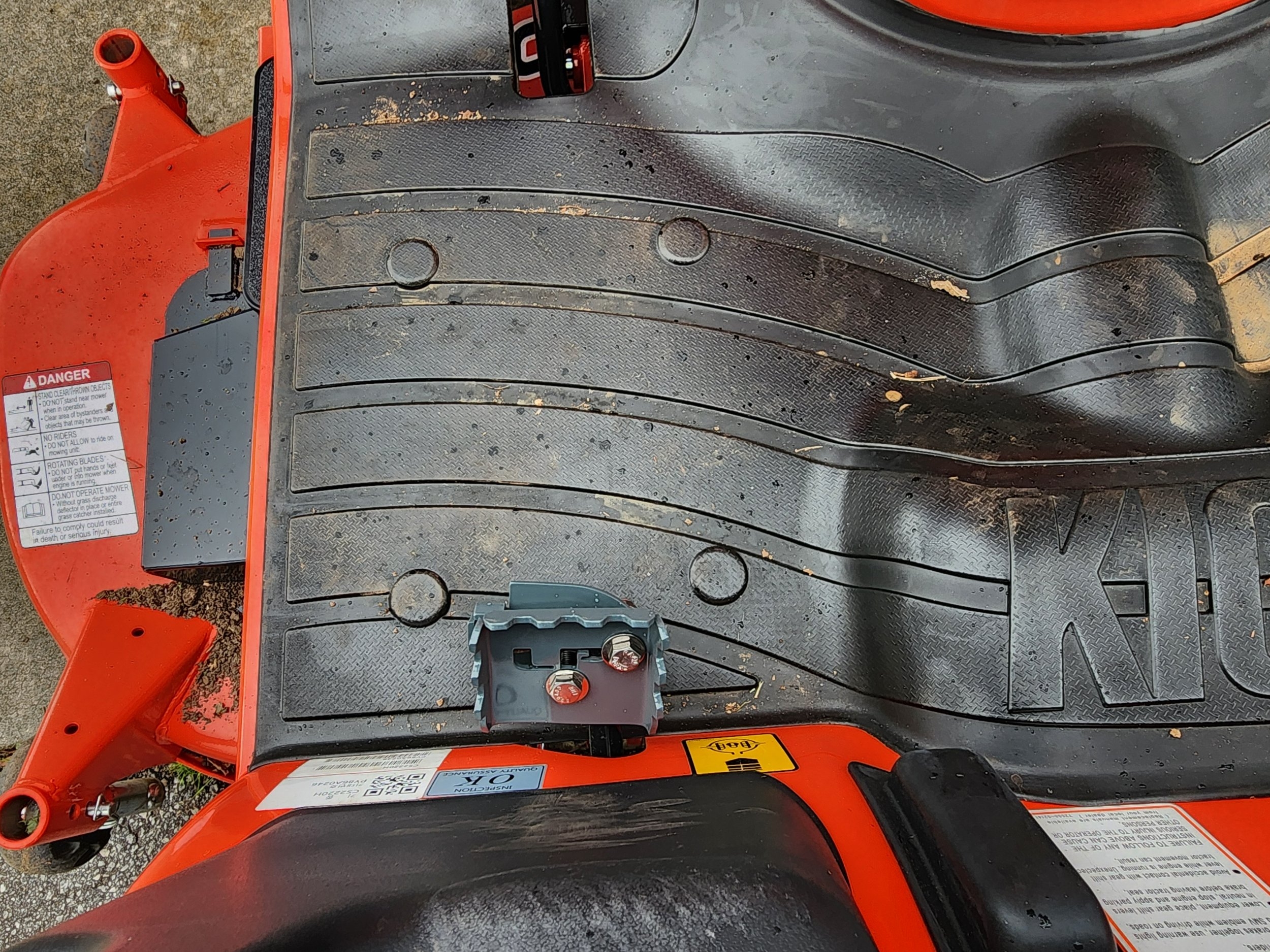

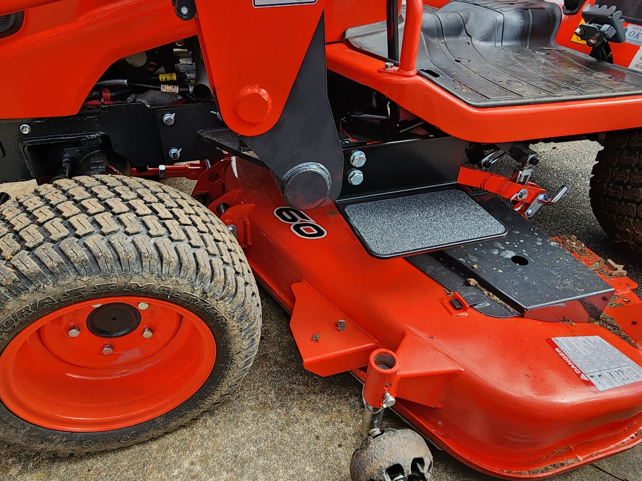

Newest is the Broken Anvil Step which I believe is pretty new for them. That is some precision fitment right there.

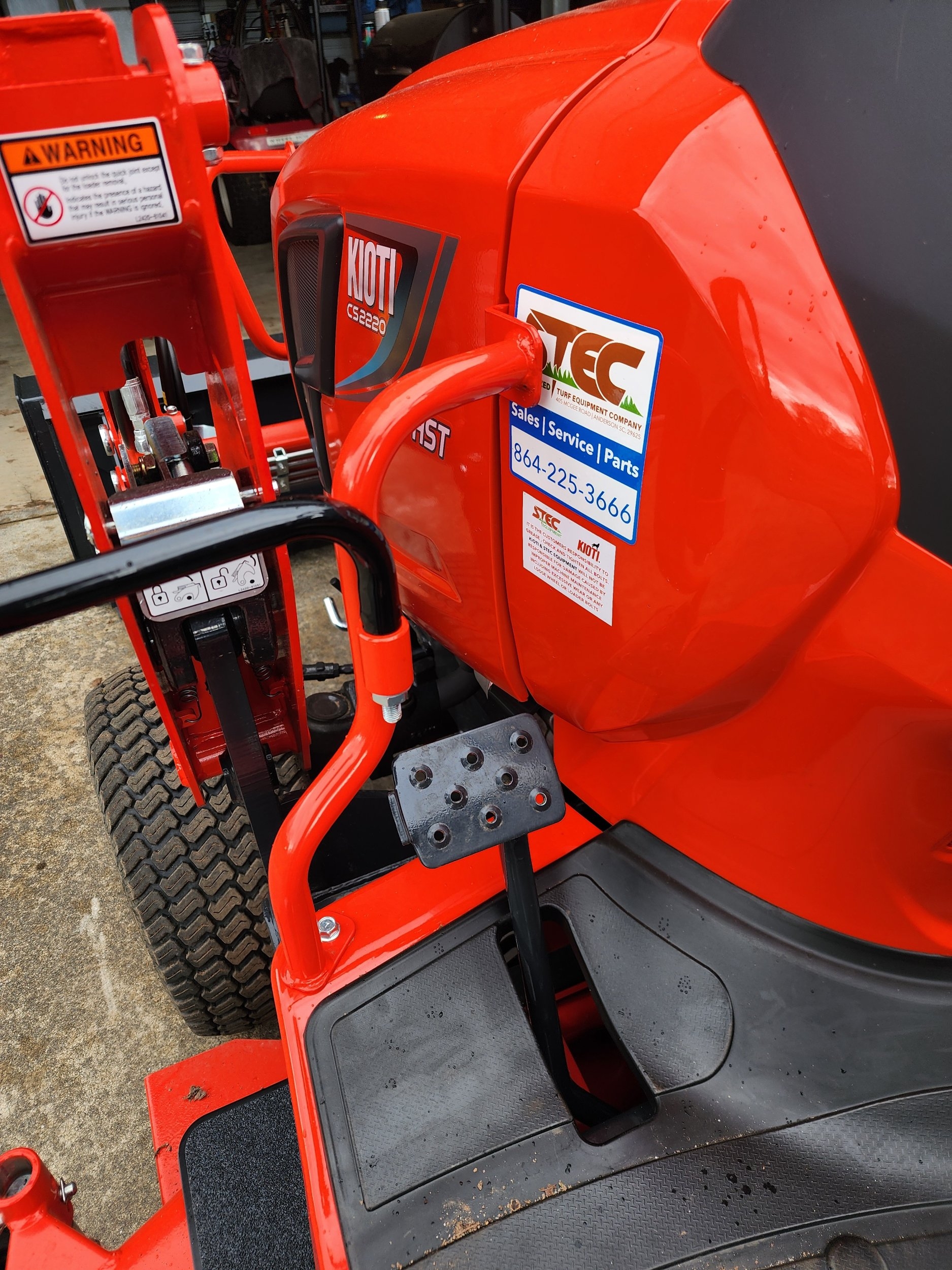

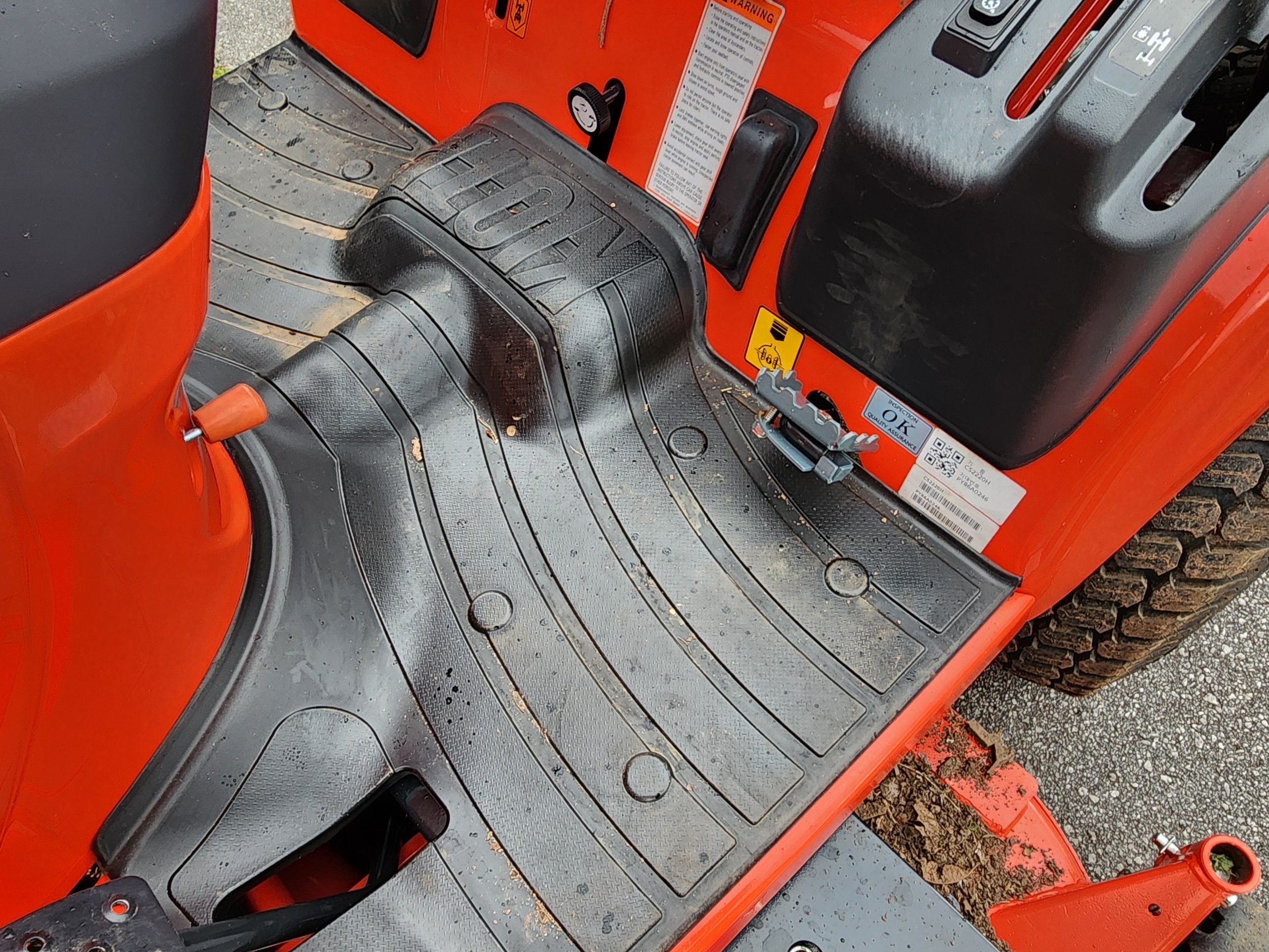

Next we have the Lown Performance diff lock pedal.

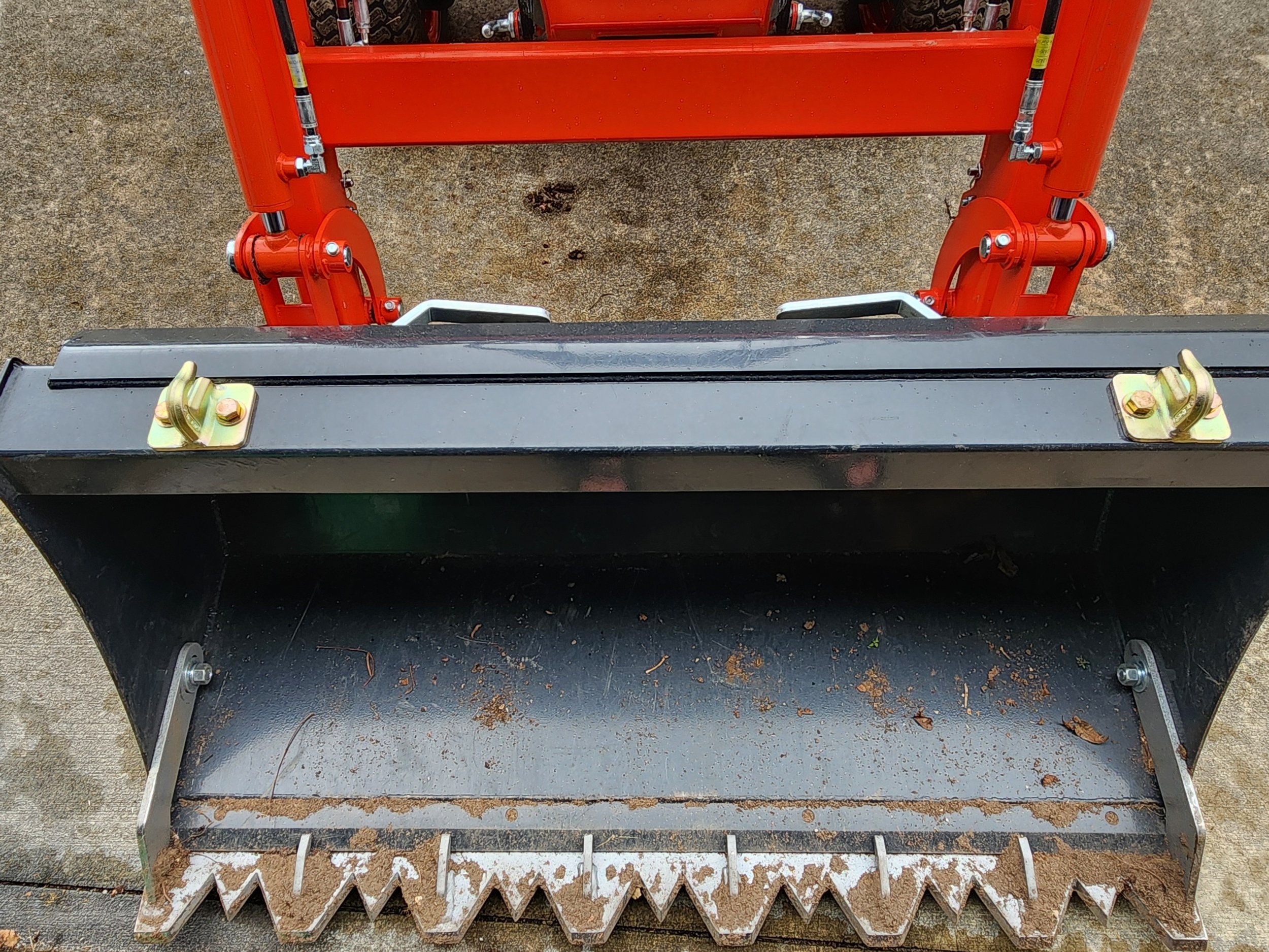

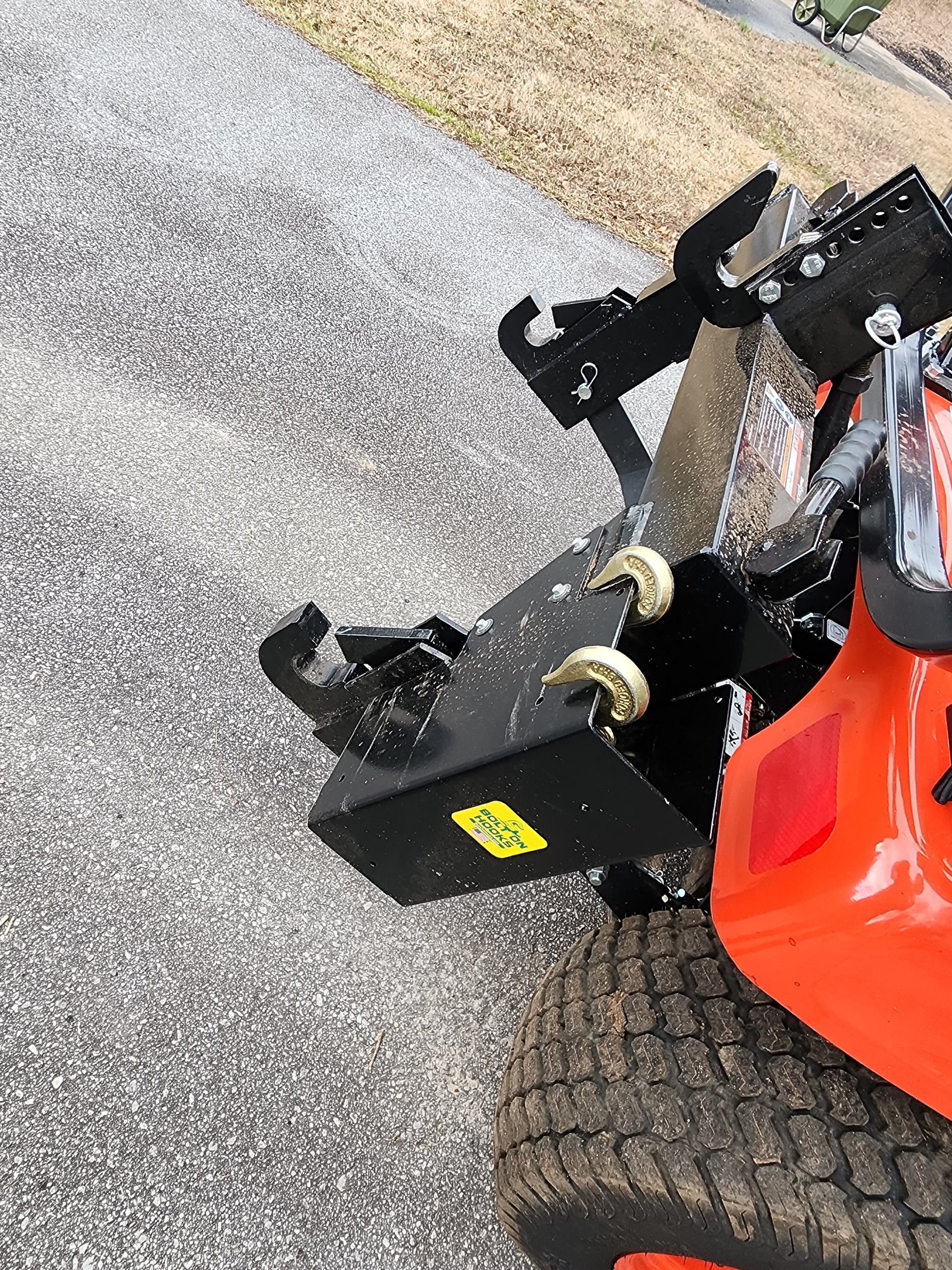

Don't think anyone needs an introduction to the BXpanded Piranha tooth bar or KBOH's (Kens bolt on hooks) also the KBOH quick hitch chain box

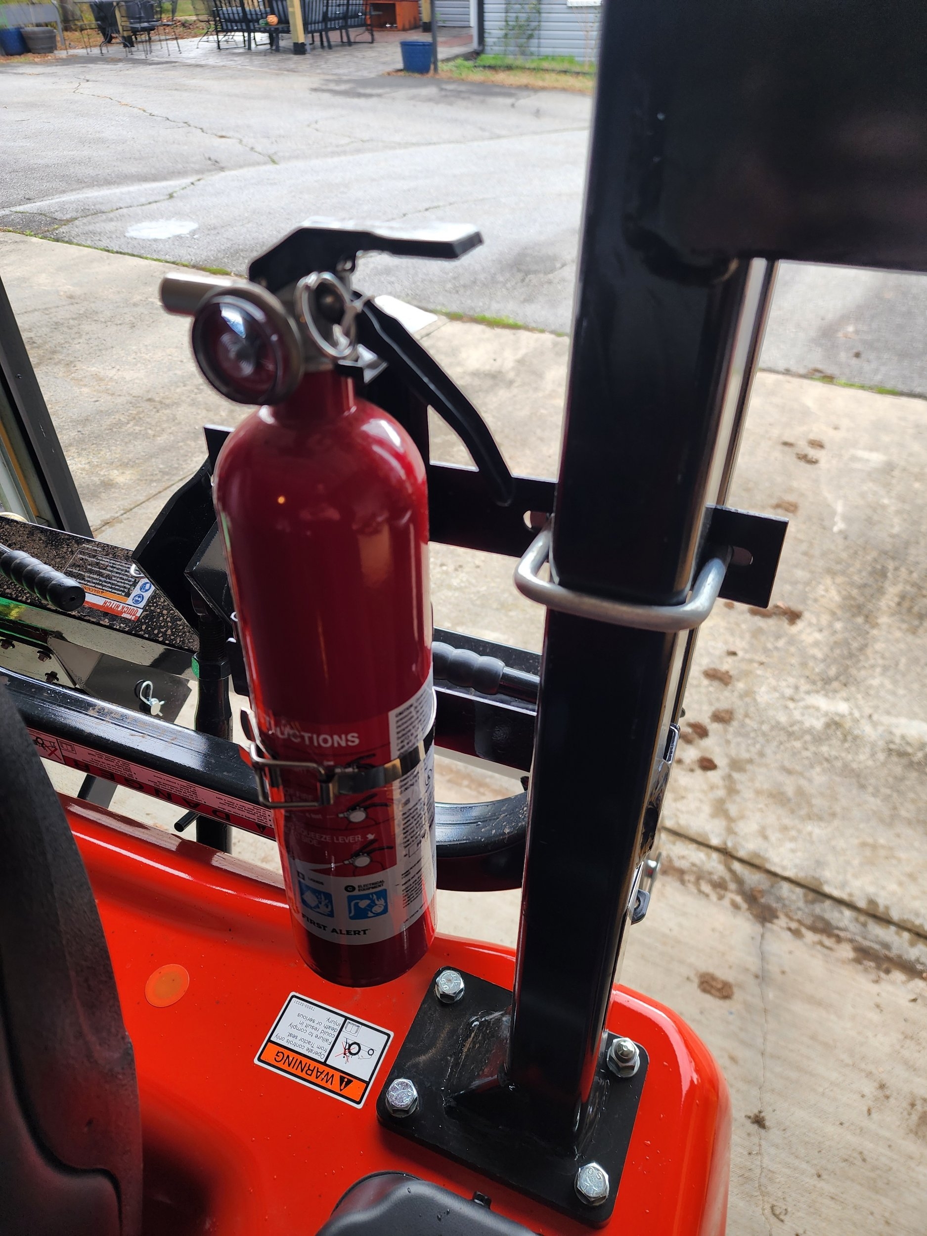

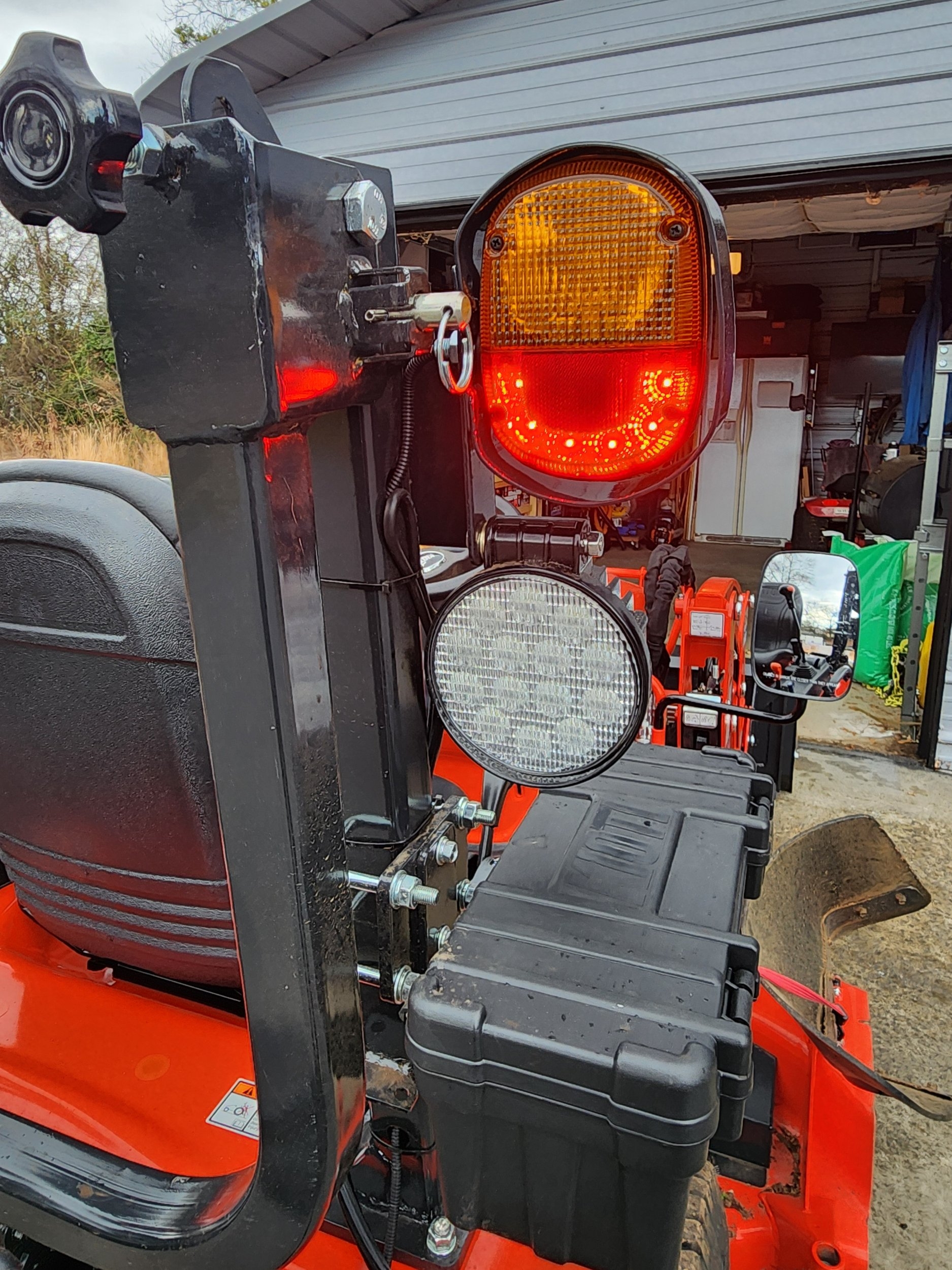

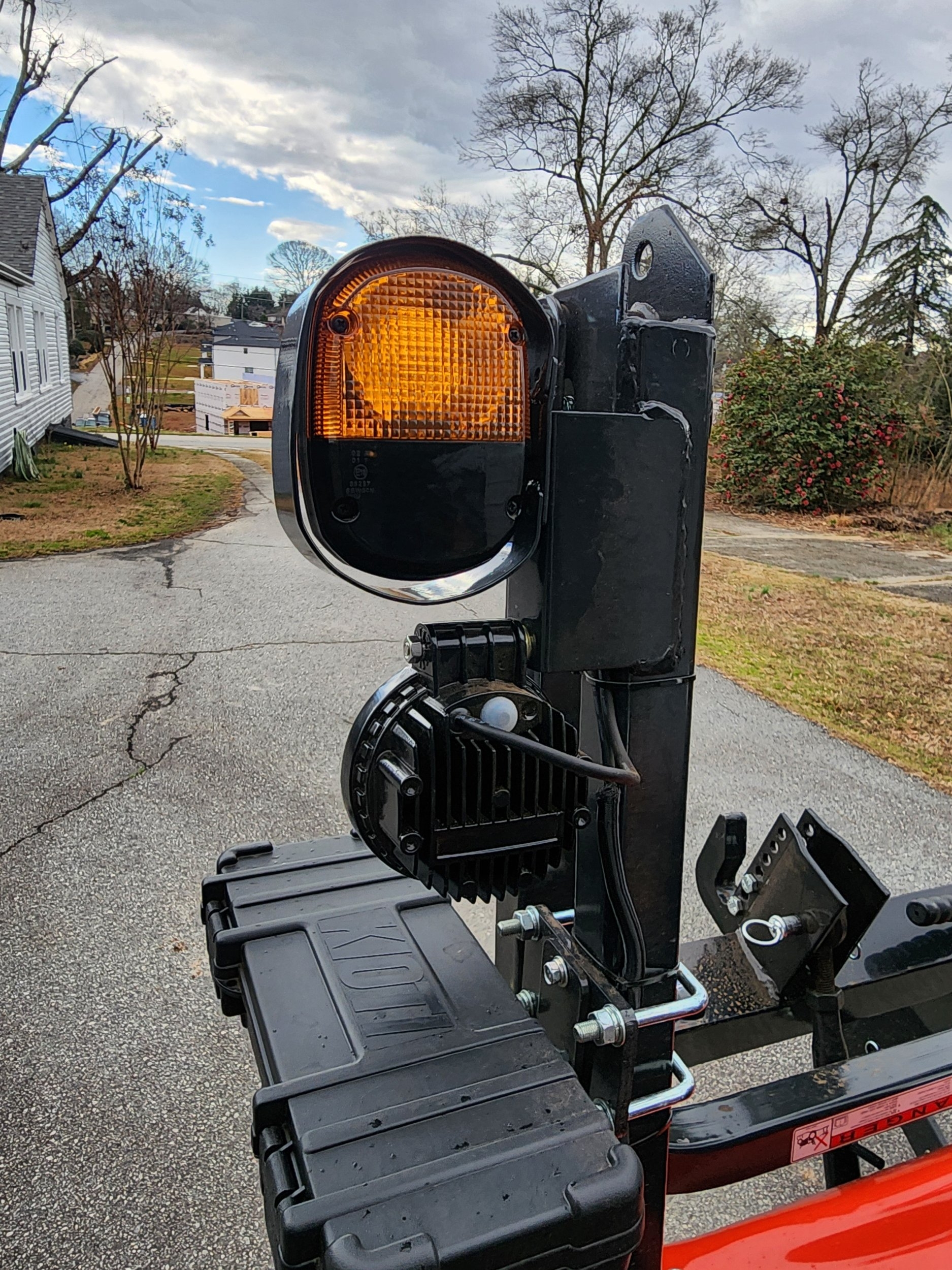

Here is the Superbrightleds.com LED rear worklight. I didn't really like the position of the OEM accessory one, this pivots up out of the way of the toolbox where I have it mounted. Also the OEM light guards and my fire extinguisher mounting.

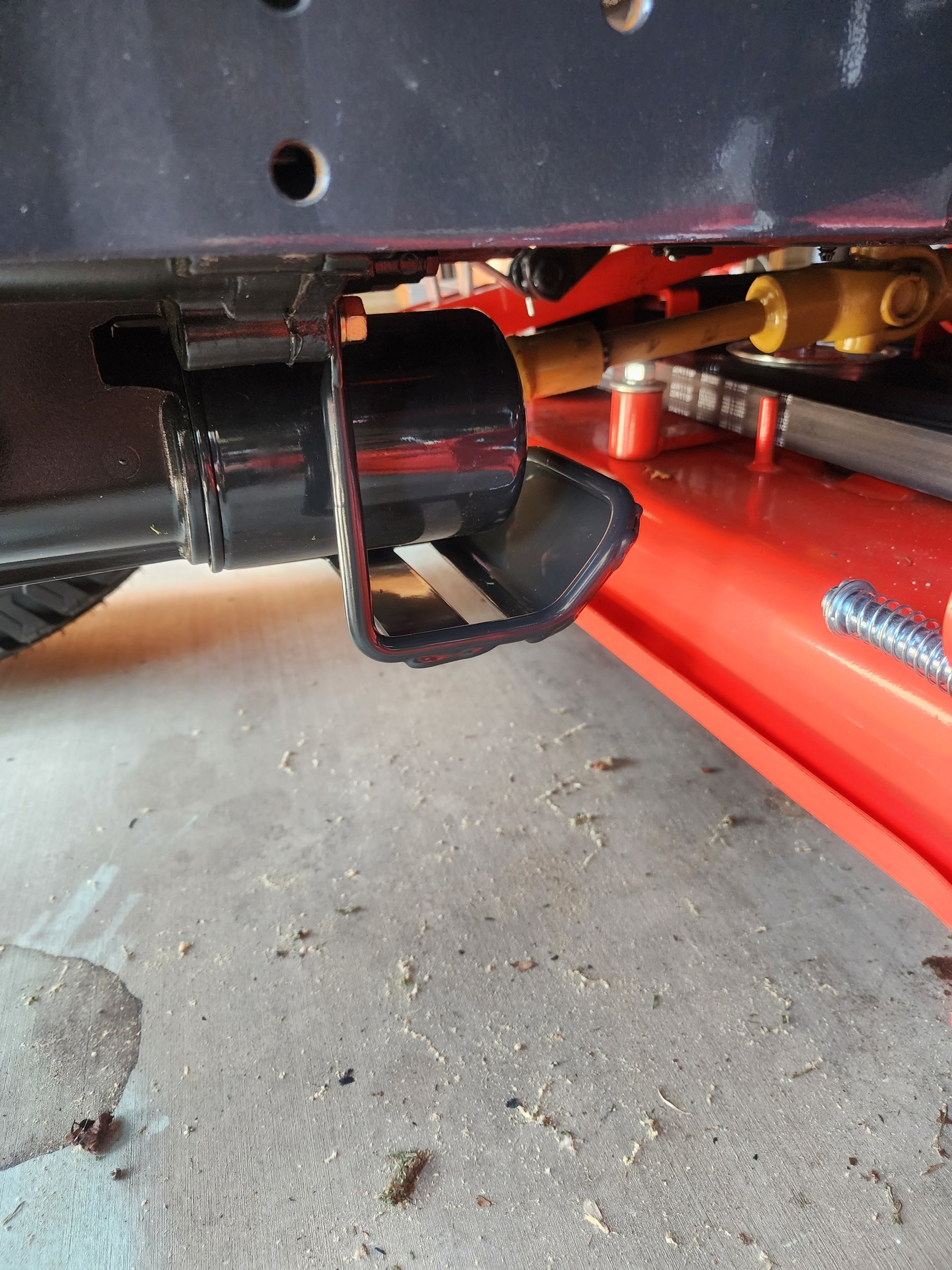

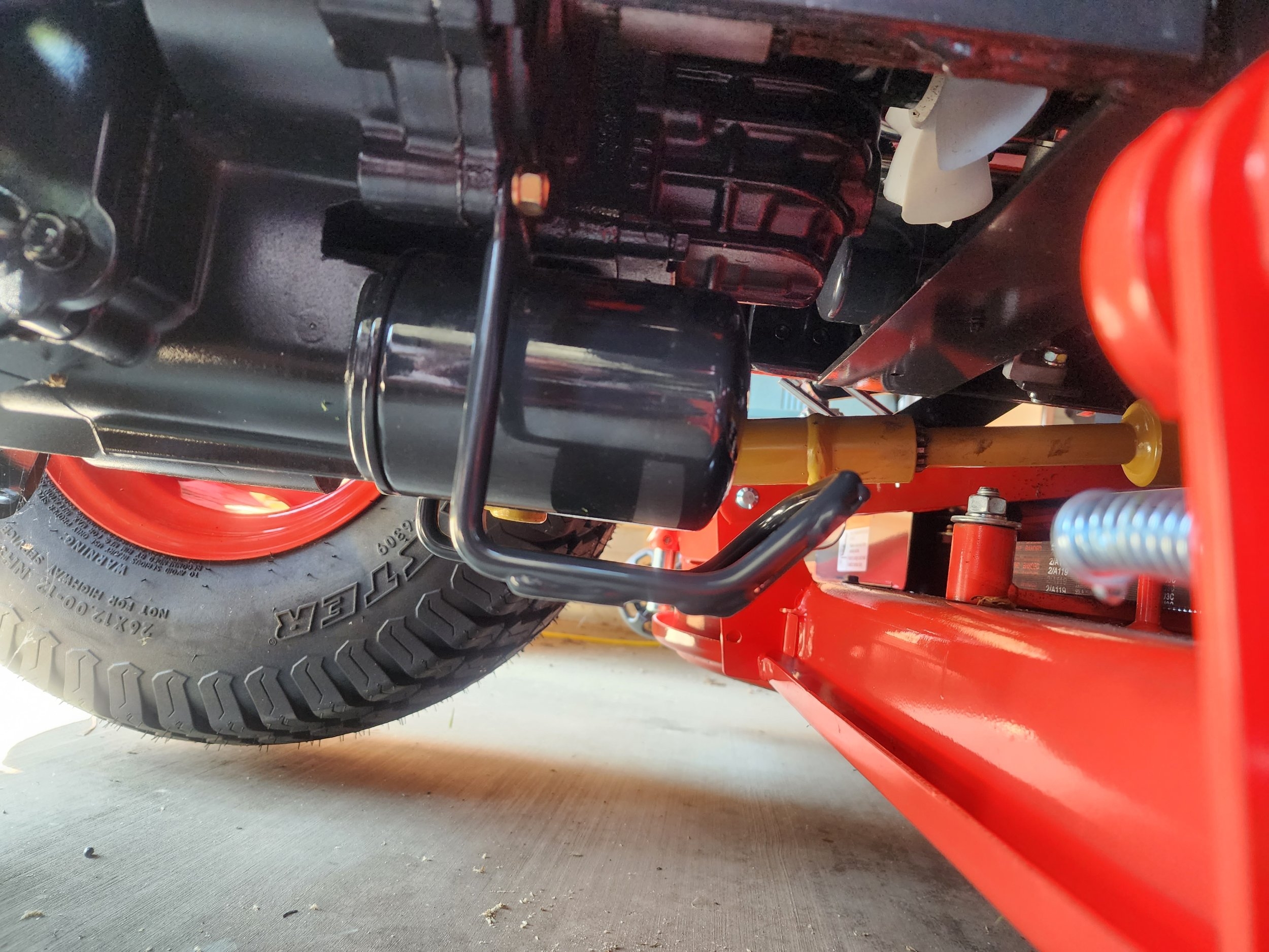

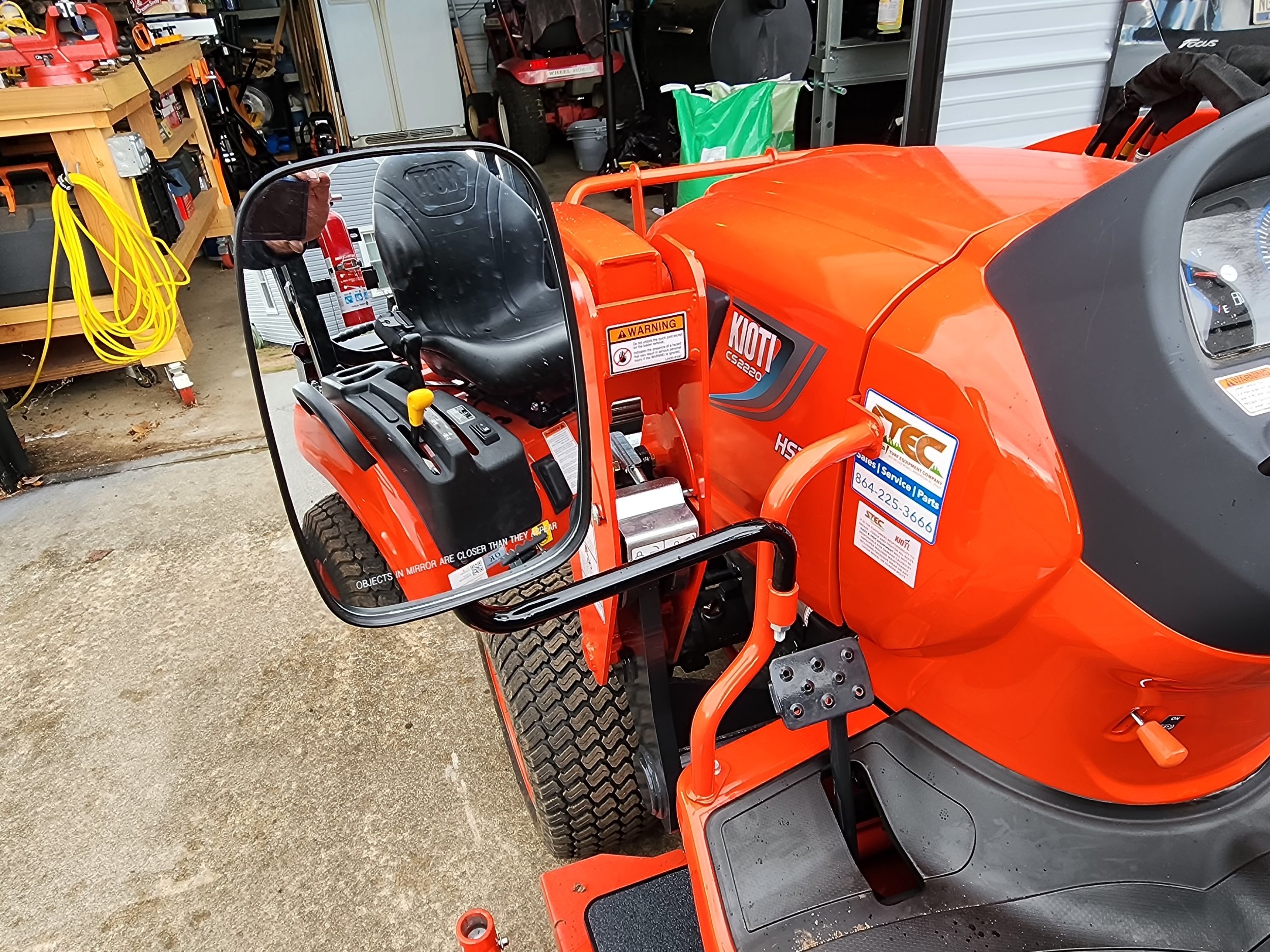

Here are the OEM accessory mirrors and HST filter guard, I just really wanted the orange brackets for more of a guard than anything but I've left the mirrors on for now.

That step would last about 30 seconds for me because I farm with my Kubota's. Far as LED's go, I only buy them from Superbright and both my Kubota's are 100% LED as in everything. I did have to go to an electronic flasher unit on my units however as the LED flasher bulbs don't work well with a resistance flasher unit.

There are 2 pigtails with bullet connectors, one on each side under the fender right at the base of the rops, that have 12v key on power. The right side is direct and the left side can be tied into a switch via the OEM rops forward led light kit. The worklight I have has a waterproof push button switch on the back of it, it took me forever to find a nice led one with a built in switch, the oem one looks to be incandescent and mounts to the rops base so it's real low.

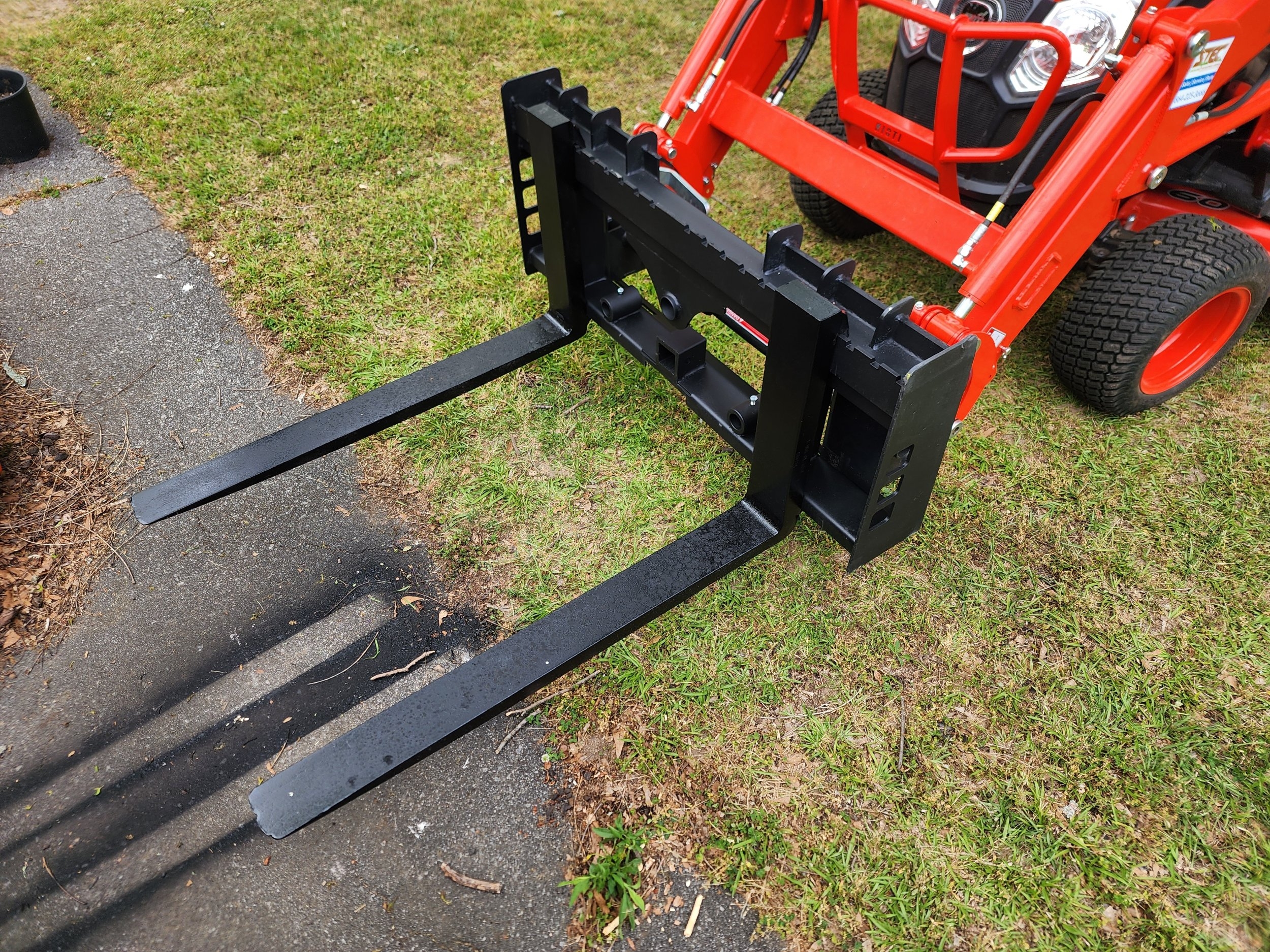

Was gifted some surplus forks from work, so bought the cheapest lightest ssqa fork mount I could find (yitamotor) ~100 lbs
