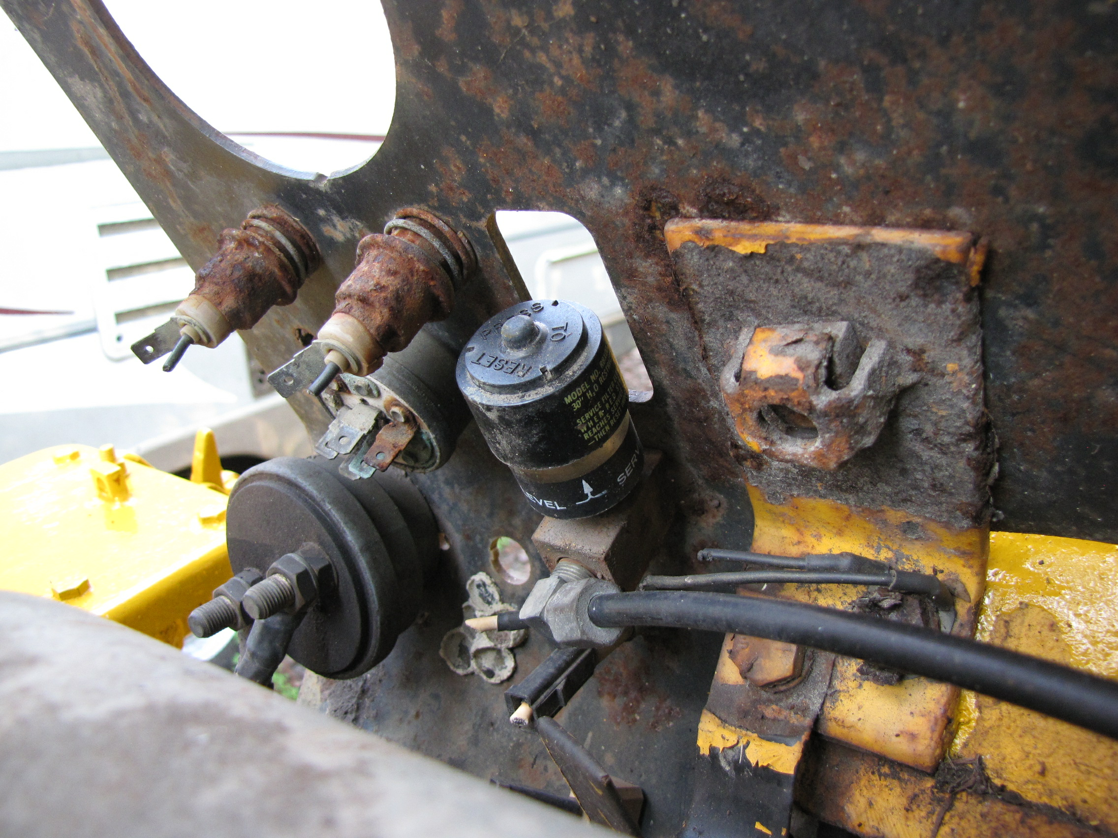

I've attached a few pics.
I have no idea what this is for.
It just says push to reset, and it looks like a hose coming out of it and going under the hood.
I didn't trace it because even if I did find where it goes, I still wouldn't know what it does.
Any info would be greatly appreciated

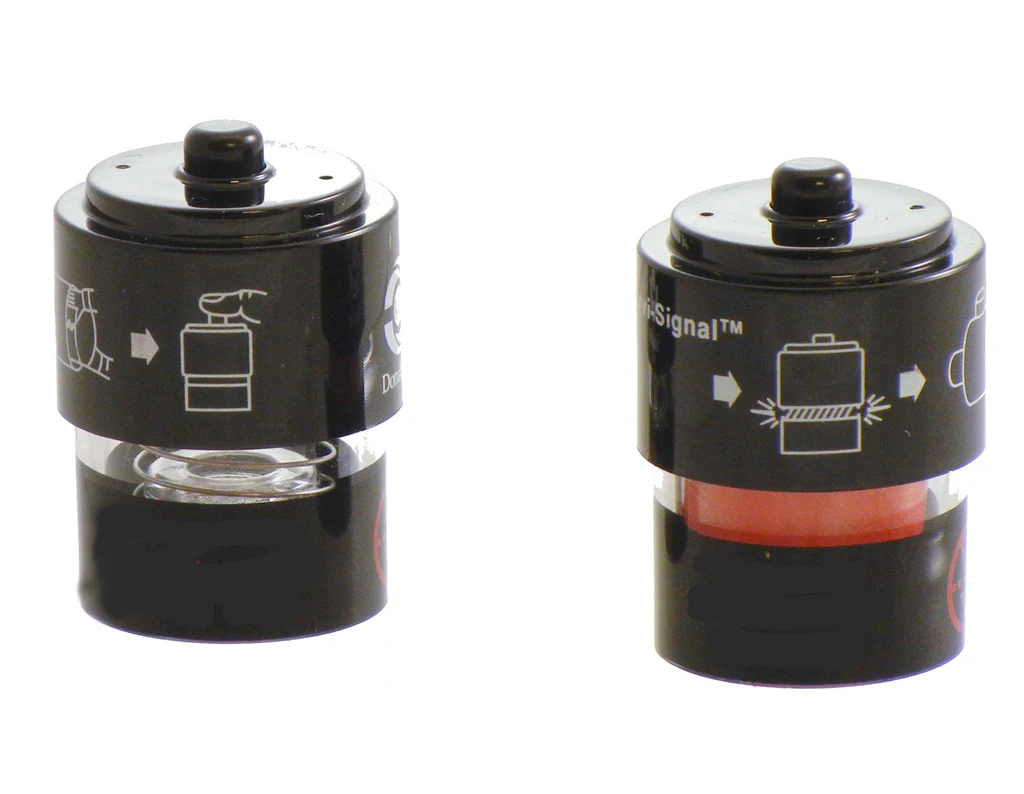

That's the air filter restriction indicator.
Once the air filter is clogged enough, it will trip that little indicator to warn you to clean or replace the air filter. It will show a ring on that clear section of it, probably red or yellow or similar. Once the air filter is either clean or replaced, you push to reset the indicator.
EDIT: As they say, a picture is worth a 1000 words. This should make more sense:

ptsg, Thanks soooo much. I would never have figured that out.
