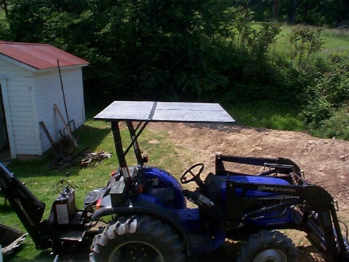

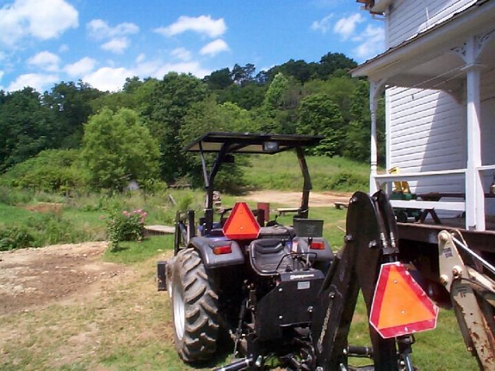

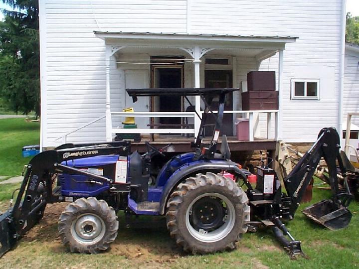

Just wanted to post a few pics of the canopy with front and rear work lights I just made for my machine.
Here is one from the front.

I originally intended to build a full cab, but after thinking about it I decided on a canopy. I was going to make it a bolt on, but after a considerable amount of time spent trying to figure out an easy way, I decided just to weld it on to my rollbar. I guess you could call it quick detach as there are just 2 pins and 2 anti-vibration screws holding the rollbar on. The barn where I store my tractor has high enough door/ceiling that I have plenty of overhead room so I don't need to worry about removing it.

Harv, I had some 22 gauge sheet metal left over from rebuilding the rear fenders on my wife's cousin's Samuri. I ended up using 1 piece widthwise, and 2 pieces longways, as you can see the bright T on the top down pic. I used some aluminum tape to seal the joints until I have time for something permanant.

Thanks. After working moving dirt to fill in the pond the last tenant left us, I had to stop after an hour to cool off. This motivated me to go from the "would be cool to make one" stage to the "lets get this done" stage in my process of making stuff. The added incentive has mounting some work lights, as my headlights are next to worthless with the FEL, and the rear work light was mounted low and was blocked while doing backhoe work.

You might consider making your lights quick detach. Let's say you put some studs out board of the canopy up front and back. Then you use some good wing nuts, a couple of bars holding a light each and you have water resistant connectors.
That way you can have your lights when you need them and not when you don't. If you do it right you can have them adjustable so you can lights of to one side or the other or one back one front. The only limits would be your imagination.

Actually, I was thinking of adding a spotlight like I have on my quad. It sets in a swivel base and has a coil type cord on it so you can detach it from the base and use it like a flashlight.
