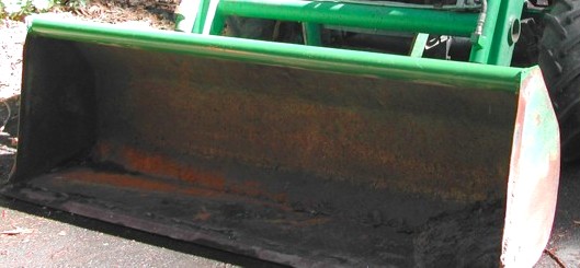

Here is another JD standard bkt, just before I put on a new cutting
edge and sched 40 pipe to replace the top lip. I also had to replace the
1/8" plate on the bottom as the heel was warn thru. At least the 1/8"
sides have a dimple pressed into it at the factory to make it a little stiffer.
The 400cx standard bkt did not even have the dimple. The AFTER photo
is also shown.
As for my CK30 bkt, I re-weighed it and it is now up to 186#, due to the
addition of a chain slot and reinforcement plate on the back center.

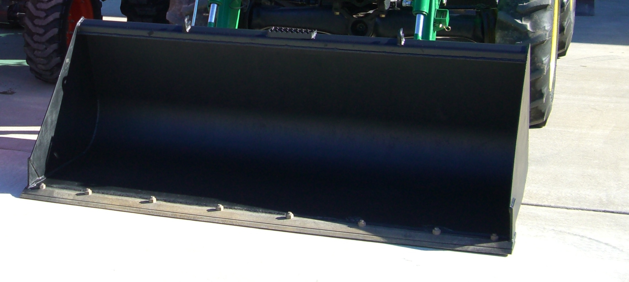

   / My bucket sucks! #28
KennedyDiesel said:
Here's a pic
I don't know if I'm not seeing them or if your bucket doesn't have the bolts protruding up into the bucket where the cutting edge bolts on. That's about my only complaint about my HD Worksite bucket. When working with somewhat wet dirt, the bolts are where the dirt starts to stick in the bucket. Here is a picture of just the bucket so you can see the bolts I'm talking about. There's not much I can do about them and, fortunately, they don't cause as much of a problem as I thought.

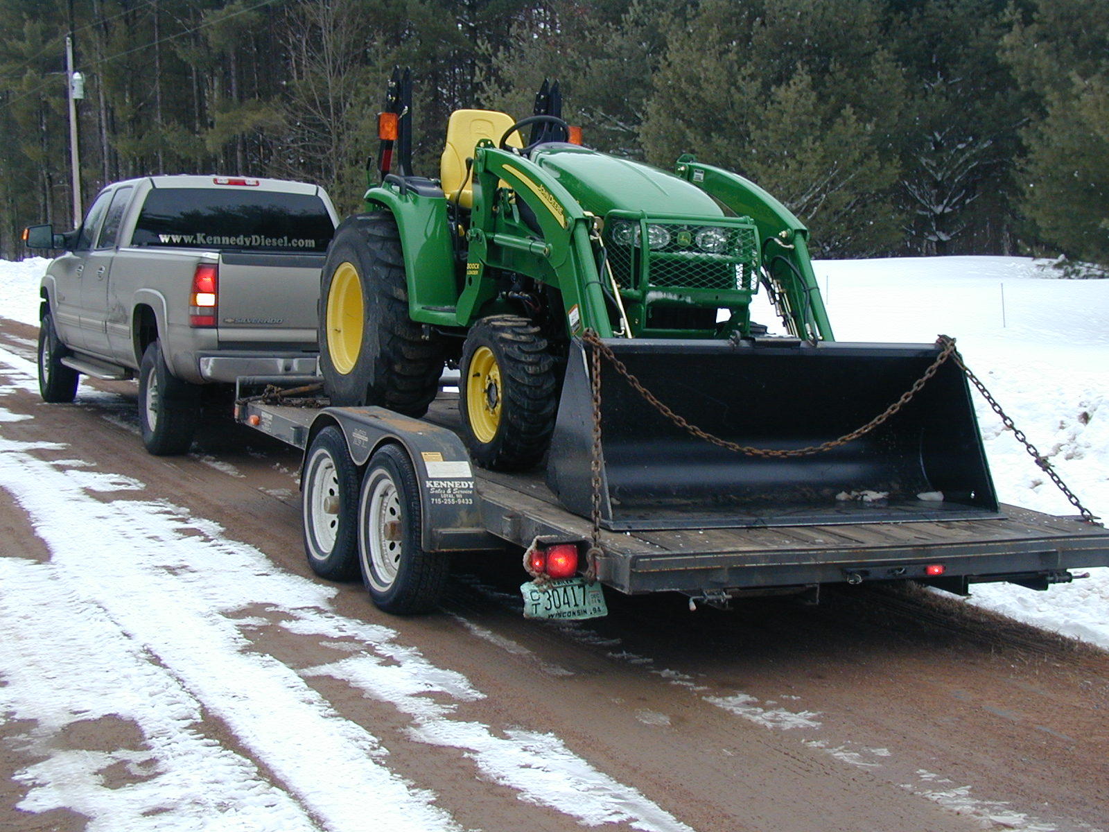

   / My bucket sucks! #29
Mine does not have a bolt on edge. The edge is plenty thick enough that I figure if I wear it out I can either scrap the bucket or weld in a new one. I haven't really put much wear on it that I can see and I'm not afraid to use it.
Is that the green bucket painted black? My bucket has a full reinforcing strip from top top bottom along the leading edge of the side plates. Much heavier than what you show
Worksite Pro # KV11636
http://www.deere.com/en_US/cfd/cons...kidsteer_attachments/media/pdfs/DKABKTCWP.pdf
   / My bucket sucks! #30
Mine is the 84" Heavy Duty Utility bucket weighing 563 pounds listed right in the link you show. If yours is "much heavier" than that, you are seriously cutting down your lifting capacity on your tractor. My tractor is considerably larger than your tractor and that bucket is actually a bit big on my tractor.
Yours is the 66" Foundry bucket weighing 394 pounds and holds just over half as much material in a heaping load as the 84" HD Utility bucket. If your tractor is still under warranty I'd be careful about letting the dealer see those hooks on the outer edge of your bucket if you have a bent loader arm or damaged loader cylinder. I know for a fact my JD dealer will void the warranty for that if the loader is bent or a cylinder broken. I've relocated several to be in line with the lift arms as to not put undue force on a loader arm.
