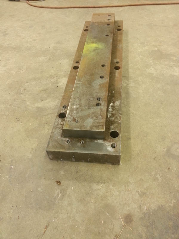

This is one of the plates. It weighs 202#, is made out of 2"x8" and is about 27" long. The plate welded on top is 1-1/2" thick. These were originally machine pads that were never used.

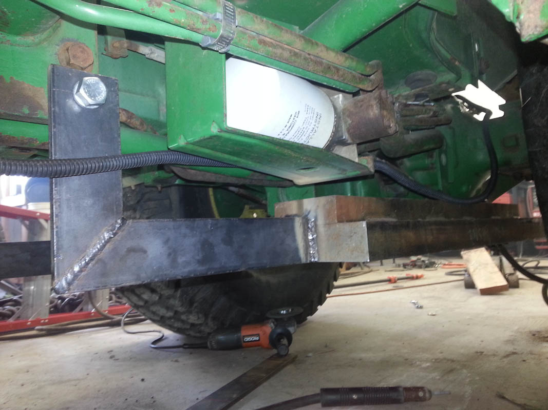

This is the view from the rear, for the brackets I used 2 1/2" x 3/8" flat stock. I used an existing threaded hole in the rear drawbar hanger.

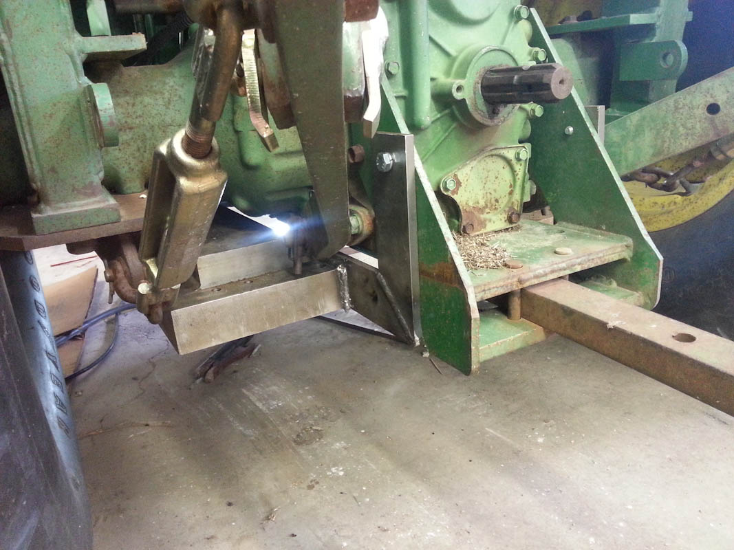

Here is how the front attaches, it mounts to an unused hole that hangs below the loader bracket.

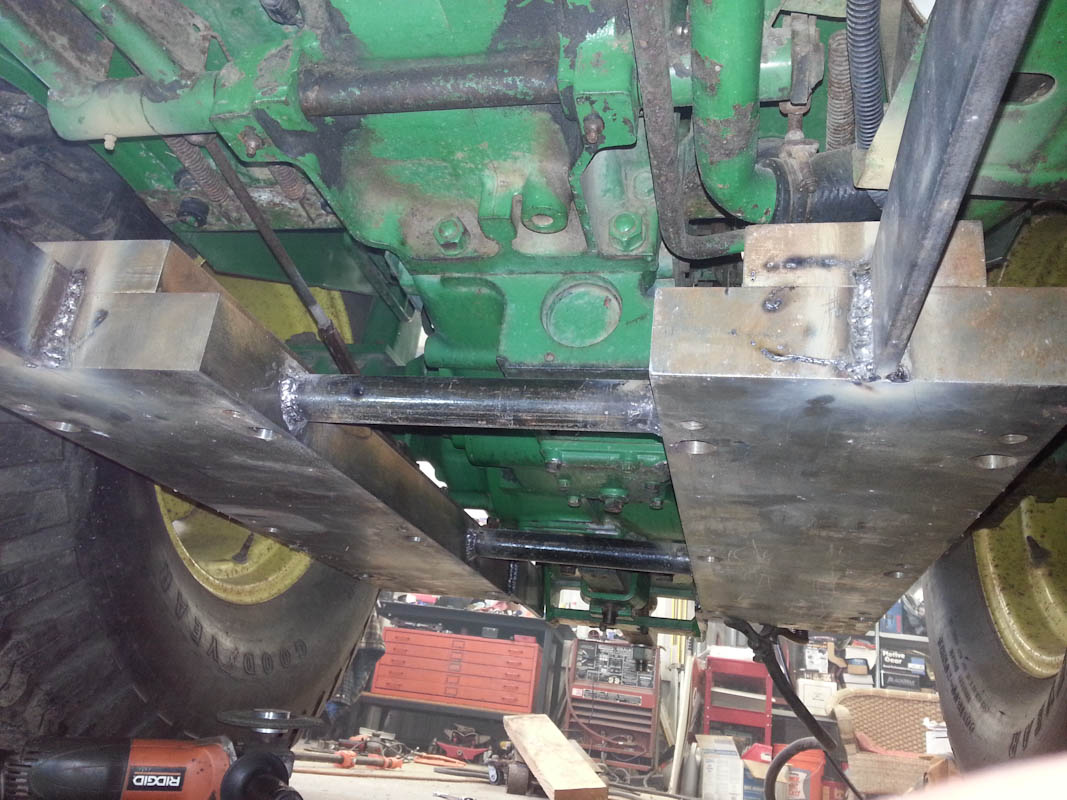

I used 1" schedule 80 pipe between the plates to hold them together, this is how it looks underneath. It doesn't block anything from moving, and also gives me access to the drain plug.

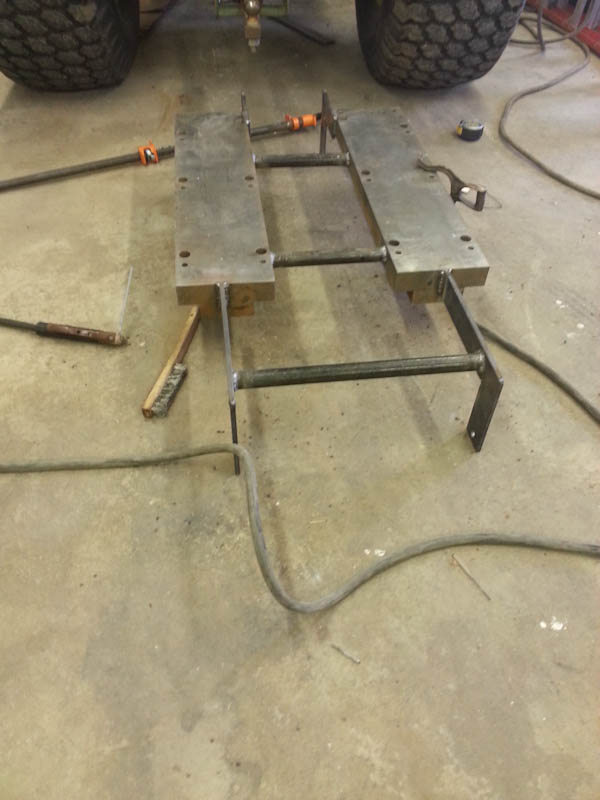

This is the whole thing together off the tractor, flipped upside down to finish a couple welds that I couldn't get to. Now it just needs paint!
You will have to excuse some of the welds, many were done in place as this thing got heavier I got less ambitious about handling it and welded things where they were. The pipes were probably the toughest welds since I was welding relatively thin metal to very thick metal, all while trying to go in a vertical circle. Some of the welds I was able to tack in place then drag it out to finish the welds. There was lot of raising/lowering with the floor jack and repositioning.
