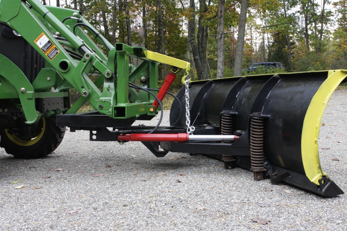

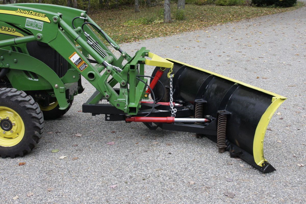

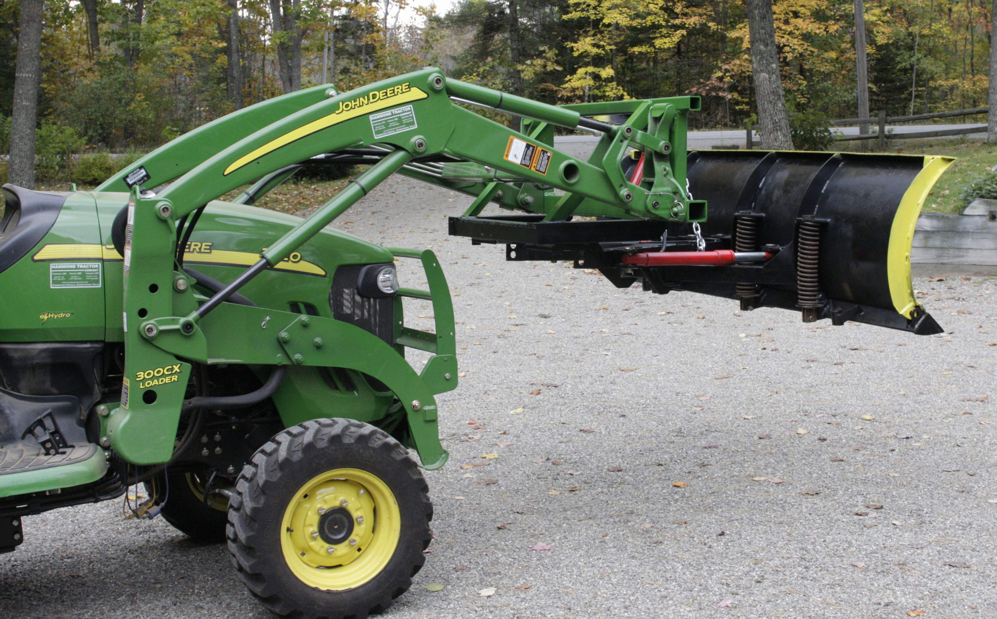

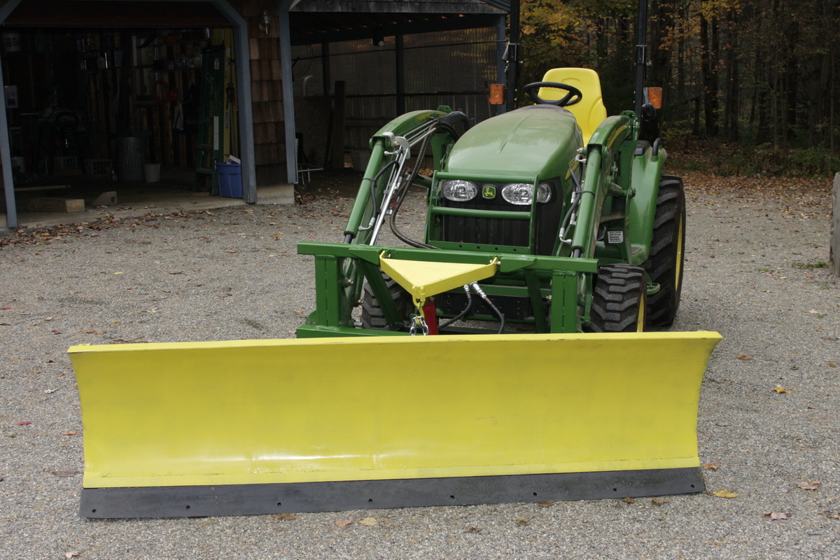

After trading my JD 4010 with front mounted snowblower for my NEW 3320 and then hearing the price of a new front mounted snowblower I came up with this solution. I read every thread concerning the FEL plow debate and worked with Northernmainer's design and came up with this. The beauty of it is that you don't use the FEL float. The only weight on the ground is the weight of the plow. It is hooked up exactly like a PU truck. You can see more picks by pointing your browser at FotoPlayer.

Looks very ingenious to me. Nice piece of engineering. What sort of plumbing is needed to run everything?
   / My answer to the FEL snow plow debate
I am using the power beyond function to angle the plow

Looks like it is very well done. I like how you mounted it with the brace running up from the back.
It appears like you are not actually lifting it with the lift cylinder. If that is correct I ask why you went to all of the work to mount the lift cylinder and triangle?
Fisher plows are made here in Maine and since all the head gear came with the used plow, I decided to keep the Fisher look. It's just a fun thing. The lift cylinder is just for looks.

So you added an extra valve? The Power Beyond alone will not control the plow...or did you mean to say you are using the 3rd SCV (rear remote)?

I bad, I should have said that I am using the rear remote to angle the plow. I still have full control over the FEL height and angle.
