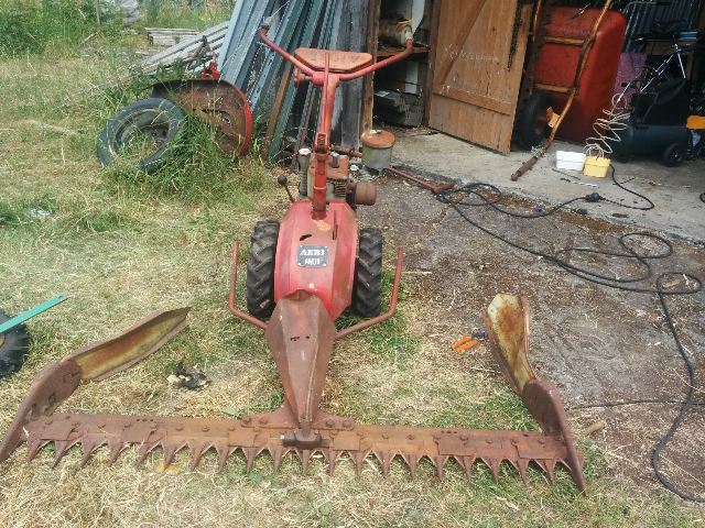

Its special the moment when you hear the first sign of life in an old engine when you pull or switches the key, it might still be a long way to go before its 100% but still its special.
I had a test run with no functional clutch and had to try to cut some grass, the women in the house just cant get the joy or point of this...
The plan is to make it a 100% working machine, so I suppose I have to rip it apart and change all seals, better to do it now and doing a proper job when its still a project or wait until I have use for it and its old news.

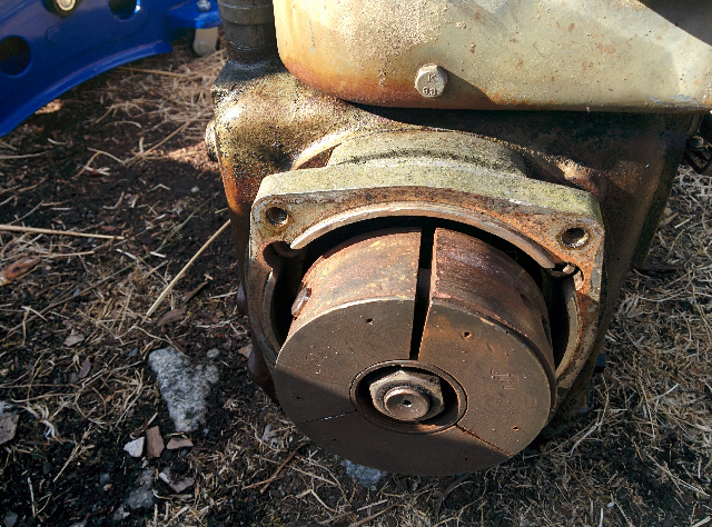

Thats plan B if my clutch on the old engine fails. Now I'm searching for a puller to get the clutch of the shaft.

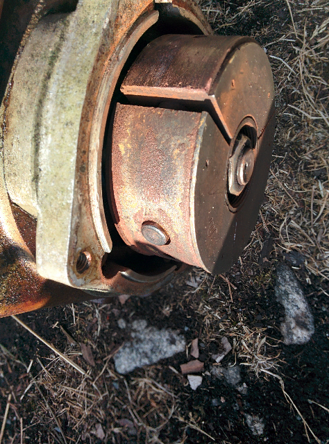

This clutch looks better:

Might be able to weld it, but I think I'm going to rebuild the newest clutch disk.

#29
It cost 200$ to rebuild the clutch with new linings.

Did manage to get the clutch off the parts engine without the right puller.
Tomorrow I must try to weld it.
Trying to use a puller on my new engine but no
