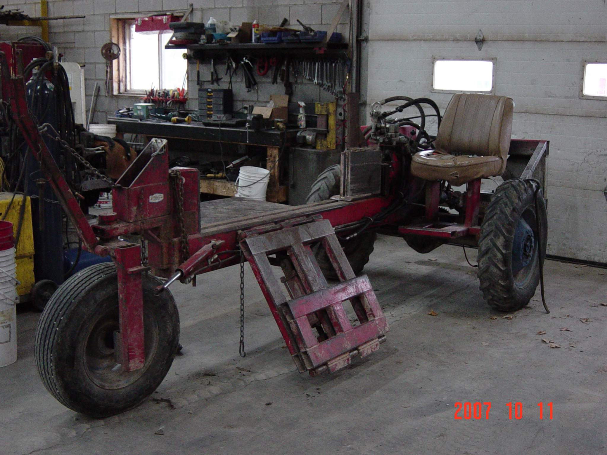

Nice touches.
I welded on my log cradle/rest/stop ... and my lift will be non-swappable, side to side.
I was thinking though, since your log cradle/rest/stop is removable, it would be nice if it were adjustable (in/out) to accommodate the occasional huge round.
Just a thought.
Not a bad idea... Maybe some sort of hinge to adjust it from flat to angled.
Mike... any plans to add a gusset to beef up front to back pull on the real axle? Looks like you have the side to side built very stout.
I've got a lot of rough to very rough terrain that are hard on spring and axle mounts.
I haven't done anything yet but will add some braces.

I want to see the log lift go on.
   / My 3rd and hopefully last log splitter #68
With the log splitters I see there seems to be two major design routes. I wonder if we can talk about that.
Design #1. The splitter can be set vertically or horizontally. This is the way I made mine. I find myself using it vertically more than horizontal. I am given a lot of wood that other people don't want to mess with, because it's huge. No way could I lift it up on a horizontal only splitter.
But I see in his design he is making a log lift. So;
Design #2. Horizontal only. What is the advantage of horizontal only logsplitters? One major change is the wedge is stationary. Is there an advantage to this? I can see when you split the wood it's pushed clear and out the end of the splitter. If you need to split it again you might have to go and pick it up off the ground again? Or will the log lift extend out that far or will there be a table out there? Is there an advantage to picking up all your wood(if you don't have a log lift) compared to splitting it with the splitter vertical? When I use my splitter vertical I will usually find a decent round chunk and use it as a chair to sit on while I use the splitter vertically.
He is making his splitter horizontal only, and doing that on purpose, so I was wondering if there was an advantage I was missing.

At the risk of getting flamed for hijacking, I'll respond with my opinions and why I did mine horizontal only.
The combo horizontal/vertical is slightly more difficult to design and build. Gotta make sure the hoses reach in both positions, have a pivot pin and get measurements right so it is stable when vertical. Adds time (and cost) to the process.
But for me that wasnt the reason. Already have a vertical model for big stuff. When using it in horizontal mode, you end up with a pile of wood in the way pretty quickly And have to relocate that pile, or the splitter. Means more handling of the wood.
With my horizontal only, I do have a table off the end. So anything that needs split again just gets slid back around, no picking it up off the ground again. The ones that are split to final size just drop off the end out of the way. IT also gives me the ability to back the splitter over the trailer, and all the split pieces land on the trailer without me having to pick them up and toss them in there. So for me, it is about handling the wood less, and spending more time running the splitter instead of moving wood around.
