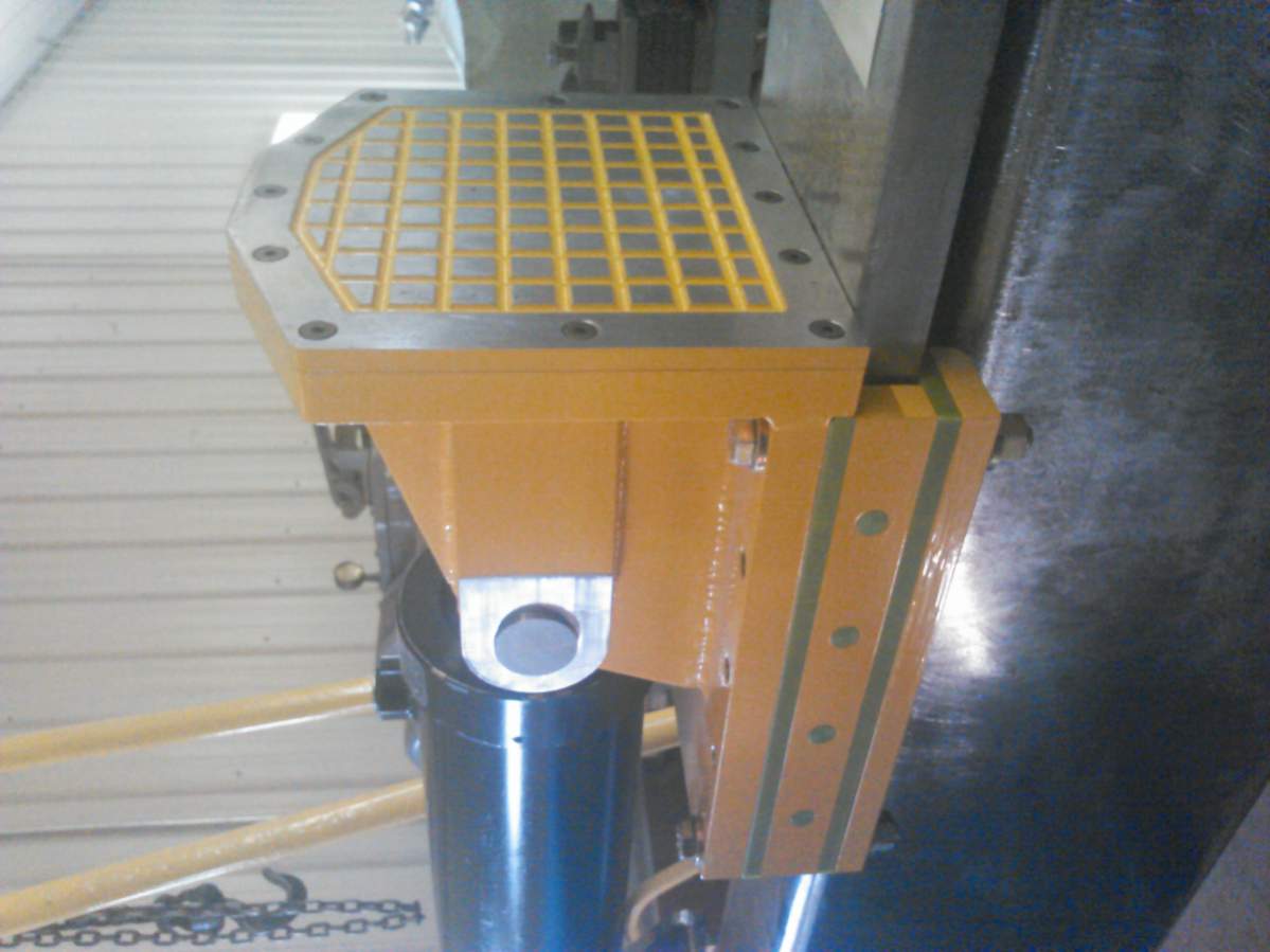

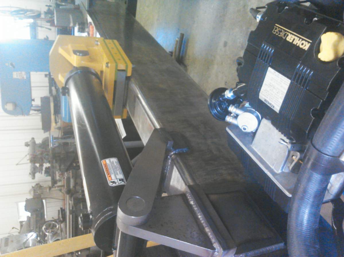

Just about the same.. Just to show you that you are not the only one going that route. Many many advantages using box over I beam.
Glad to see you used that type of cylinder over the tie rod end type.
Keep up the nice job can't wait to see it run..
Very impressive!
On my old northern tool and my friends Iron and Oak splitter the connection between the cylinder and the push plate broke. Repeatedly.
