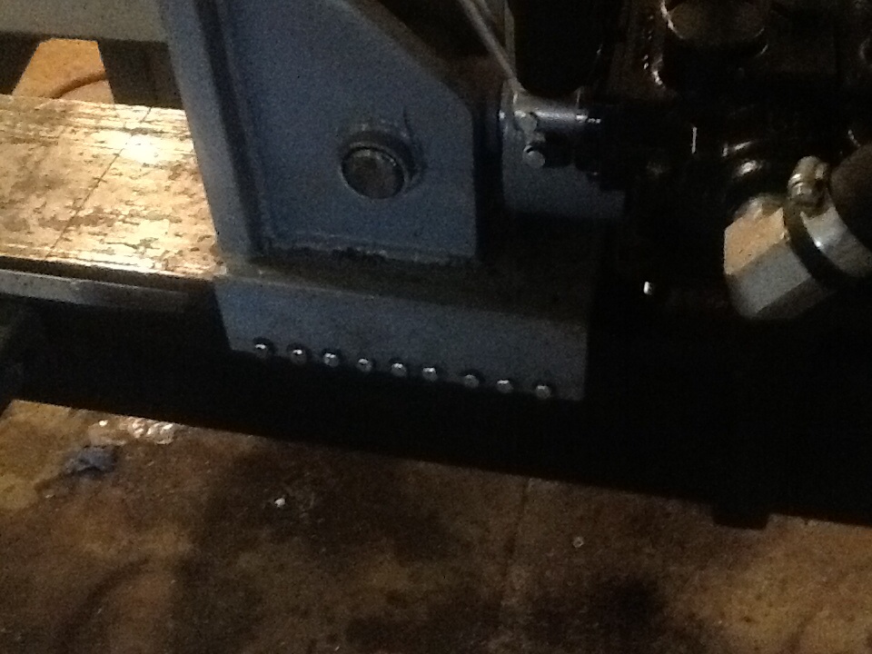

I got it back together. I ended up using two 3/8 grade 8 bolts on the front of each side as those are the ones that take the punishment when a log slides up the push plate. And 5/16 grade 2 for the rest.
I split about a cord and a few tough pieces without any failures :)
Just curious: why go with only Grade 2 ? (rather than at least Grade 5, if not Grade 8)
   / My 3rd and hopefully last log splitter
#122
The short answer...The hardware store didn't have enough grade 8 in stock.
But I think what happened was the front of the slide was pushed up and put all the pressure on the first two bolts which failed and then the others failed progressively.
So I put the two 3/8 grade 8 where I previously had one 1/4" grade 8. The chart I googled shows each 3/8 grade 8 have a ~9500 shear rating and the 5/16 at ~2500. My thinking is the if the first 2 don't fail then the next 7 have enough total strength.
I drilled each hole the exact size of the bolt so hopefully they work together... Time will tell.

Hi nice build!!
What about putting some welds on those plates?
You can allways grind them off if you have too.

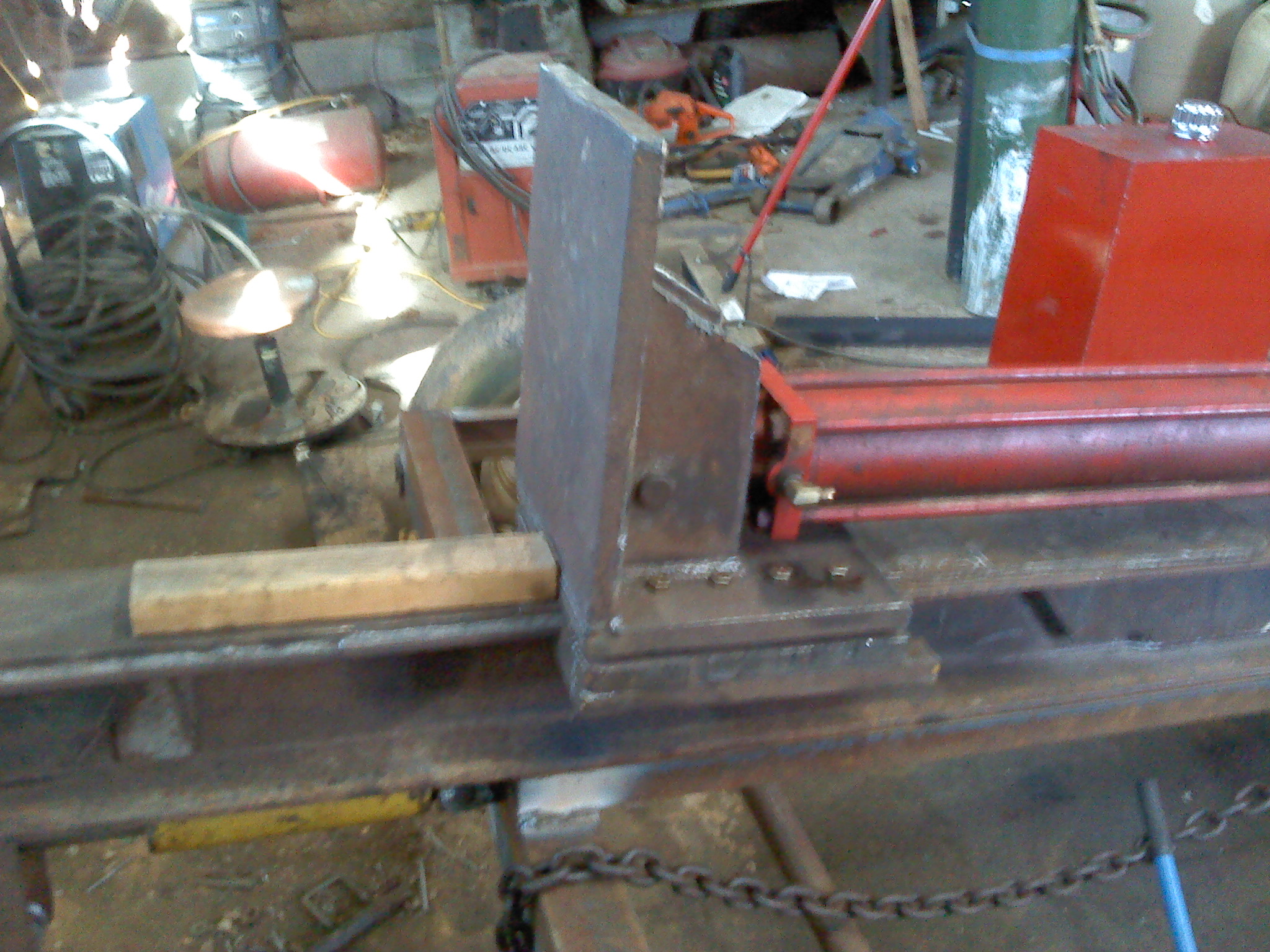

Looked for a pic of my slide, but didnt find one. I used 1/2 grade8 bolts to hold my slide down. 5 or 6 per side. Bolts are verticle so they hold in tension. I can and do stretch those bolts all the time. I have to keep check to make sure they are tight when ever I start splitting. My slide plate is 1in thick and the bottom part that hooks under the hbeam is also 1 in thick. My cyl is 5in and you said yours is 5.5in. I think you might have a continueing problem with your small bolts. 1229111333.jpg Whoops did find a pic. There are 5 bolts each side but pic angle doesnt show the front one

I had to replace the bolts on my slide... went larger and stronger and so far so good...

I think part of my problem with stretching bolts is the height of the pusher block. The pusher is 16in tall and the blade is 24in tall at full extention. Lots of leverage on those bolts. Also have a 6way blade for splitting and regularly split 30+dia oak.
