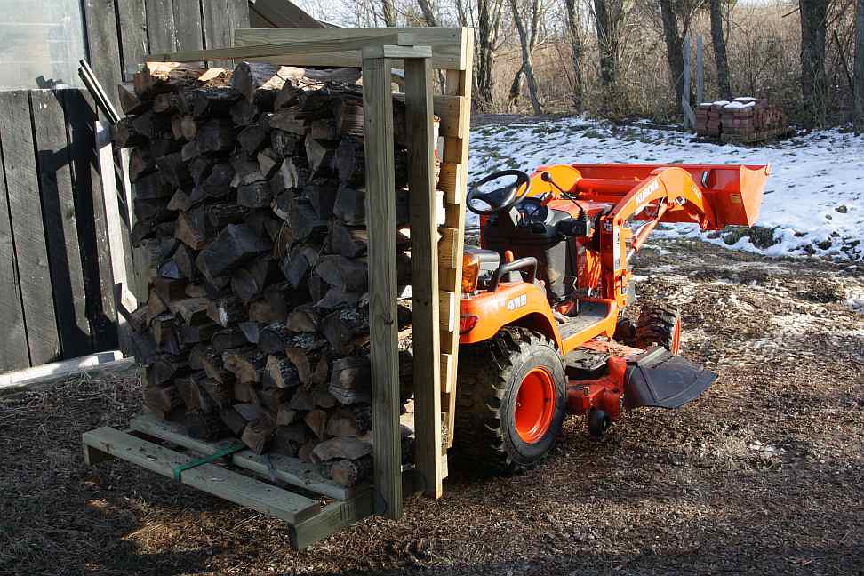

Well, this is what I ended up with. It's made of 1.5", 3/16" wall square tube. 30" forks. I think it's plenty stout.
The firewood rack I made for it needs some tweaking though. It's not totally finished yet but I strapped it on temporarily and did a test run. First thing is that I didn't count on the side to side swaying. I either need to figure out a way to really make the side supports a LOT stouter or change the design to stack the wood the other direction. The stack would be a lot more stable that way, but would be more of a pain to fill as the supports would have to be on the back side and in the way.. Driving really slow was mandatory or I was going to be playing 52 pickup with it like it is. The side supports are just tacked in place but what I had in mind for the permanent solution wasn't going to be much more stable.
Suggestions?

I think what you got there is a 'firewood spreader'.. :D
/ My 3PH Carry All
LOL.. yep true dat. I hope to rectify that situation. :)
/ My 3PH Carry All #4
Haywire,
I built a similar firewood carrier - I'll try to get a picture today. I pick mine up with the loader though - I bolted 2x4's on the bottom of a pallet with spacers that leaves a 2" gap on one side. The bucket lip slides in there and then I can pick the whole thing up with the bucket. I then built a similar frame to yours (about the same height) but I added wire fencing on three sides. So now I can stack firewood two deep (probably almost 2x what you have there). I load it up behind the barn and then set it in the garage until empty.
Works pretty well. So you may want to think about how you can put wire fencing on the sides of your carrier.

I think I have come up with something that will work, and when not in use will come apart with pins and hang flat on the barn wall. It will be not as high, but two stacks deep. It's raining today, and will be cold and snowy tomorrow. Probably won't get to it till next week. Will post pics when I get it finished and all the kinks worked out.

I think you're on the right track - stack the wood in two rows and not as high.
The suggestion of using wire fencing to hold the wood in place also makes sense. Ideally three sides would be fixed and the fourth side removable or hinged for easier loading and un-loading.
Keep us informed of your progress, I'm learning a lot of do's and don'ts on hauling firewood.
My goal is to split the wood, put it on a pallet and then from that point use the tractor and pallet forks to put it in the field for seasoning/drying. When it's time to put it in the shed or burn it, it's just a matter of using the tractor and forks and putting it on the porch next to the door where the stove is located. No putting it in a trailer, stacking, putting it in a trailer again and re-stacking on the porch. Will only need to handle it twice.

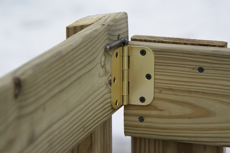

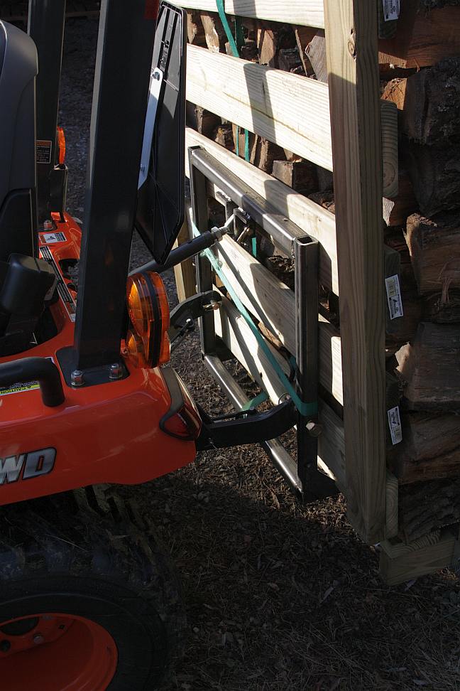

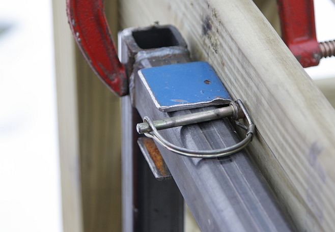

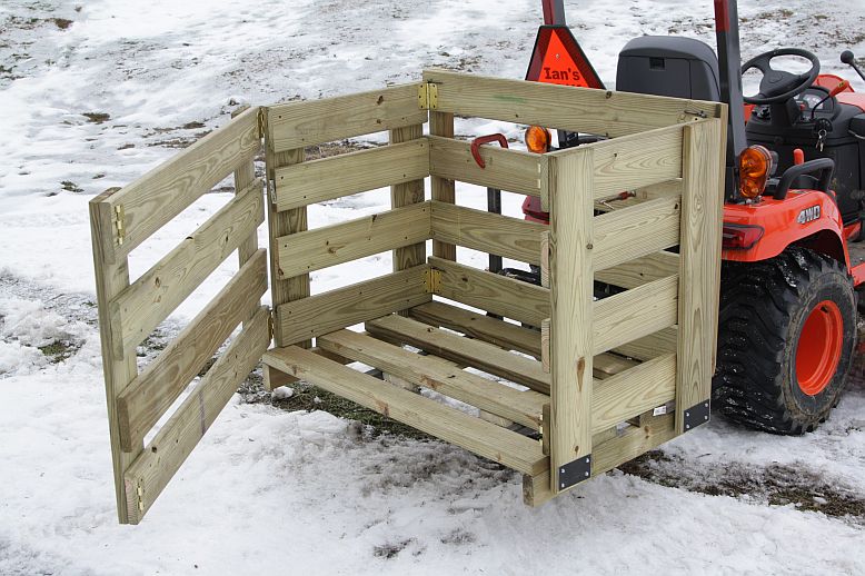

Ok, this is what I ended up with for the firewood rack. It pins together with door hinges so it can come apart and stack flat. The back I rigged so it will swing open. Not the best, but it works. A buddy of mine welded 1/4" rod to the hinge pins so I'd have a handle for removing them but it's not working out, they're too tight and under some bind. It's a PIA to pull them. I think I am going to replace them with some big nails to make them easier to pull.
It doesn't sway all over the place, but it doesn't hold as much wood either. Good tradeoff.
Ian
Oh, pic 2... as soon as I drill the holes, it will pin to the carryall.

Nice job, how many will you be making? Will you store the wood in it or just use it for transport?
You could take the hinge pins and lightly grind them with a fine grinding wheel to allow them to slip in and out more easily.
Another way is to coat the pin with coarse valve lapping compound and put it in a drill chuck and spin it into the hinge. Of course the 1/4" rod would need to be removed first.

It's just for hauling from the wood shed up to the house. I have a rack on the front porch that holds about twice what that carrier does. I usually refill it before it is completely empty, so between that and the bucket, it should be enough for a one trip fill.
I need to find an ol time hardware store that sells nails by weight instead of by the box. A 40d nail would make the perfect hinge pin diameter wise and it's long enough to bend the top 1.5" over for a handle. I need 8. Will never use a whole box of them in 10 years.
