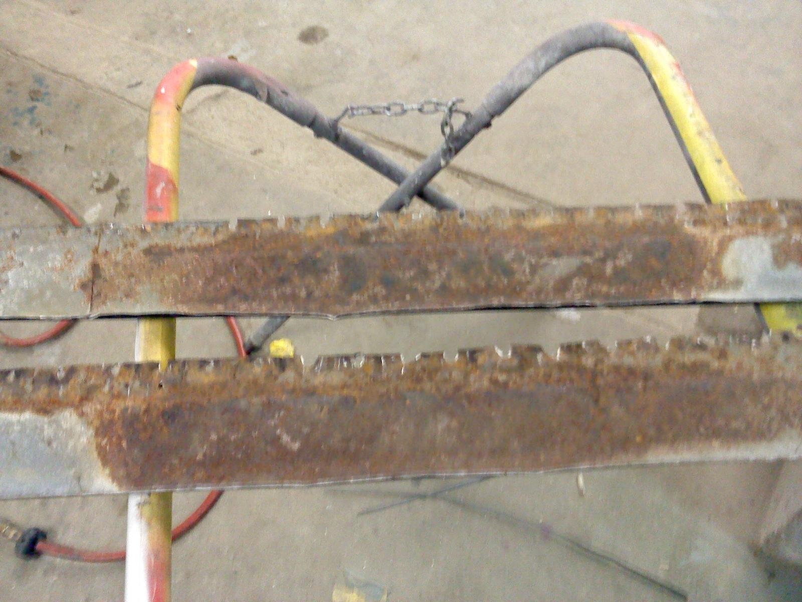

Sorry to hear about your rockers and wheel arches. GM's and Fords rot to. I just had both rockers and cab corners put on my 03 reg cab 2500 Chev. about 2 mo. ago. I paid $2300.00 for the body work , which also included painting the hood, and both sides of the truck, as well as wet sanding and buffing the roof and gate. The rockers and cab corner work alone was $800.00, and that was with me removing the doors, interior, and unbolting the bed and removing the rear bumper and hitch so the shop could just slip the bed back a couple feet to access the cab corners. The $2300 included 37.5 hrs of body labor, for the rockers, cab corners, and additional paint work, as well as all parts and supplies and Tax.
When I was picking mine up, they were just starting on a 04 or older{leaf spring front susp} F350 with rotted rear wheel arches. It can be astonishing what is hiding behind the sheet metal. My cab corners had rust blisters and were obviosly bad, but the rockers only had a couple of little chips to bare metal showing what I passed off as rock chips. The shop, which came highly recomended strongly suggested that I pony up and do rockers to, as normaly those little chips are actualy caused by the panel rotting from the inside out. I could not beleive what the inside of the rockers looked like when they cut them off. Here is a pic. The shop saved my old sheetmetal to show customers how nice a panel can look on the outside and what could be behind it.
