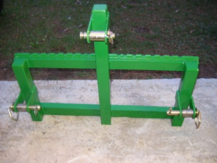

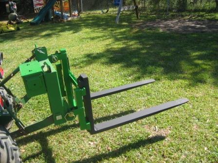

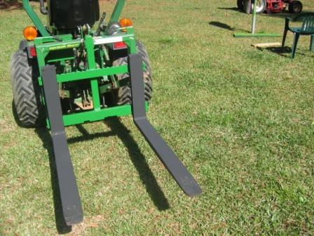

I started with a forklift mast, which was cut down to help cut some weight. I used the track torch at my tech school to slice the 1.25" mast. The I-match bushing were also made at school on the lathe.

Another view.

Mast alone.

Hey, that's neat. /forums/images/graemlins/cool.gif I like the adjustability of the forks. Most set-ups don't have that.
Where did you get the mast?
   / My 3-point forklift.
I got the forks and mast at a local place that services forklifts. That mast was just to massive for my application so I cut it down.
