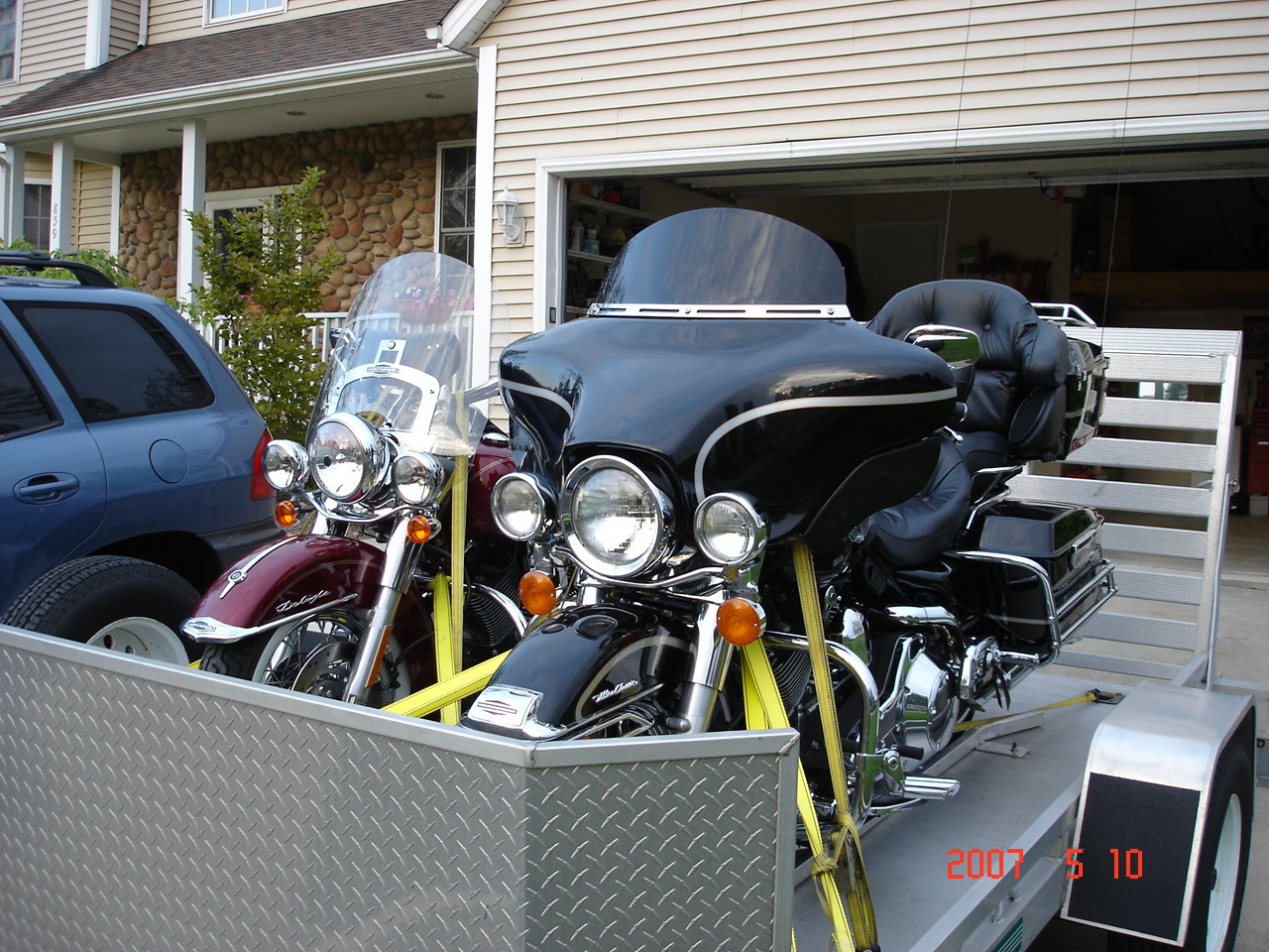

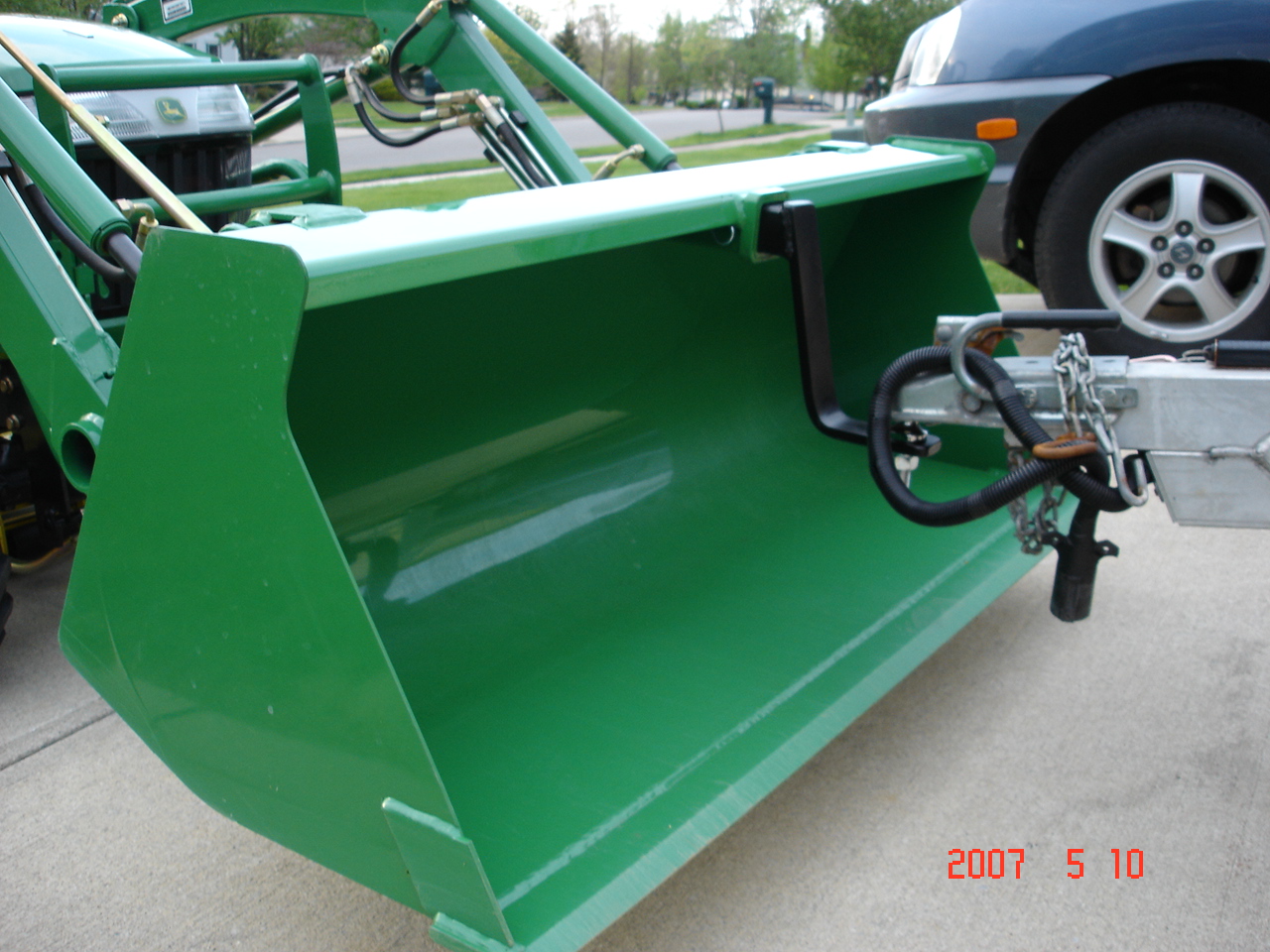

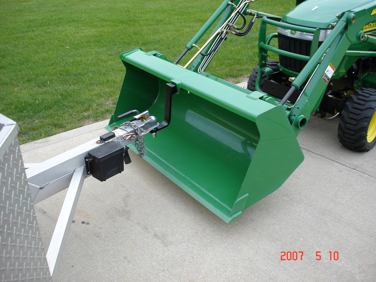

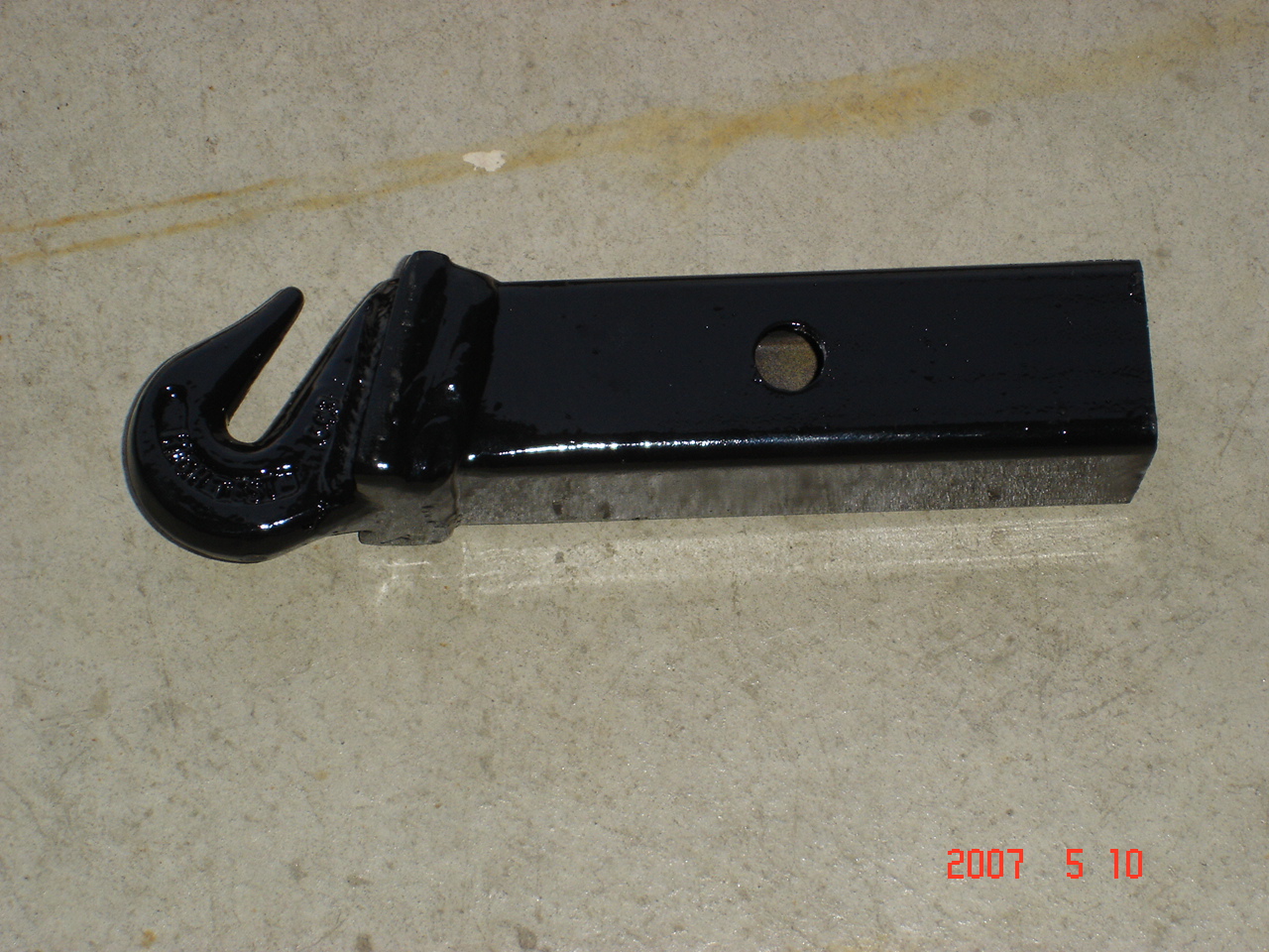

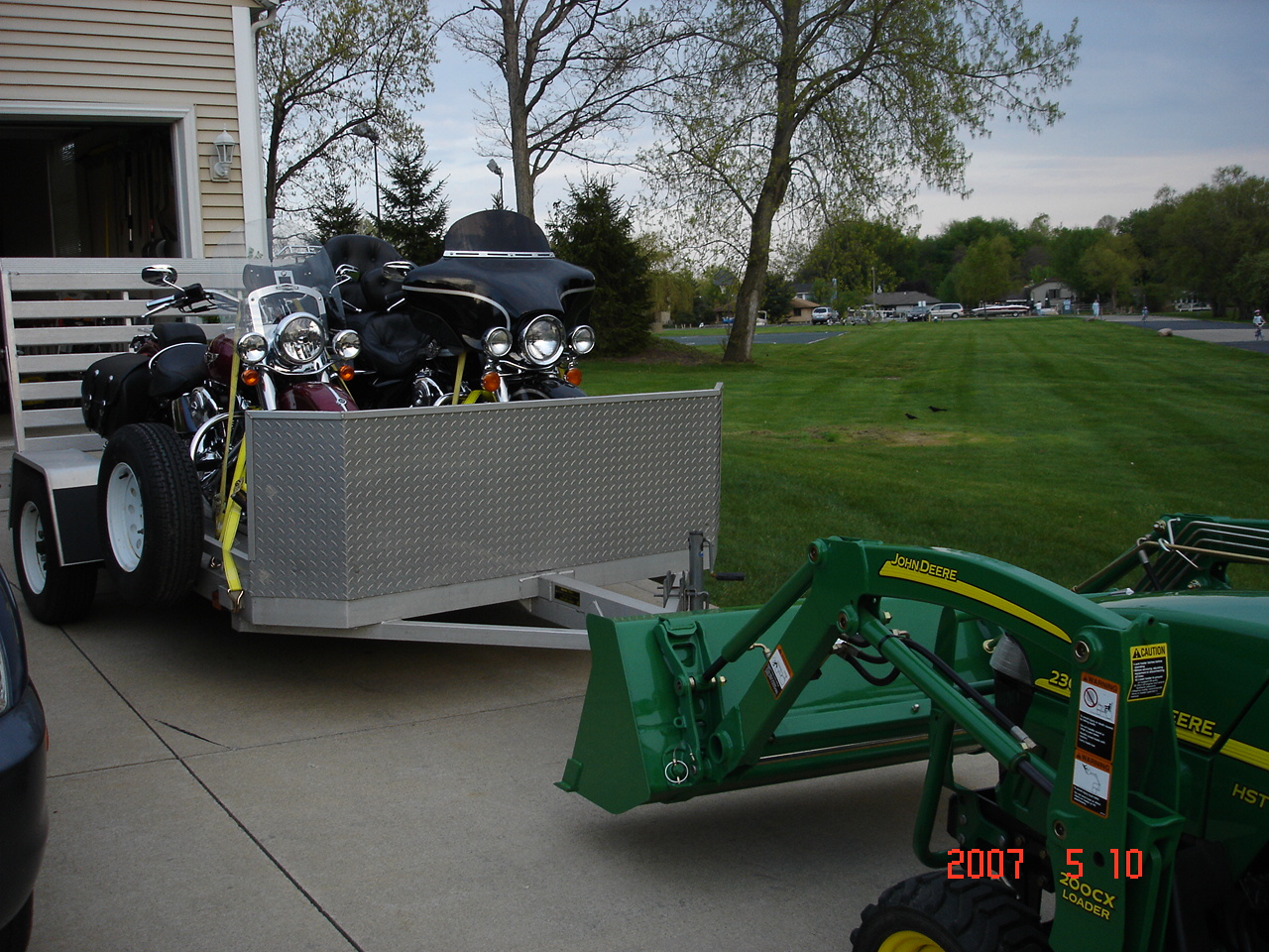

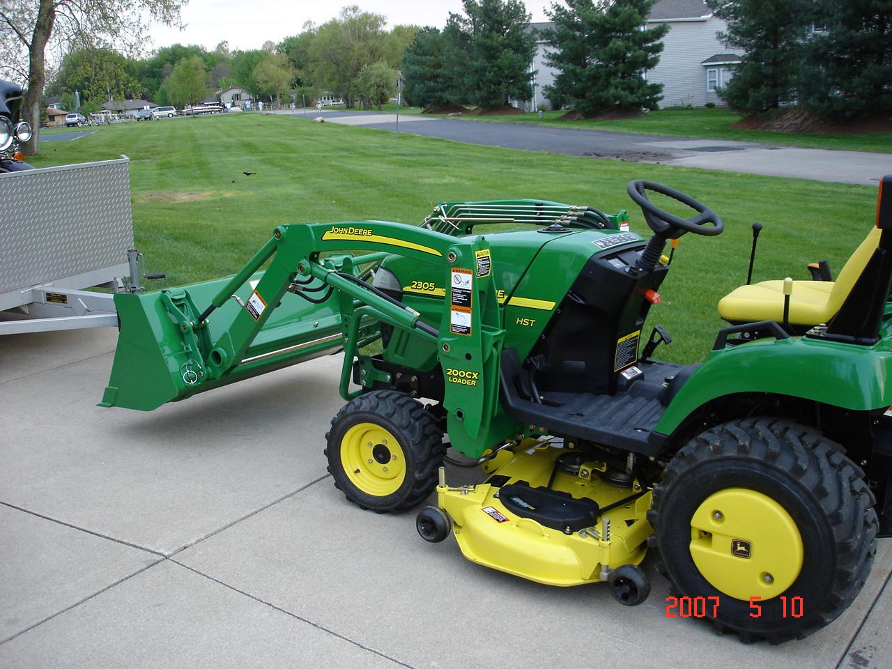

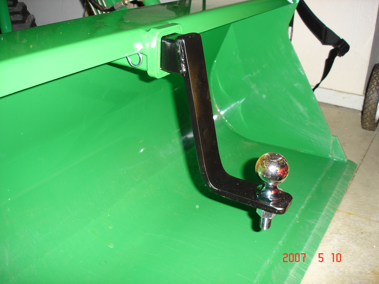

Here's what my brother and I added to my bucket to move the trailer around. We also made the drop hitch and the hook out of some scrap we had laying around. If I have any kind of bending on the top of the bucket I will stiffen it up underneath. We just did not want to add the weight if it was not needed. I added a few of the bikes too, checking to see how this set up will work for a road trip later in the summer out west. Enjoy the pictures I know I do when others post them and thanks for all the great ideas on TBN.

Real nice work !! Moving a trailer loaded with nice bikes, makes you not want to blink :)

Stuarth , That was a very nice job. very clean looking.:)
I see you made one of the recievers with the hook.
moveing trailers will be fine. but if you do decide to lift something heavy
two 1/4 inch gussets from the back of the bucket to the top edge would bearly add 2 pounds of weight to your bucket. I know when i did mine i weighed them. and it would be super strong. you could max the loader out without ever concidering bending the bucket. Great job....;)

How do you see the ball/coupler to get aligned? It looks like the bucket is in the way.
   / My 2305 FEL bucket hitch modification and a few pics
Thanks for the comments and its a little hard to see but I just get close and then get off the tractor and pop my Aluma trailer right on.

That is some very impressive craftsmanship on that hitch receiver...and I don't throw that "craftsmanship" word around loosely! Well done!
