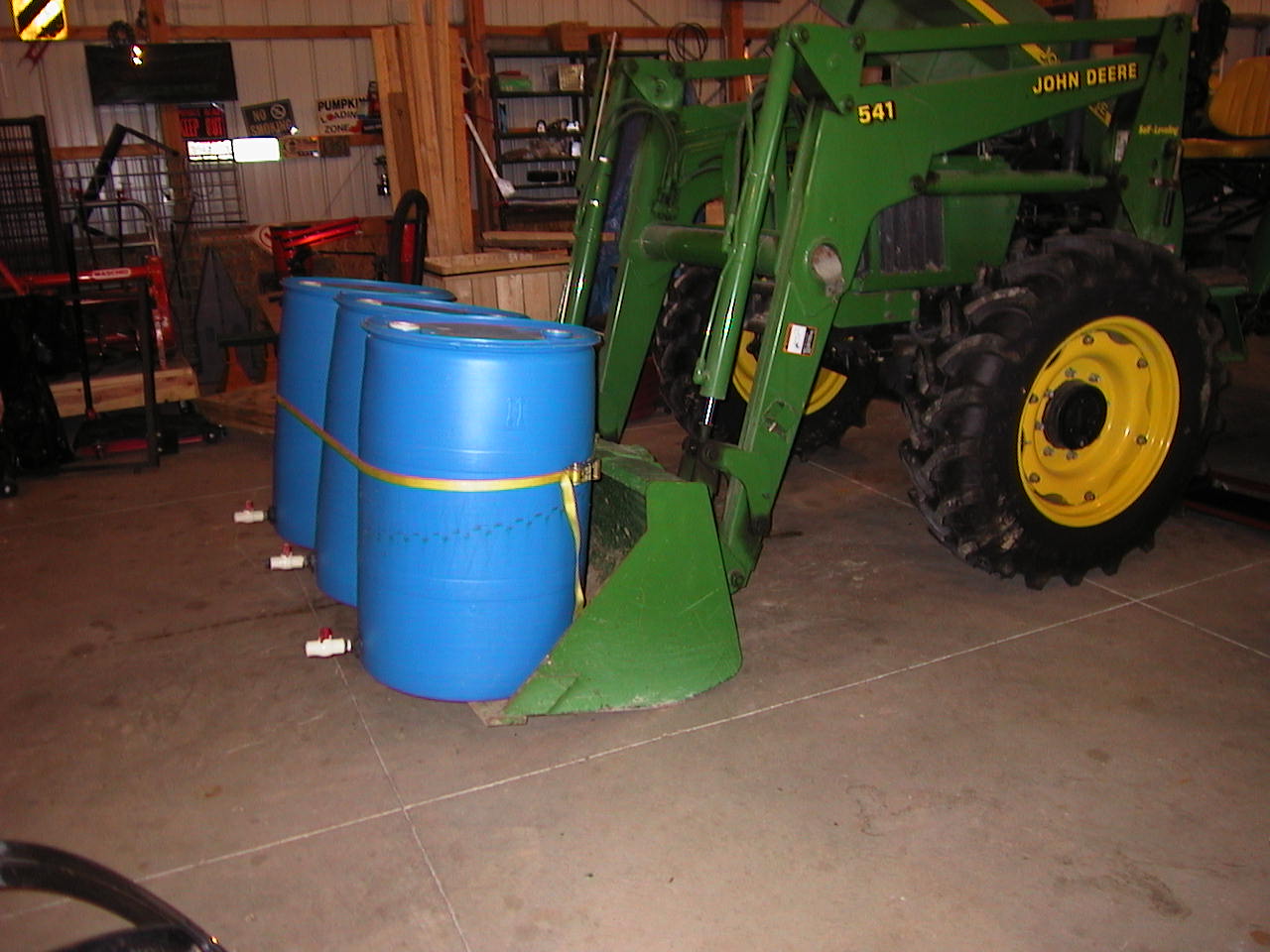

This will probably work and you can get cheap dishwashing detergent at Sam's Club. Use hot hot water. Or, just find another blue barrel and start over. Around here all those blue barrels are empty soy sauce containers and come from either WI or MI. There are untold thousands here and they go for just a few dollars up to maybe $8 each. Just figure it out and get one.
If you plan on drilling a hole on the side near the bottom for a plastic petcock, start looking for a slender guy with 36" arm inseam to reach inside to put the petcock through the drilled hole. That could be the hardest part.
You don't need the water right now anyway but come July-August you better be ready. We watered hundreds of tree seedlings this way. We drlled a 3/16" hole in the bottom of a five gallon bucket and used the blue barrels in the loader to fill the bucket once a week. I can't recall losing even one tree.
Here's my loader setup with three buckets. Works for me. The flimsy strap shown was just for use with empty buckets so get a stronger one too. If anyone reading this does the loader and water thing, know they can slip out and kill someone or something. Like a dog or kid that doesn't know to steer clear. You can also tip over on turns so keep the bucket low to the ground when moving.
Oh, and Travis...get a loader. Just buy one, write the check and post some pics. You're going to need a loder eventually and we needed the pics to look at yesterday.

OK, so lemme get this straight. I pay for the loader and find the exact parts for your project? Maybe, if it's not too much trouble I could swing down there and then install it for you....:D only kidding, relax. The hobby ag thing is OJT so you have to redneck this with trial and error. Every TBN'er should have this as a water setup since it's so easy and so useful.
You need a way to get the water out of the barrel so you need a plastic "ball valve" and the bigger the better. It will look like this LDR 3/4 in. PVC Ball Valve - Tractor Supply Co. EXCEPT one end will be internally threaded and one external. Lowe's sells them for less $$. You'll have to drill the correct size hole in the barrel--I think my drill was 1 1/4" and the thread size of the bung fitting was 3/4" but that's a guess.
You will also need this "bung fitting" that will fit through the hole you drilled in the barrel and will have two threaded pieces and a gasket to seal against leaks. One end of the bung fitting will be flush with the inside of the barrel and the female end will stick through the barrel so you can thread the male end of your plastic ball valve into it. Some ag places sell ball valve and bung fitting combinations as a package.
Now, the end of the ball valve will be internally threaded to accept a garden hose. Get a garden hose and you're good to go. Fill with water and look for dry things. If you happen to find any huntable doves, quail or whatever please send directions with a map, the names of some local diners and a letter of introduction so I can hunt for free.
Good luck, keep me posted and ask if you need more help on this valve thing.

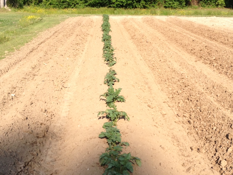

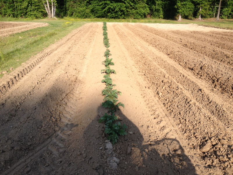

Got everything re-planted yesterday. Since I wasn't rushed I actually done it right this time.
1 row (100') of Dasher II Cucumber and Early Prolific Yellow Crookneck Squash on same row
3 3/4 rows (375') G-90 Sweet Corn
2 rows (150') Contender Bush Snap Beans
1 row (75') Cowhorn Okra
1 row (75') Russian Mammoth Sunflower Seeds
1 row (75'?) Black Diamond Watermelon
1 row (about 5 or 6 hills) Hales Best Jumbo Cantaloupe
***I do not like cantaloupe but if It'll grow for me I'm gonna eat it! Lol***
Here is a picture of the "new" 2014 Spring Garden, for the second making...
