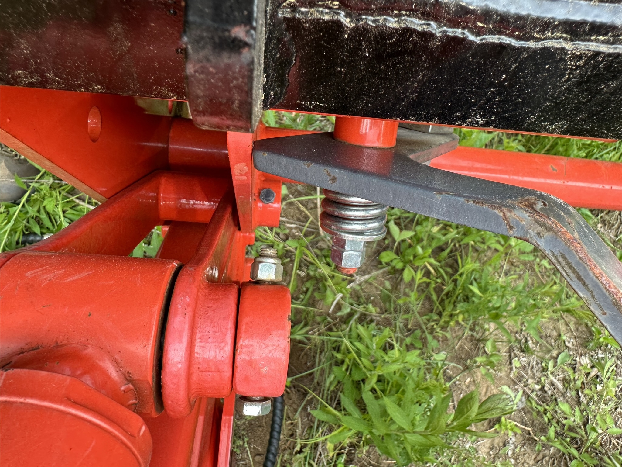

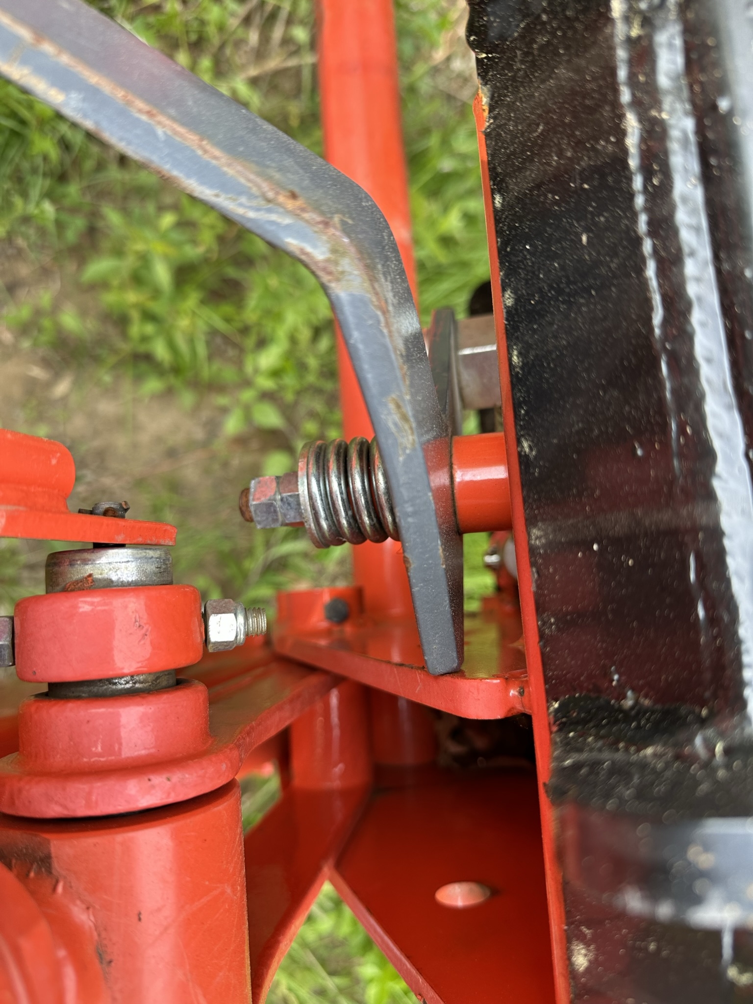

My LA11065 SSQA has one lever/pin which I can't release by hand. It takes a 2 foot pipe or a hammer on the pin.
Any thoughts on how to correct this?

I think I found the problem Nothing appears to be bent but the back of the lever is binding on the frame. I think a little grinding will solve it. I'll keep you posted.

Can you post a picture showing the clearance I don't have
Thanks Andy

I can later - I'm thinking mine stop right where yours do but that seems to be all they need to go to release the pins. I'm not 100% sure where your clearance problem is on the bad side.
/ MX5200 LA1065 SSQA Issue #11
I agree, that's the limit of "throw" for the lever. Do not grind it.....yet.
Does the lever operate easily without a bucket?
I have the same on my Kubota and it works smoothly.
This is with the lever "open "
Next compare the other levers operation, does it move with equal effort?
Lastly compare the adjustment to the rod and spring that's to the left in the picture. Adjust it to the approximate look of the one that doesn't give you trouble.
