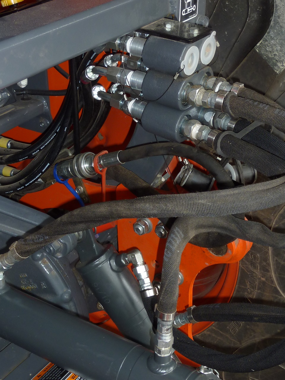

What QA couplers does my MX5200 use? The are not flat faced. The push on and pull off like magic.
I need to buy a pair.
   / MX5200 Couplers #2
Look at this thread. Seems to be ISO5675. Thread is about the male tip, but lot’s of info here.
   / MX5200 Couplers #3
The ‘push-pull’ sounds like a Pioneer style.
   / MX5200 Couplers
I googled that - it looks correct. Ball style.
Thank you TT that thread was important. I will measure and try to read the etchings I saw on one male fitting.
THis pic from the other thread matches what I got on my 2018 MX
