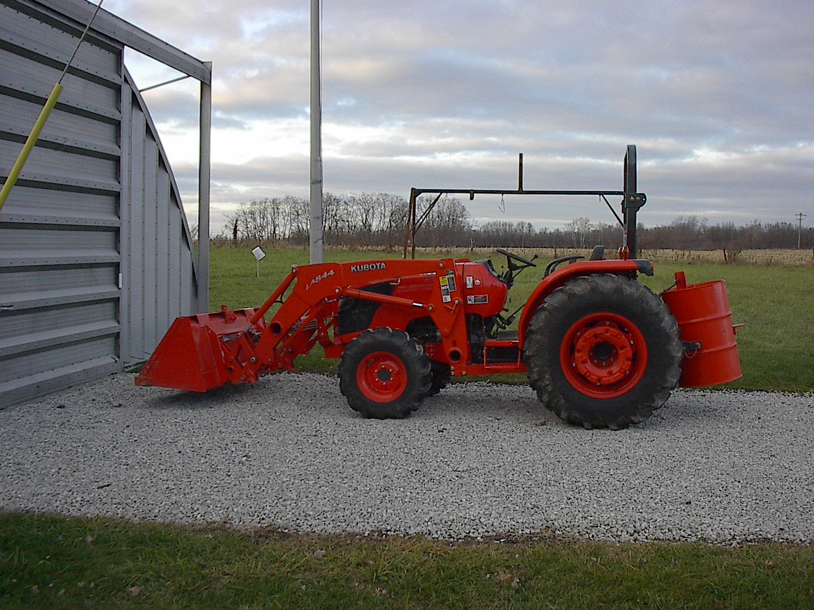

/ Mx5100 let me down! #25
This is my set up . Wheel weights and 900 lb.s on back easy on easy off when I don't need it.

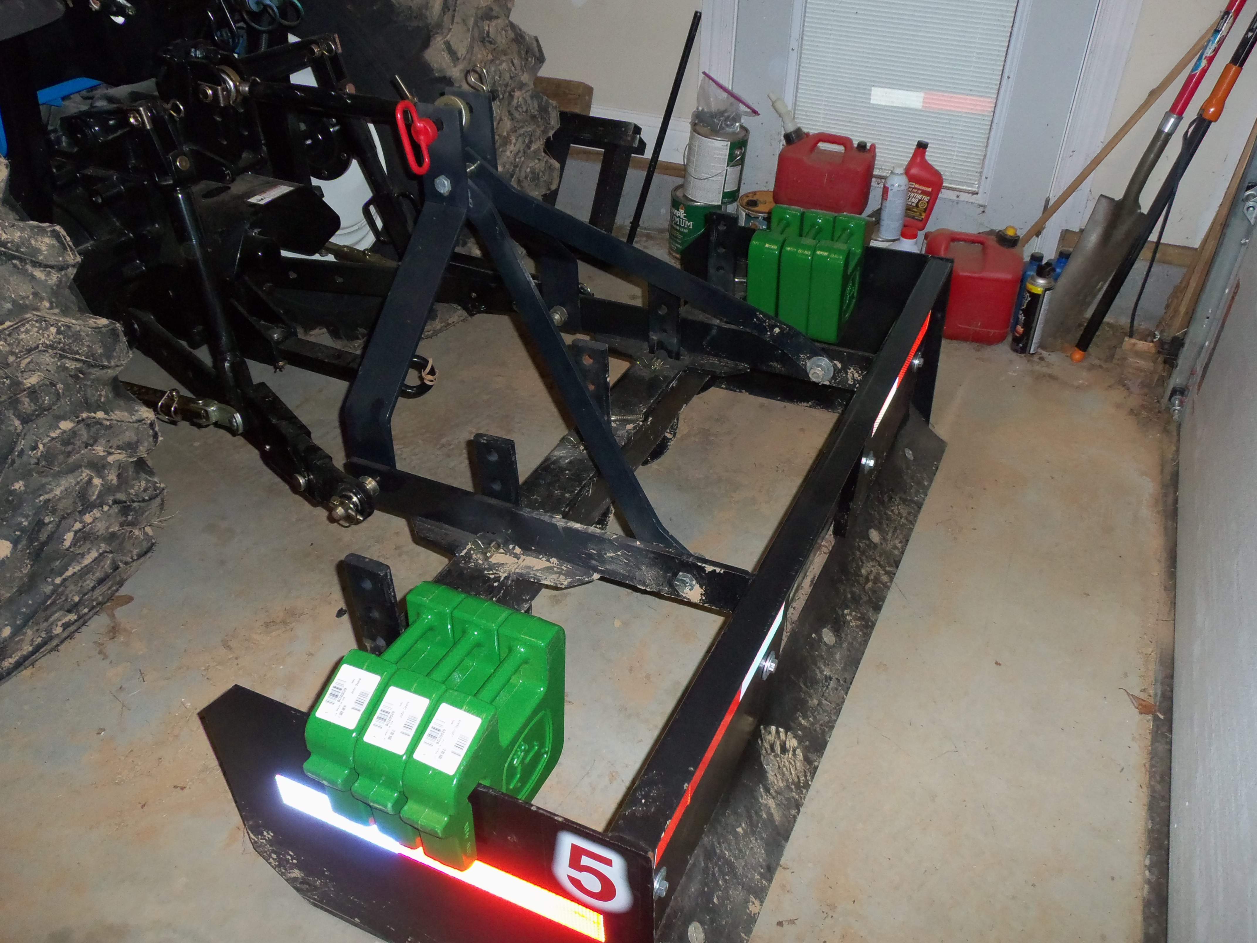

/ Mx5100 let me down! #26
My tractor is front heavy. With the loader and nothing in the bucket, the rear end was very light. When I tried to backup on a very slight incline I had to uise 4 wd. The box blade I have weighs 759 pounds with the weight I added, two steel plates bolted on and six 42 lb suitcase weights. There is no way I would I try to lift anything without the box blade on the back.
