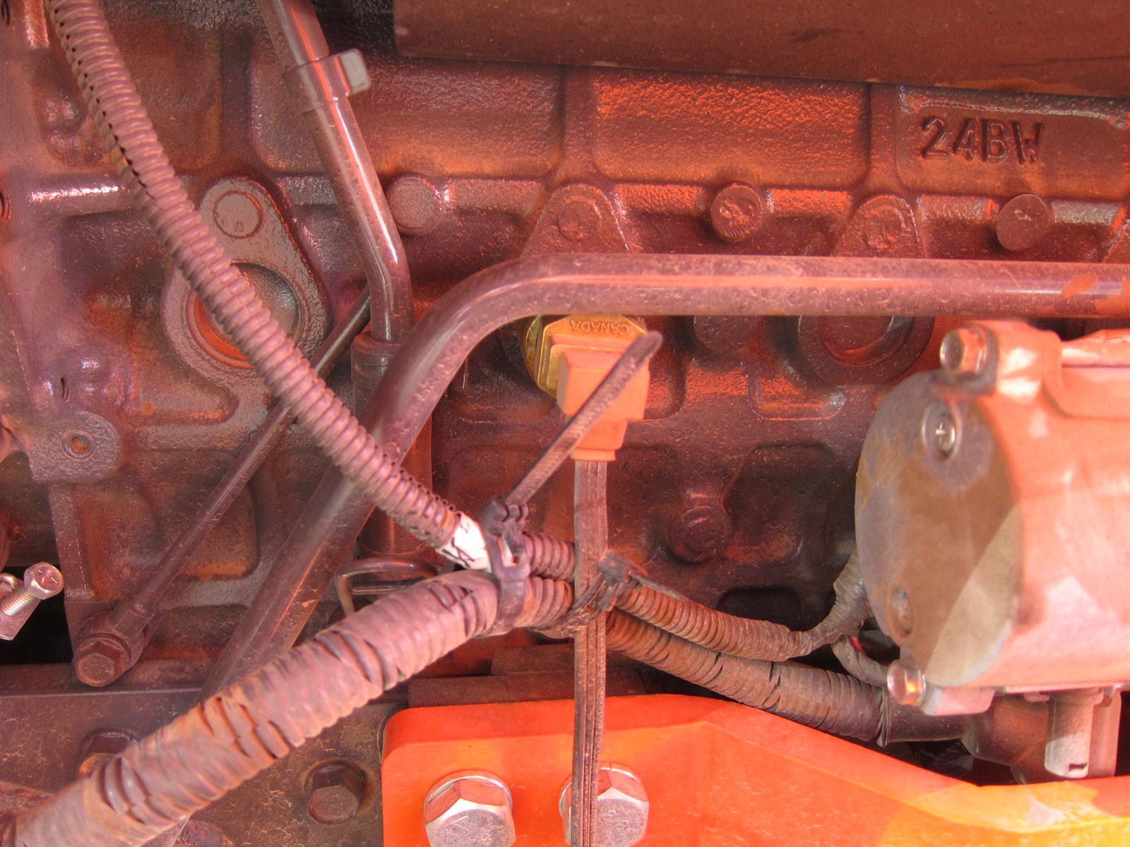

Looking for pics or instructions of a block heater on this tractor or one similar. Thanks

Here is what the block heater looks like (orange block at center of photo) installed on MX5100.

Block heater. We plug ours in an hour before starting on a zero degree morning, longer if the weather is colder, and they fire right up. My L5740, although the dealer installed it as standard equipment up here, sits in a heated garage because its job is to clean up so we can move around so it's block heater has never been tested. I assume it will work like those on our larger Deeres and New Hollands.
   / Mx5100 Block Heater #10
I have the block heater on my 5740. It is located on the left side over the starter. I can post some pictures later this week.
