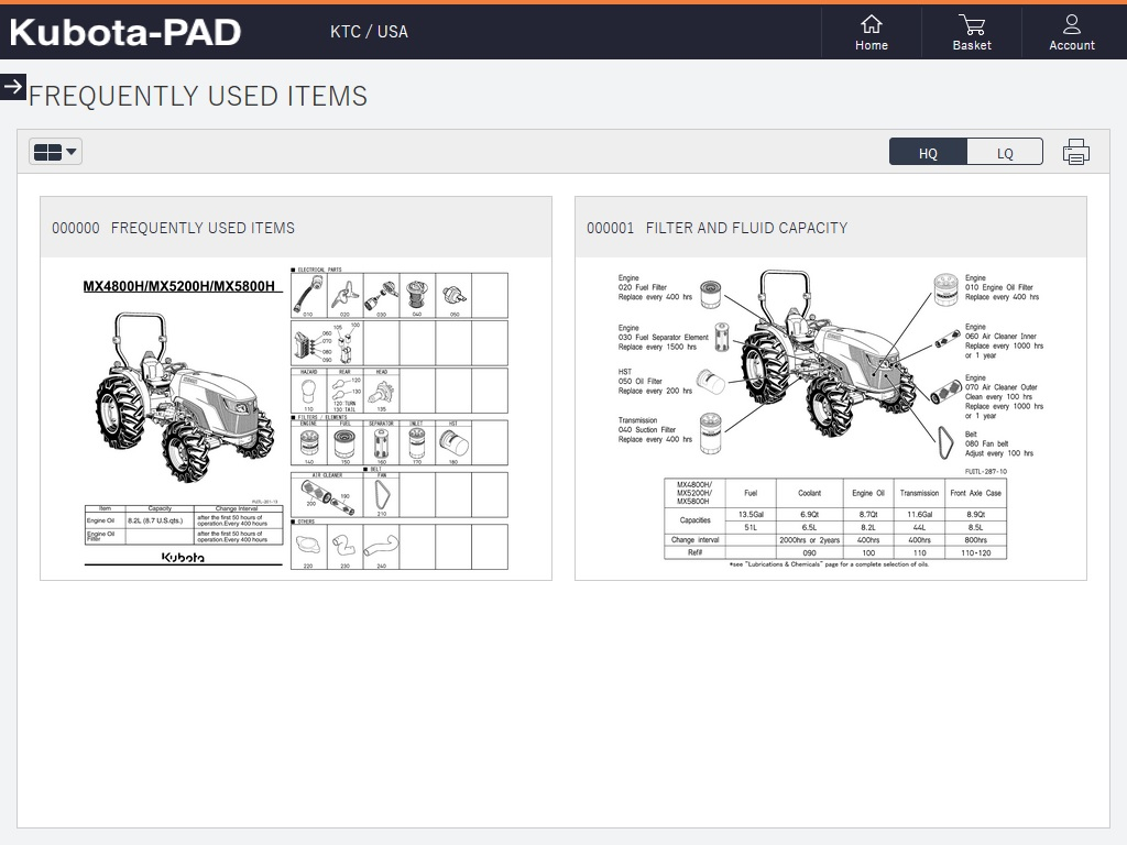

Getting ready to do 400 hour service. Based on suggested parts (only filters and oil) and looking at parts lists, I see no pickup screen. Correct? I'd hate to have to drain 12 gallons of UDT2 if I'm wrong. Pretty sure I'm right.
Kubotas draw trans oil through the filter(s). Owner's book may say 11.6 gal but its more like 8 unless every pump, cylinder, filter and cooler is dry.
