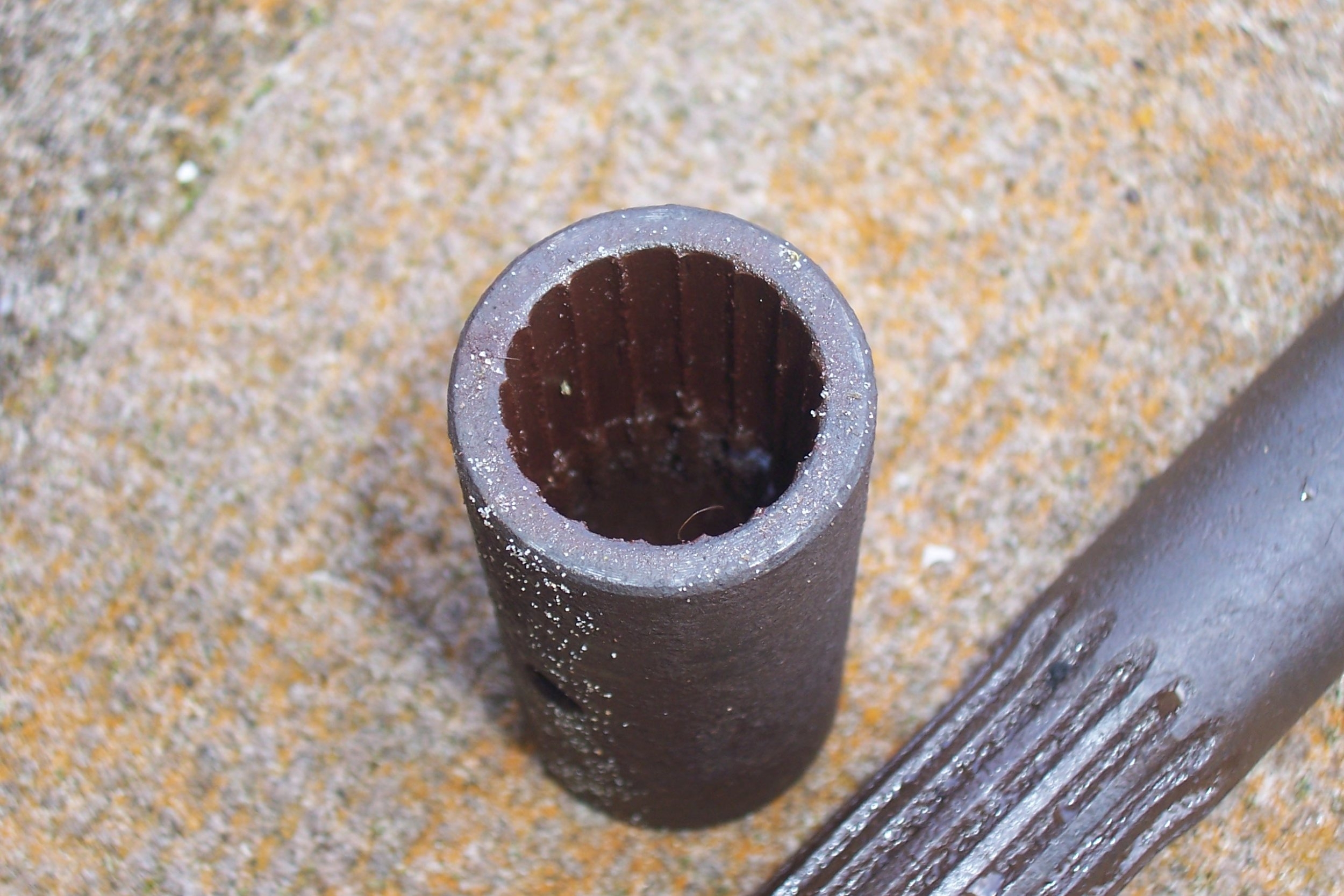

I wonder if a good borescope could take a look at both those things - the front driveshaft coupling and the diff lock?
/ MX4700DT nasty, expensive noises
#25
Incremental progress. He was able to fish out the rear coupling with a "grabber" I lent him - four fingers on a flexible shaft (from Harbor Freight, I think), and using a length of welding rod, finagle the rear coupling back into place. He then re-inserted the rear half of the propeller shaft and it went correctly. (He did admit he learned something - "I never should have pulled that out in the first place.")
He was able to borrow a borescope but wound up not using it. (Yet.)
He's now waiting for some seals and a microswitch (PTO lockout or something) that Kubota is VERY proud of. The microswitch has a short pigtail and a connector, Kubota wants $34 for it. The switch itself might cost a whole buck at Mouser Electronics, but the two wires and the connector are obviously made of gold, as is the plastic bag it comes in.
Once the parts are in, he will button up the tractor, refill the hydraulic fluid and give it a whirl. I'll be overjoyed if the noise went away, but I won't be surprised if it didn't. I'm not going to spread doom and gloom . . .

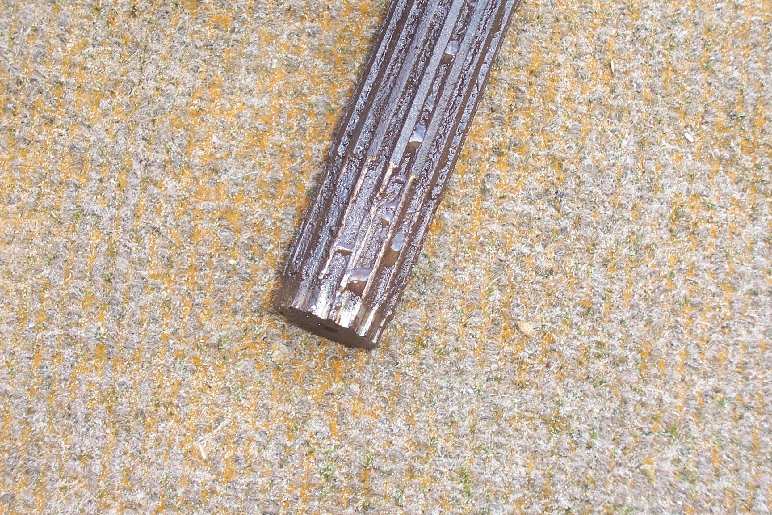

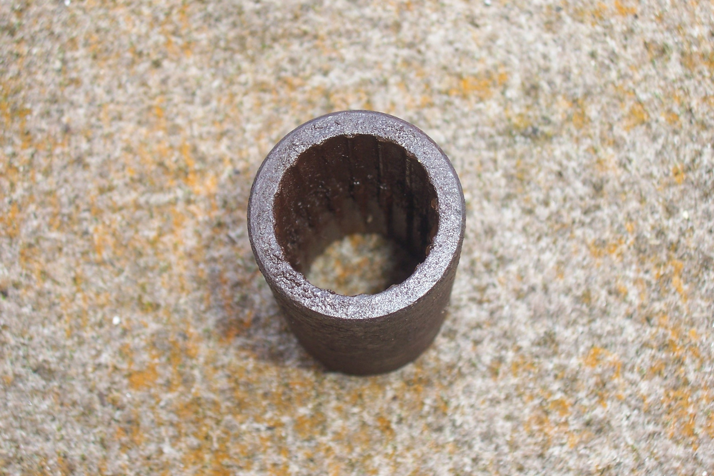

Wellllll, here's the update. (Sunday evening, 5/8)
He was able to get it back together with a lot of cussing, wiggling, pounding and so forth from him and some help from people pushing and pulling on the wheels, wiggling the jacks and so forth. I guess the tractor realized it was outnumbered and gave up - it went "click" and slid together - it was hanging up on the pilot bearing as suspected.
It appears I was barking up the wrong tree and I was wrong about the diff lock pins, and quite frankly, I am glad that I was wrong. He doesn't need any more expensive problems. (I still would have looked inside the rear cover, just to be sure, but that's me, and it isn't my tractor.)
What seems to have been happening is that the front coupling was so worn as to be ratcheting under load, intermittently skipping teeth and grabbing, and the noise was transmitted to the rear end, making us think the problem was there, and it was not.
He replaced the front coupling and front drive shaft, an oil seal in the bell housing and the utterly worn out tie rod ends (and that expensive microswitch). He did disassemble and look at the front drive axles, some bearings and checked the front differential, and they are all fine. The steering components, as MHarryE mentioned above, were very dry and the seals were shot (replaced). Fortunately there were no metal "sparklies" or chips in the oil, and no water had entered to make the oil milky.
He's out mowing, and I *think* he's OK now. I'll keep my fingers crossed that my suspicions were unfounded and that he's back in business.
As the Bard said a long time ago, all's well that ends well, but I doubt he was talking about tractors ;-)
