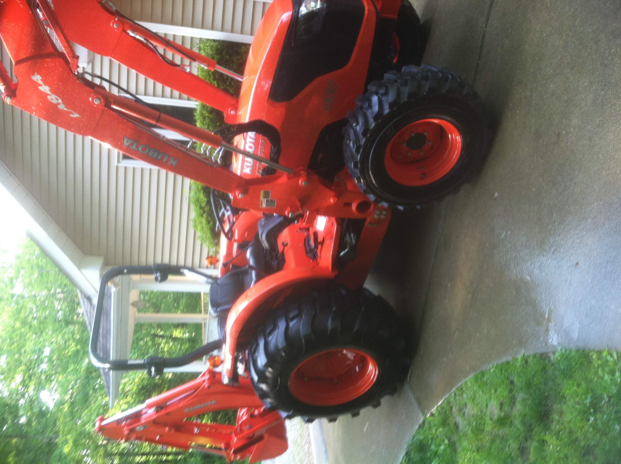

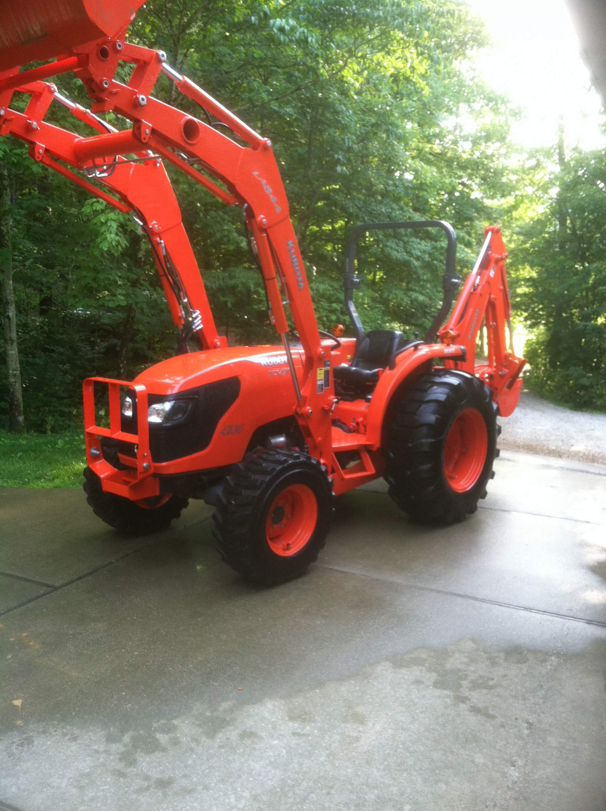

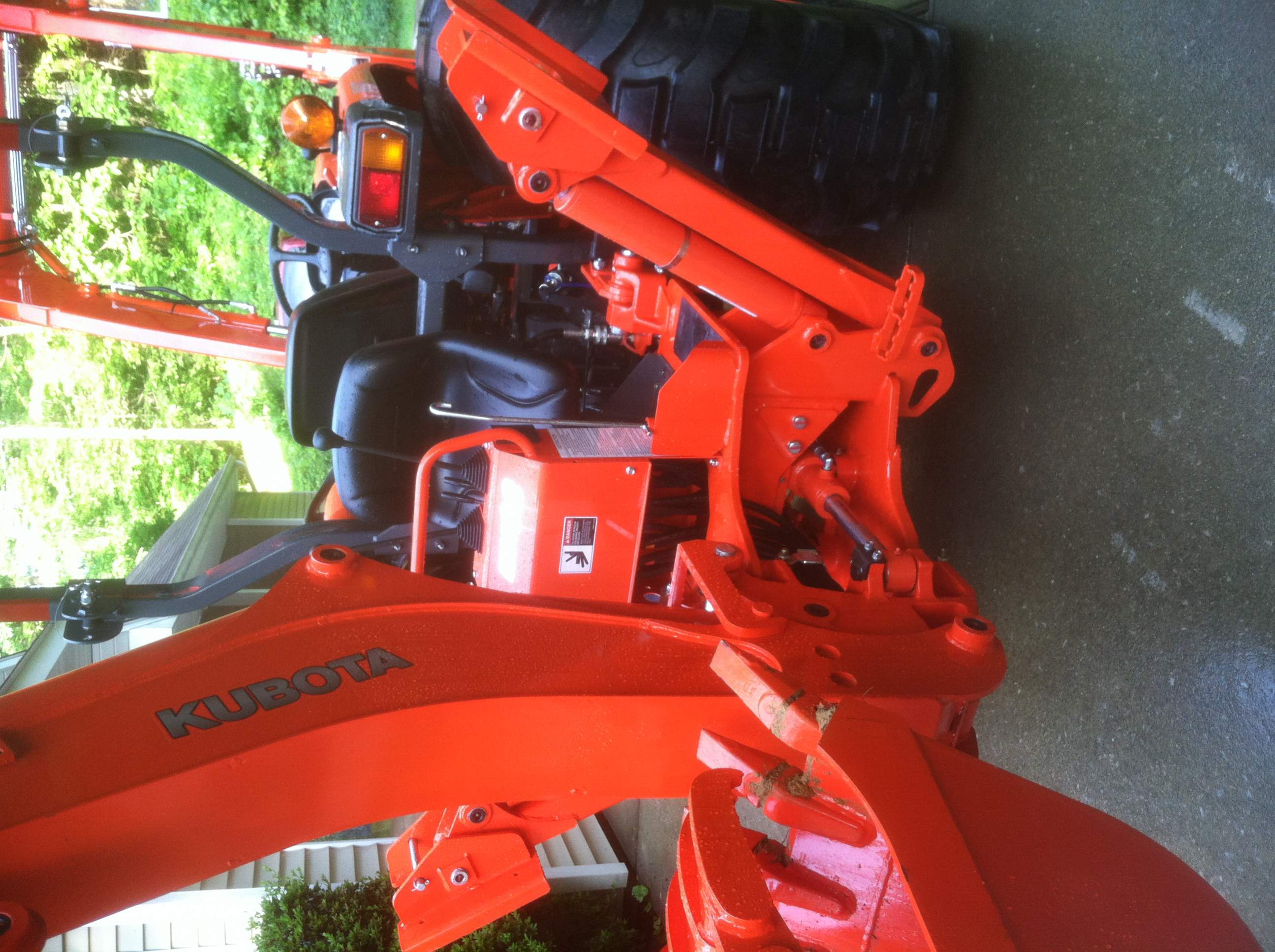

Just got my MX4700HSD LA844,BH92 over the weekend, wow what a beast!!!, but got to get use to the parking brake, found myself driving it around with parking brake on-you can't tell if its applyed or not just by looking at the peddles and set lever..had to raise seat with a stack of washers to, frt of seat leans forward to much. also moved the FWD lever ingaugement sticker up on the panel so you don't have to look way down just to find out what drive it's in.
jumpered the clutch engaugement switch so it can be started without clutch disengauged too.
I don't like having to apply clutch just to start everytime..
one other thing weird is the sound of this engine sounds like a coffee perculator at about 1800 to 2000 RPM..
