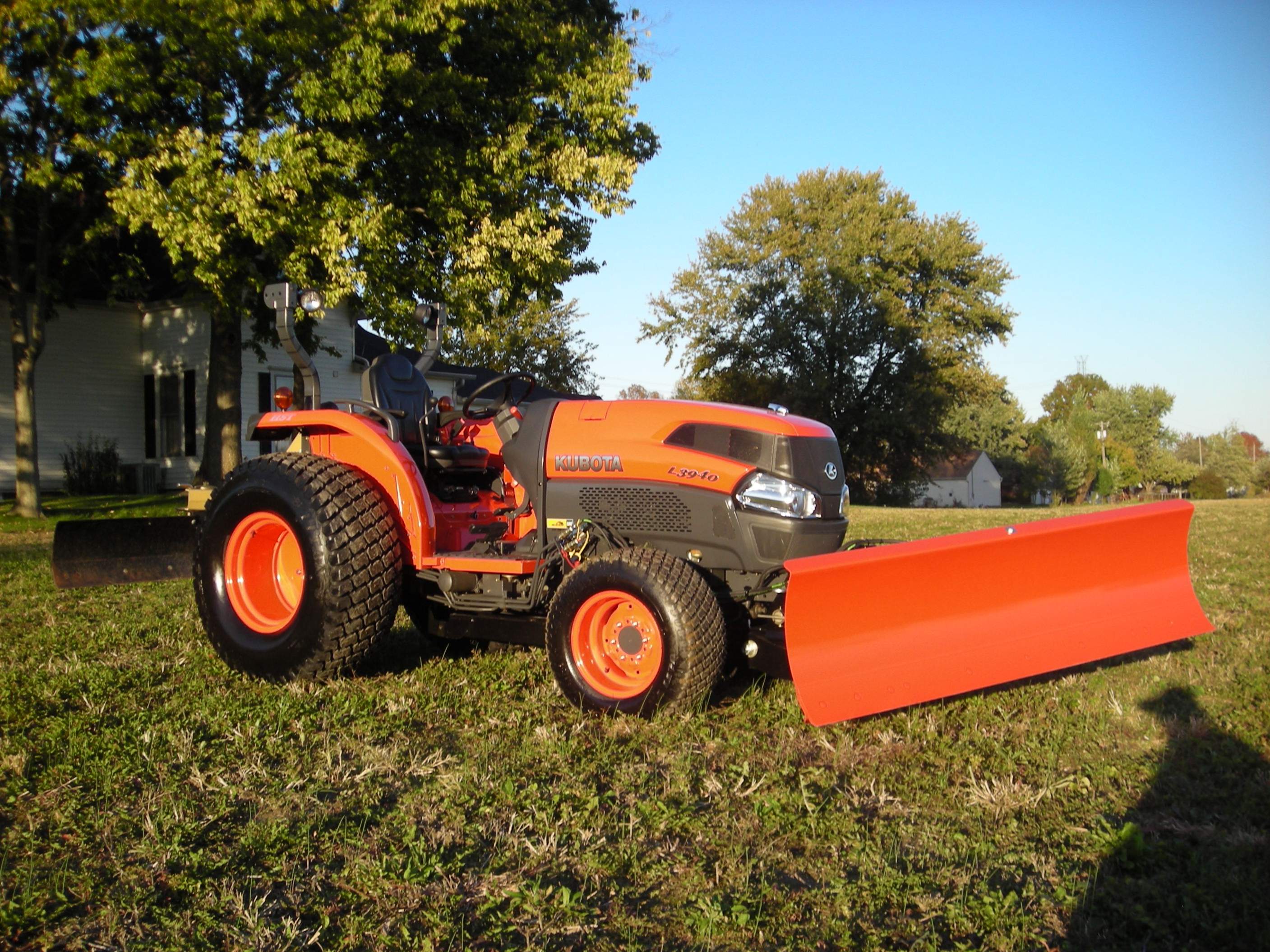

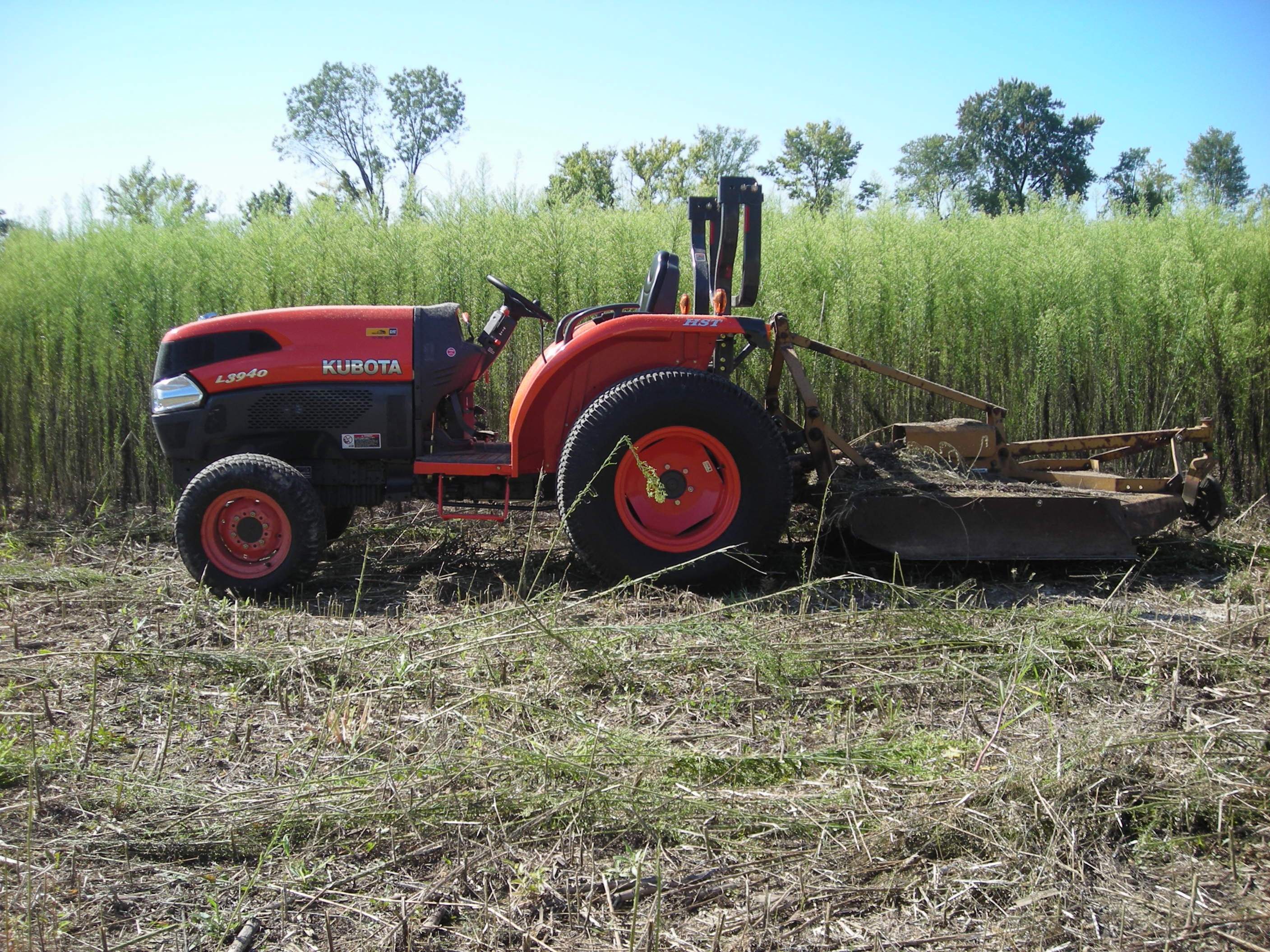

I have been very satisfied with my L3940 HST-2. Main duties are keeping drive cleared of snow, finish mowing, plus every other odd job I can think of; plus other jobs that people think of who knows I have a tractor, but that's okay. Best advise given so far is get a little seat time on both and think of what you need for the future. Philip.

/ MX4700 or L3940? #7

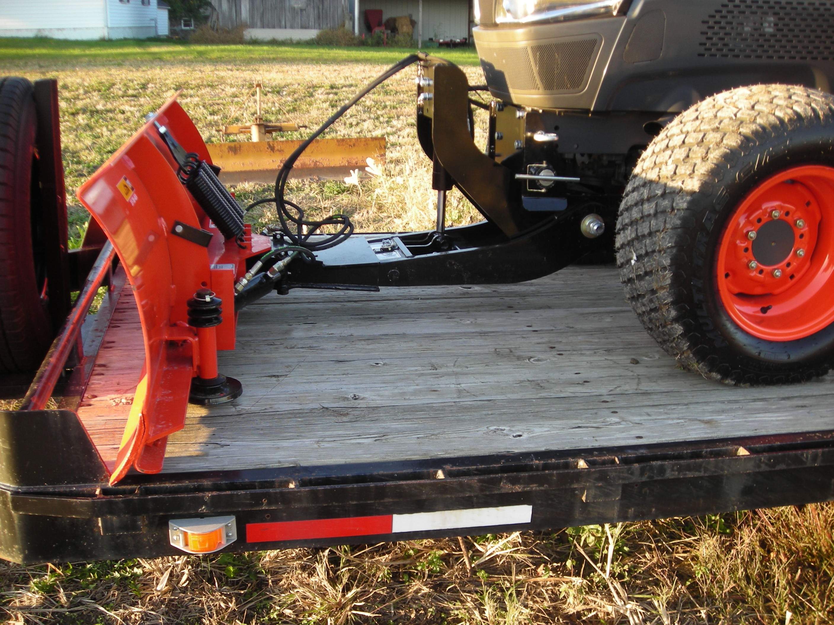

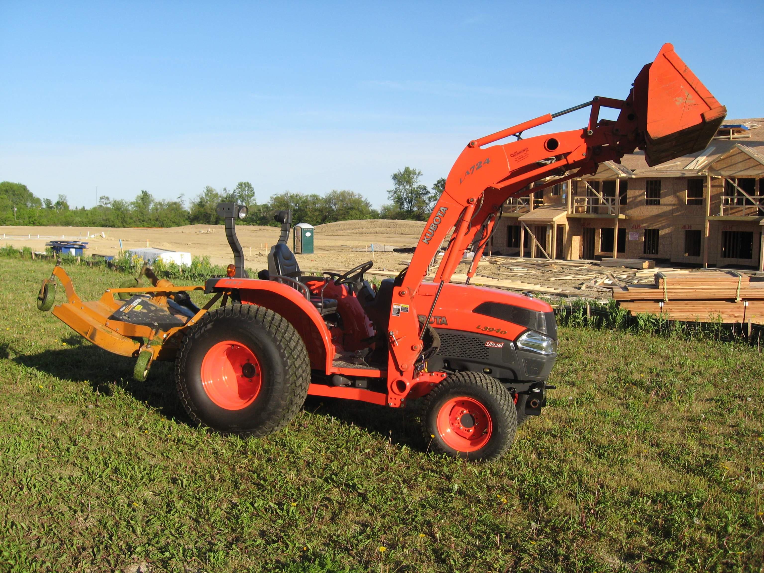

Philip, I don't mean to get this thread off topic, but have to ask how you are managing with both the front blade (pic #2) and the FEL (pic #3) on apparently the same tractor. Are you adding/removing the FEL mounting assembly each time you change? That's a pretty major changeover!
/ MX4700 or L3940? #8

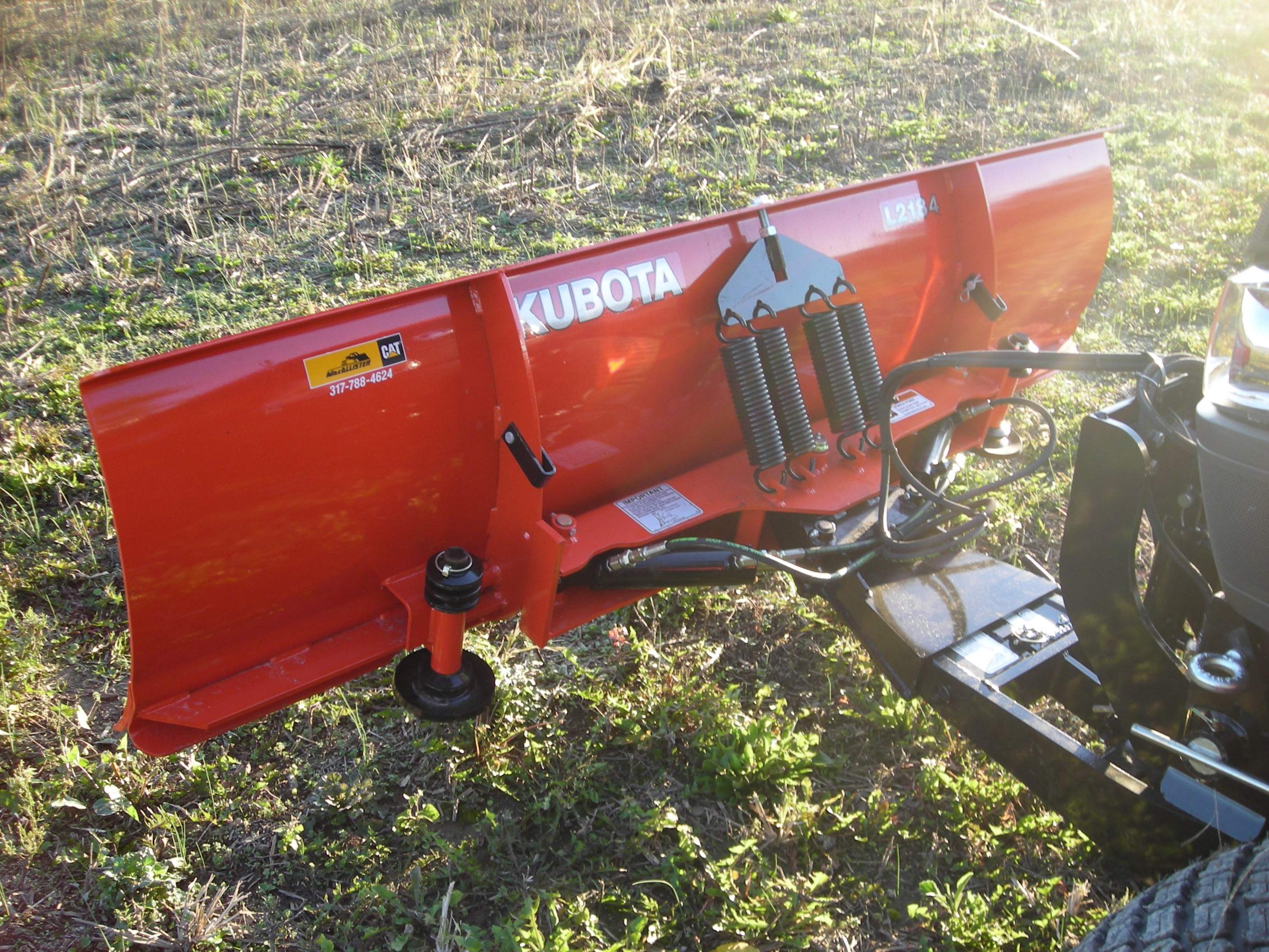

The FEL has its own seperate bracket on the left and right side, with bars running back to connect to the rear axle. Most of us are familar with this.
The quick-attach sub frame attaches to the tractor via front bolt on mount (shown), side mounts, and drawbar mount. With this quick attach sub frame you can attach front blade, snow blower, or rotary broom.
Either one is fairly quick to remove and install with the aid of hydraulics and quick attach pins, but you can't use both at the same time. No brackets are removed or bolts turned when changing from one to the other. This is a benefit of the Grand L tractor that you may not find on other models.
Philip

/ MX4700 or L3940? #9
But you have to remove the left and right FEL brackets to use the front blade, right? That was what I was calling the "FEL mounting assembly" . Please forgive my knoweldge gap if Kub has changed the design so it uses pins instead of bolts, as on my older L machine. It does kind of remind me of putting the cultivators on a tractor back in the day. No criticism intended... if it works for you, great, but it kind of surprised me.
/ MX4700 or L3940? #10
But you have to remove the left and right FEL brackets, which are bolted to the frame and axle, to use the front blade, right? That was what I was calling the "FEL mounting assembly" Pardon any confusion in terms, but unbolting those brackets, which are quite heavy and must be torqued to specs when installed, just seemed to be a major changeover. Kind of reminds me of putting the cultivators on back in the day. No criticism intended... if it works for you, great, but it kind of surprised me.
No, You do not have to remove ANY brackets bolted to the tractor to switch from fel or front blade. The large fel brackets on the side stay on all the time. The pic with the front blade was taken last fall. I got the fel this spring. I dont have any pics of the front blade mounted with fel brackets in place, but trust me, you do not have to remove them. Philip.
/ MX4700 or L3940? #11
Ahhh... that would explain it. We basically noticed the big orange FEL mounts that are bolted on the frame were missing...
/ MX4700 or L3940? #12
Thanks for explaining... I learned something today. Nice design feature for people who need a front blade and FEL. Mine is an older desgn whose FEL brackets are bolted to the axle and frame. That, plus a bit of old age, led to my confusion.
