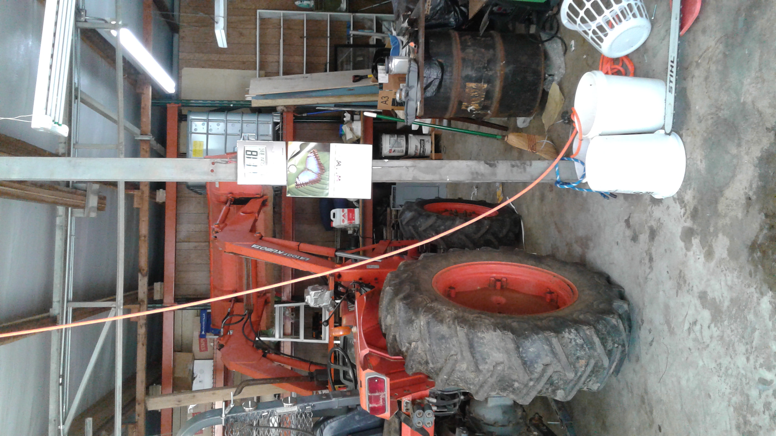

That is similar to my situation back in 2012, I needed a tractor to be able to pick up a ton. But I would have settled for the "on the 3 pt".
Well things got out of hand and I ended up in January 2013 buying an M4700 that does a ton on the FEL for $12,000.
With only loaded rears and a rounded bucket full of wet gravel/sand mix (I think that's close to a ton) I can bounce the rear if I drop the bucket a few inches quickly.
So if you want to be able to pick up 1 ton routinely you might want to consider having either something hanging off the back or a larger tractor. I know I'm tight for maneuver room in my 40x40 workshop w/ my M4700 when I'm putting stuff on the shelves: (apologize for the sideway pic)
attachment.php
and wouldn't have room for much hanging off the back so take that into consideration.
Now "how much do they go for"?
Like I wrote, I paid $11,500 plus fees for my workhorse (with 1,400 hours on it) in 2013. You should be able to buy new for about $30K.
