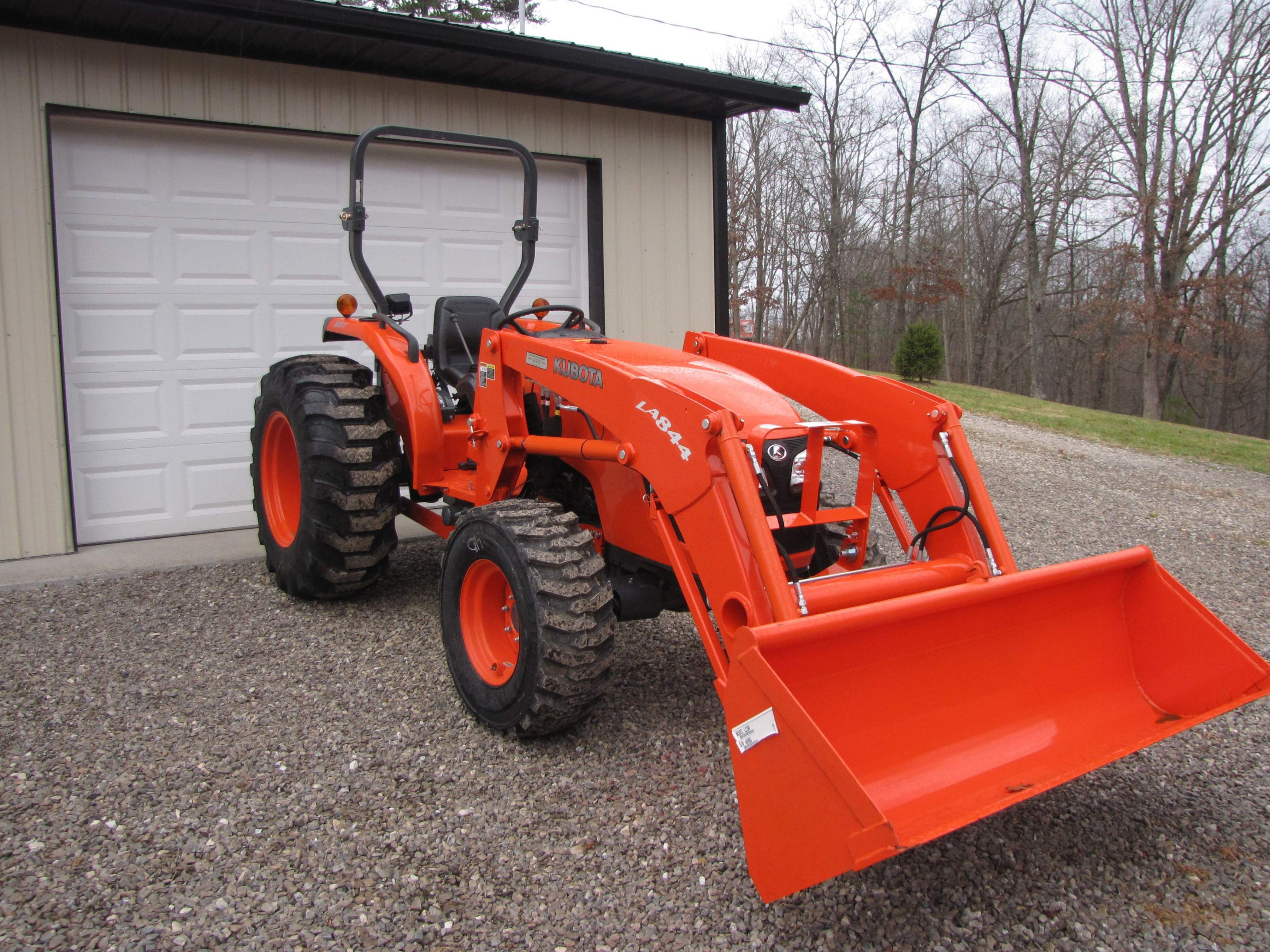

The new MX5100 came today and I am impressed. I was asked by a few people to post a photo and answer a couple questions.
I had a L3700SU before this one and liked the tractor and felt it was a good machine despite the jerky 3pt hitch. The new 5100 is very smooth both lifting and lowering and I did not notice any jumpiness on the 3pt. I also had to lift about 900lbs from the bed of my truck today and it picked up up very easily and smoothly with the front loader (set of SSQD forks on). The tractor was far more stable and even without a counter balance I felt planted to the ground (flat only had to drive back about 10 feet however)
I also noticed it is far more stable on our WV hills and the larger wheels and tires do provide a smoother ride.
Anyway, I hope this answers all the questions I was asked and if there are other let me know!

Congrats Code, great looking tractor.
   / MX 5100 review and info #3
Congrats code, mine was delivered last week, im loving it as well. Merry christmas to YOU!!!!

Looks great, and thanks that helps confirm about the 3pt. as I knew you wold know what we are talking about on the jerky 3pt, you would be an objective observer of the Mx5100. I am starting to turn a little green now with envy, though:) Whatever are you going to do with all that new found lift capacity and horsepower:eek:? I was just thinking about a couple of rocks I would like to move but cannot lift... Oh well.. enjoy that new great looking powerful tractor:thumbsup:

I live in Central Kentucky in the knob area just outside of Frankfort. I bought a new 5100 in August of this year equipped very similarly to yours. To-date I really love this tractor. I have been waiting until I have used it for over 100 hours to post a full-blown review. I have about 70 hours on it so far and other than a couple of peeves, the differential lock, and the brake pedals on the right side of the tractor just above the HST pedal, and the noise level, it is darn near perfect for my uses. It is markedly more stable on the hills than my L2900 was and the loader is amazing. I put a toothbar on it and it is truly a digging machine.

Code54, I have the MX5100 as well, so far I like it very much. I live in Summers Co., WV...on top of a mt. so I can relate to hills. Remember, rear ballast is your friend. :)
