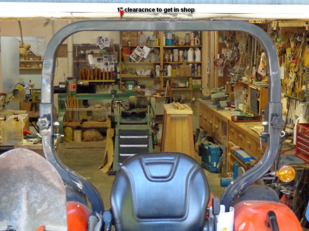

I cut down the rops to fit in the shop door and and not hit limbs because it was ridiculously high . Last yr. when I flipped the tractor over on a steep bank I got to test it out. The only mark on the tractor was from the chain on the rops when I used my backhoe to lift it back up on the trail. The cause of the flip over was the HST pedal stuck down and I had the engine wide open in first gear. By the time I could kick it hard enough for reverse it was to late. This was on a 2015 CK27 that had 3 new transmissions installed from blowing seals. Good news is the dealer gave me what I paid for it off the price of a new 2610.
Bill, how much had you cut down the ROPS?

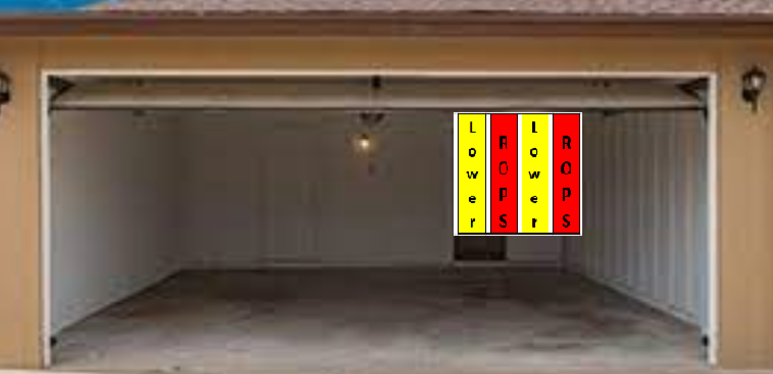

If you have a garage door that requires you to fold down your ROPS, I always wondered about something like police tape that you would install at about 3' high on the inside of the door that would hang down about 3' when the door was open to remind you to lower the ROPS. Or would that become too familiar?

MossyDell not sure ( 6 or 8" ) so there was was 1" clearance to go threw a 7' high over head dr.
