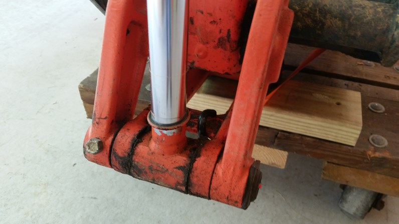

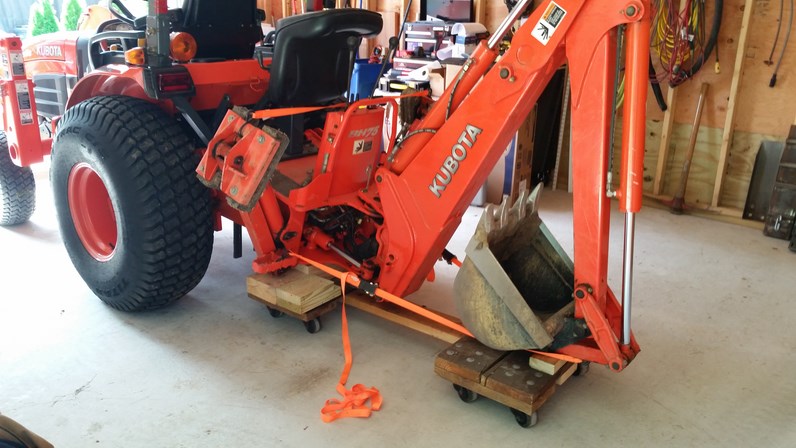

I keep my BH75 on a dolly most of the time. I use 3 ratchet straps (2 bucket, 1 legs) to keep it in position before I release the pressure. This way when I want to put it on I just wheel it up over the frame hooks, hook up the hydraulic lines, remove the straps and lift it into place. Install the two pins and it's done.
Super easy!
Of course it only works with the right color straps! :laughing:
