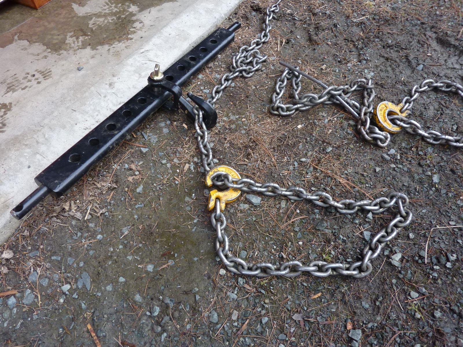

I've been looking at drawbars as I have a number of trees down that I will need to skid out of the woods. There are a number on ebay that look pretty good. Any opinion on what would work well for that?
Cross drawbar, tractor hook, and choker chains at TSC. Simple, inexpensive, and useful.

If you do your own maintenance, you will probably find like me that the hydrostatic filter is super heavy duty and is really tight. Removing it will destroy any normal filter wrench. I have a plumber's strap wrench for that job. When you mentioned drawbar, I hope you weren't referring to the bar they sell for using between the lower links on your 3 point. Dragging trees out of the woods should be done with the tractor drawbar, clevis pinned to it, and a chain. Your operator manual will cover this. Pulling from higher can cause rear flips. Different with 3 point attachments as they are designed to prevent rearward rollover accidents. I also have a pair of really larger Channel-Loks to change my fuel filter although many will slam me for using pliers on a tractor, but the lock ring on the filter can be tough to remove. I have a Lincoln electric grease gun. My mini-excavator has a large decal on it, "I Live on Grease" but this is a nice to have, not a need to have.
