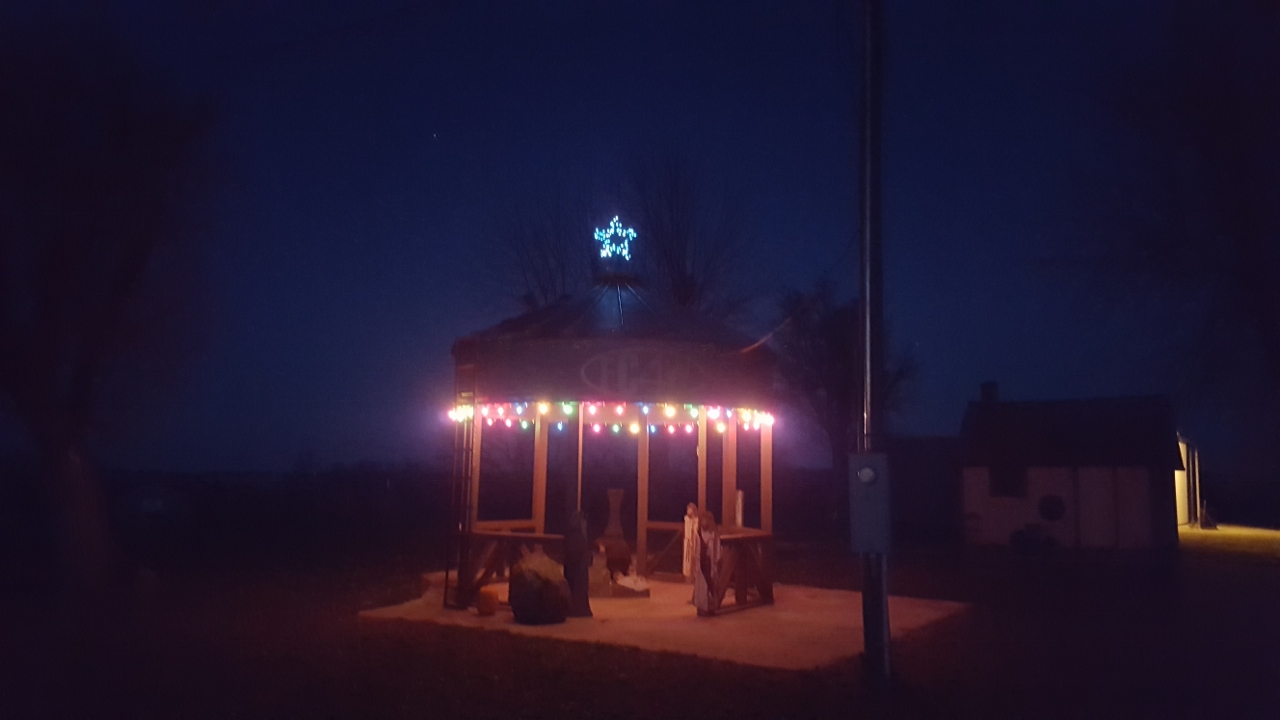

I've got a Binzebo out by the road that I built a few years ago. We decorate it seasonally. Have xmas lights on it that are on a dusk/dawn timer. I have them set to turn off at 10p.m.

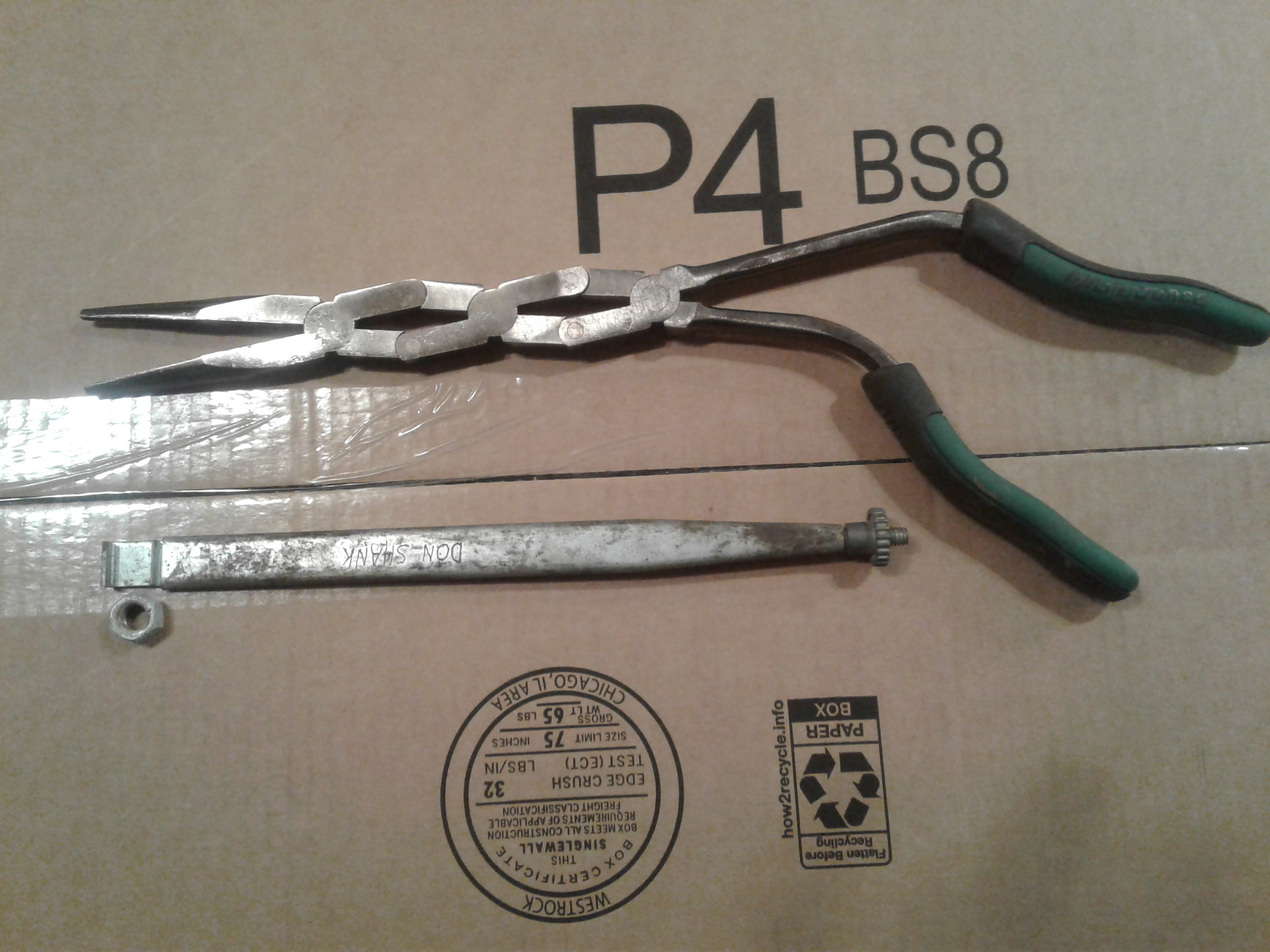

If you don't have it, you need it. Guys with tools are like women with shoes. If you buy a tool and use it 10 years later you'll be glad you had the foresight to buy it. magnetic pickup tools and long reach tools aren't daily use tools, super handy when needed.

...magnetic pickup tools and long reach tools aren't daily use tools, super handy when needed.
Those compound hinged pliers might be a nice concept for a manual post hole digger...
Not looking forwards to lifting that in and out of a deep hole though.
I have the common flexy cable long reach grabber with little fingers on the end. I've had it for at least 30 years and finally needed it the other day when I dropped a nut into my PTO chipper. I taped the grabber to a coat hanger along with a cheap PC borescope. Worked pretty well.
