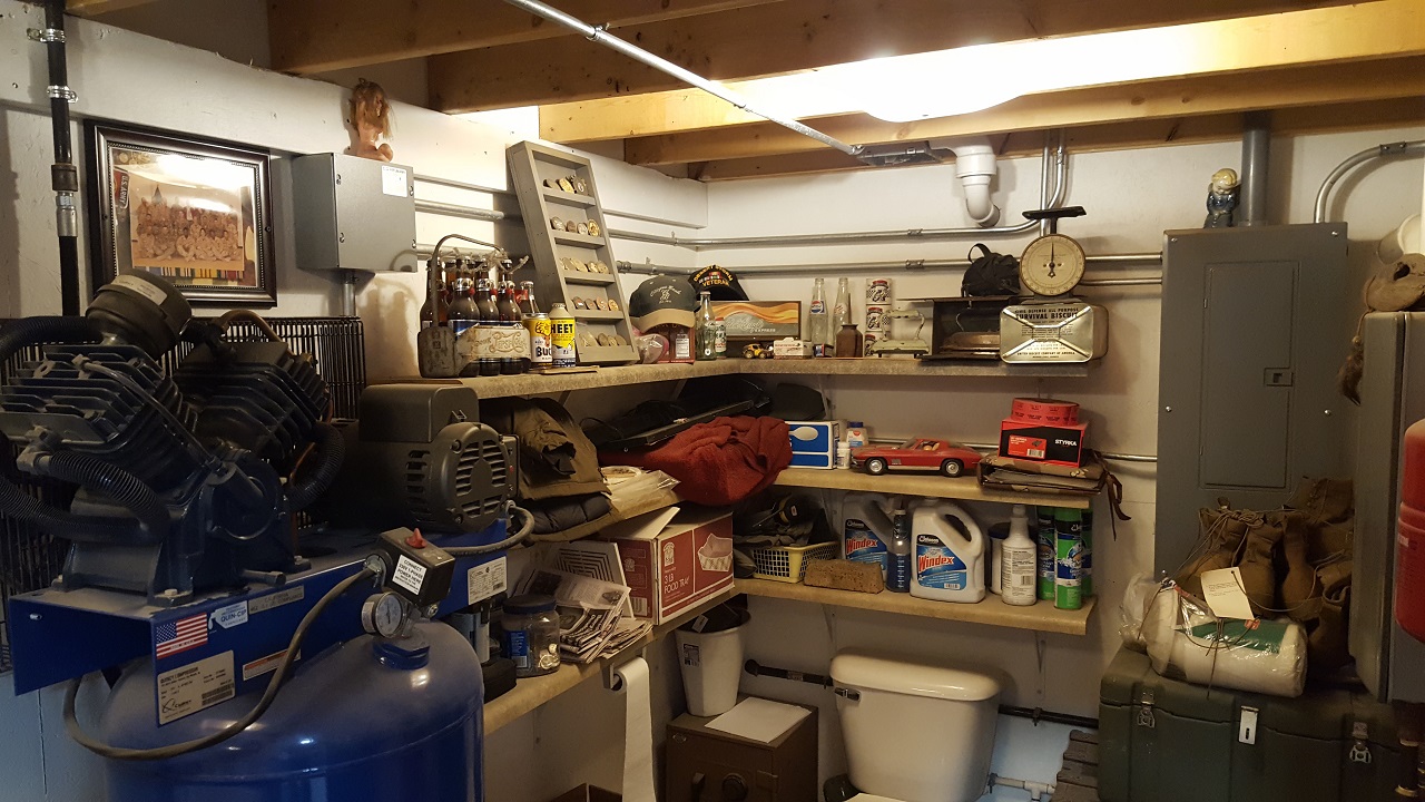

Mark, I think I paid $40 for the contactor, another $10 for the box. The box is between the power source (fuse box) and the compressor. Then add a circuit from the nearest light to the box. All of that was pretty simple for me since the compressor is in the bathroom and so is the fuse box. The light circuit was about 20ft away.
I guess I need to relook at this tomorrow. Sounds like I need to run wiring from my 20amp 220v breaker to a contractor that is located in a box and then wire to the outlet where the compressor is plugged in and another wire to the 110v circuit that the lights are on?

Make sure that you get a contactor with a 110v coil, many of them have a 24v coil. It's a lot easier to connect with the lights without having to get a 24v transformer.

You need to intercept your circuit going to the compressor at a location that's most convenient, and/or closest to the light circuit you are going to use. That's where you'll locate the box and contactor. Then you'll run a small gauge wire to a nearby light circuit. Actually only need one wire. That's where you'll provide switched power to the contactor.
