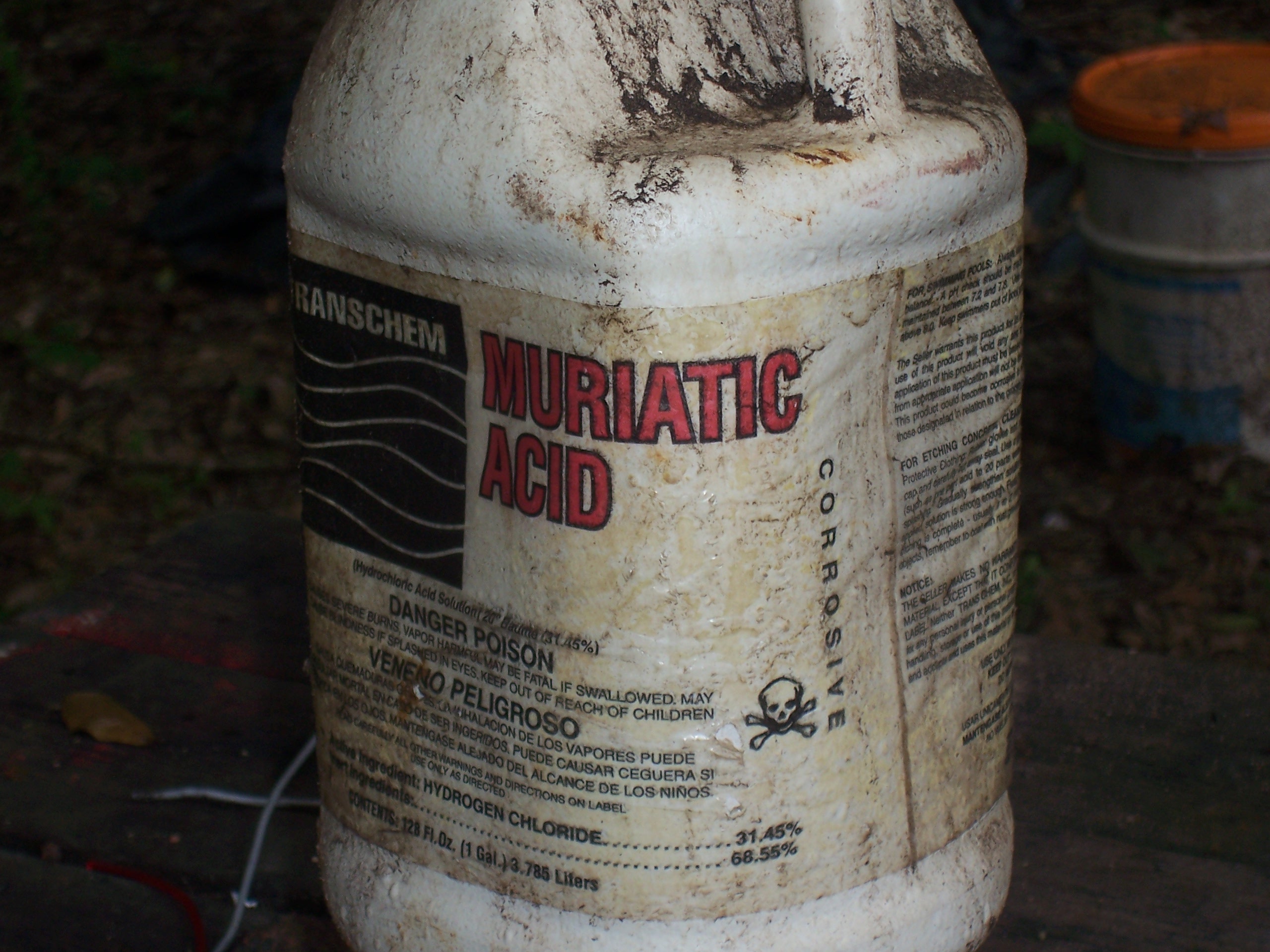

I new I still had some. Used it for YRS. Found it out back. The bucket with the Orange Lid I found it with "Alot" of people will know what for.;) Do you see the label and the Vertical Warning. Not in my Radiator LOL.
