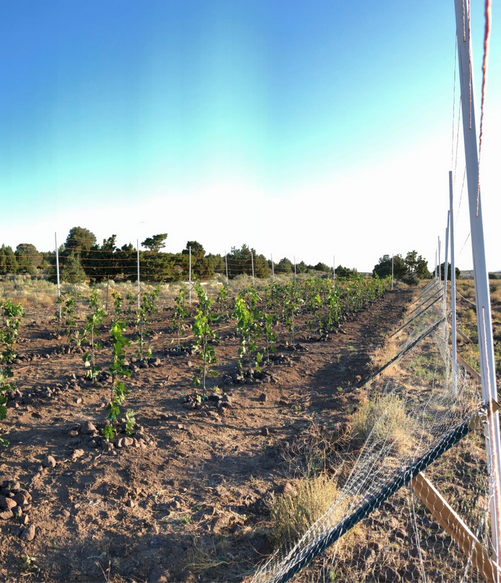

Hello fellow tractor users. This is 2nd post, and my 1st thread. I've lurked, learned, and leveraged what I've gained here. I thank you all and hope to distill more wisdom from you; and somehow contribute.
Given the old saw of "Good, cheap, and fast...pick 2", I need to construct a ≥8ft mule deer fence to protect a 1ac. vineyard in Northwestern Nevada. Prices are fluctuating wildly out there, so I don't know whether to bank on 10-12' t-posts, wooden round/square/rectangular posts, etc.
I have time, since I'll be doing it myself, so I need good and affordable. Plan is to use hydraulic auger for punching the holes, which is handy because it's how I prepare for vines.
Trial fence comprised of 9'6" pvc tied to shorter metal fenceposts, with bottom 4' chicken wire and 1' spaced wires (orange bailing twine) above that, worked very well, but it's neither permanent nor inexpensive. It's in the photo. Ignore the angled bottom section, as it was a relic from a prior attempt.
From the opinions on fence for mule deer from this page, 8' is the minimum height I'd want to go: How tall should a fence be for a mule deer? - The Environmental Literacy Council
Would you go 10'-12' T-posts anchored in concrete? Wood anchored in concrete? A combo? What questions am I not asking myself?

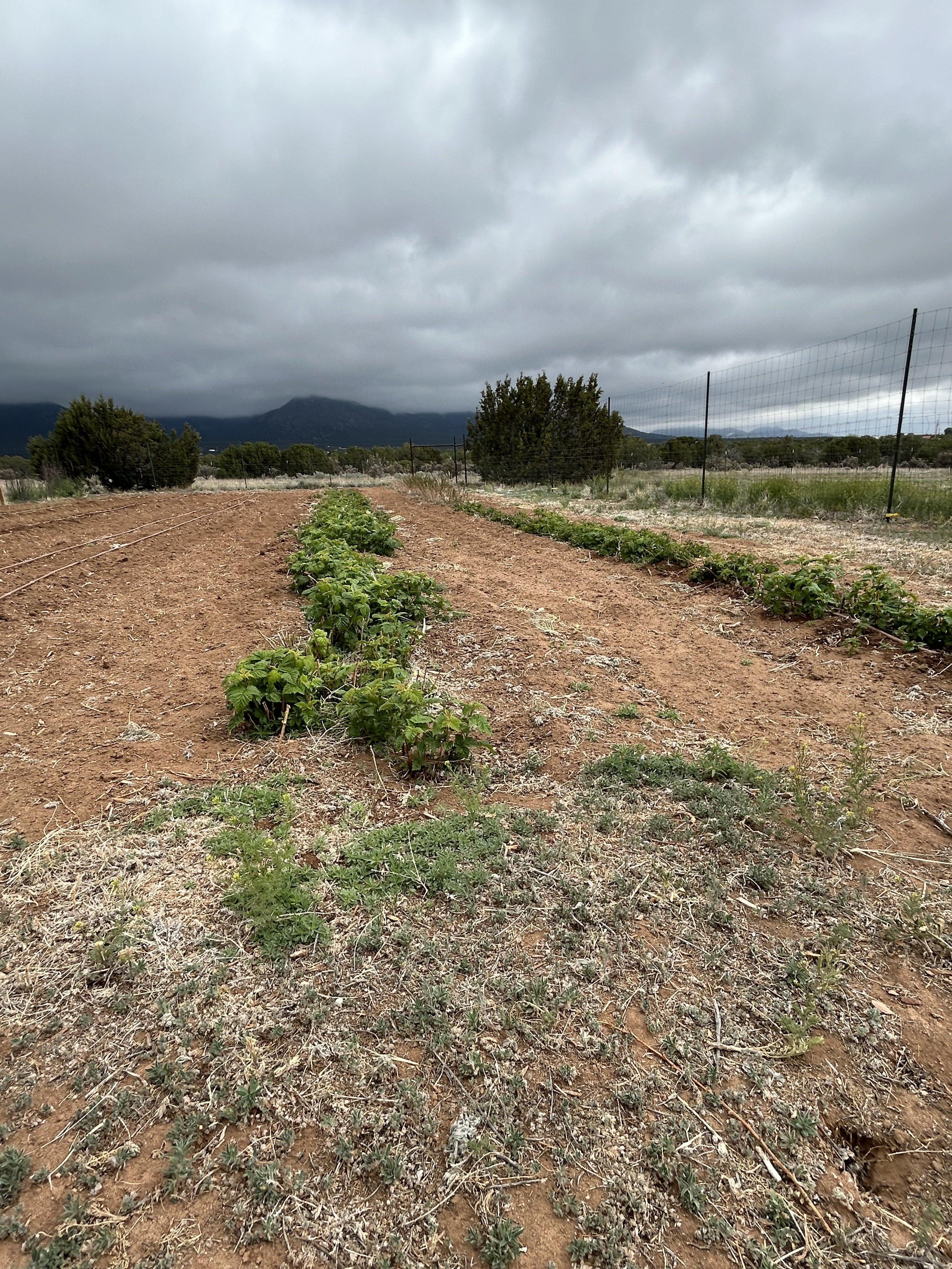

I used 8' fixed knot fencing. 6"x6"x10' corner and line posts and 2"x8" bracing. I filled in the spaces with 10' T-posts. Fenced in about 3 times what you are fencing for a garden. Got the wire from Deer Busters.
   / (Mule) Deer fence construction recommendations #3
I sunk all of my 6x6s in concrete. Just drove the t-posts. Used a 12" auger.

I built a one acre mule deer fence around my garden and orchard using pipe braced corners set in concrete and 10’ t posts. I stacked two rolls of 4’ field fence to create a 8’ fence. It has kept deer out for the past 8 years. But my fence is a rectangle and this works well. Since you have an irregular area to fence, I recommend strong braced pipe corners set in concrete, 10’ t posts, and 9 strands of high tensile wires instead of field fence. High tensile strands can be stretched in curved runs, not just a straight pull.

Stretching high-tensile in curves tends to pull posts over, especially t-posts.
Field fence doesn't need to be under much tension to keep deer out since they'll see it, so IMO a better choice for an irregular boundary.

True. It does help if you have a few pipe stretch panels (or trees) at the apex of the curves. Field fence is just not fun to work with, but your point is well taken. Definitely for an 8’ fence, stack two 4’ rolls of field fence. Eight foot field fence is a beast to work with.

It is a beast to string that's for sure. I actually did most of mine by myself. I made a contraption to hang a roll of fence from my FEL. It hung on a swivel hook. I would fasten the end and back the tractor up to the next end post. Stretching it wasn't so bad. It does have to be decently tight or it will sag unless you use a ton of posts.

I did exactly the same thing, but stacked 2 4’ rolls instead of trying to stretch an 8 footer.

Before I built my 8.5’ fence, I tried motion lights, motion sprinklers, electric fence, baited electric fence, and double fences. None of those things worked for mule deer. My tall fence has now worked great for 8 years.
