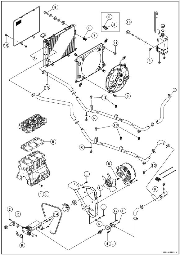

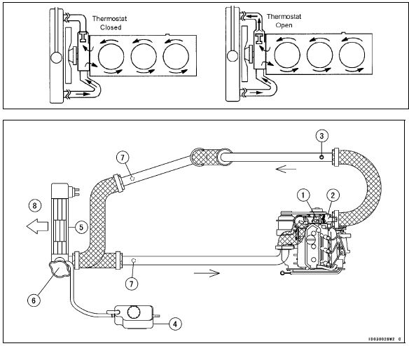

P.S. Here are the cooling system diagrams...

Is the bottom hose collapsing? There should be a big spring inside to prevent this.

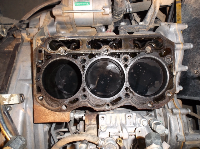

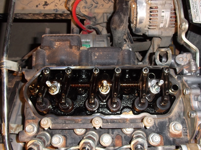

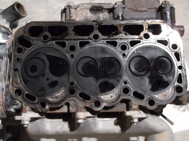

Got all the parts in finally, and got the head gasket replaced. This seem to have fixed the issue. The Mule is running great and is no longer overheating, even with the temperatures we've been having during the day here (108 - 116 the last few days). :D
To answer the head bolt question...
No, the service manual doesn't state that they need to be replaced, and they aren't torque to spec then add X degrees. But since everything takes forever to get here, it was just safer to go ahead and get new ones. You know how it goes....the part you need is the part you don't have. :laughing:
I did use the new ones when I put things back together as a few of them had quite a bit of corrosion on the threads, and I don't have a wire wheel or even a handheld wire brush to clean things up with.
The procedure for changing the head gasket is straight forward, and it only took me about 3 hours to change it, taking my time.
It looks like the head gasket was leaking into the water jacket on all 3 cylinders. Mostly #1 and #2, but a little bit on #3 as well. The head is cast iron and there was no warping when I measured it. Everything cleaned up real good and went back together just as easy as it came apart. It was about $150 for all the parts (including shipping), but there are a couple of gaskets I didn't end up using.
The diesel engine on these is dead simple.... push rod valve train and solid lifters so no overhead cam or chain to mess with.
Here's a couple of pics for those that are interested...

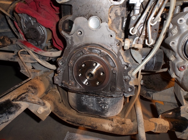

Either because of the overheating issue (most likely), or just bad luck.... the rear main oil seal developed a leak at the same time it began overheating. I had to change the seal as well. I actually did this a couple of weeks ago before realizing the overheating issue wasn't just due to a failed thermostat...
Changing the rear seal is slightly more involved than the head gasket....:rolleyes: the entire converter system has to be removed...:confused2:

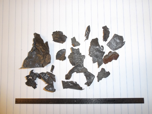

Oh.... I figured out what the 'plastic' stuff was in the cooling system. It's the lining on the inside of the water pipes that run under the Mule from the engine to the radiator. I pulled the pipes off to verify they were clean. I found quite a bit of this stuff coming loose from the pipe. I think it must be some type of anti-corrosion paint or coating. It had only come off on the ends near the engine. I'm thinking that maybe the steam from the engine overheating was hot enough to make it separate from the pipes. But who knows...:confused: I scraped off all the loose bits, so hopefully no more will come off.
Here's a pic of the stuff I originally found. I probably removed 3 or 4 times that amount from the pipes when I cleaned them....
(that's a 6 inch ruler for scale...)
