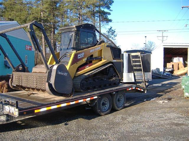

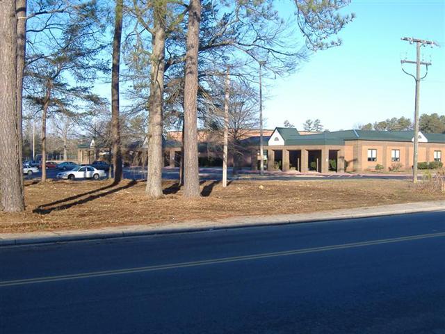

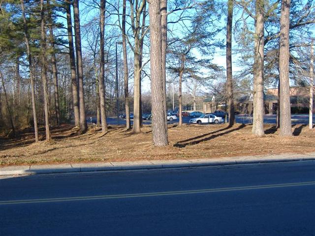

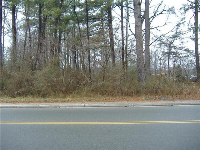

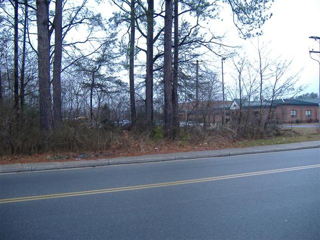

Got a few pics here of a small job I just did with our RC100/Timber Ax Robbie
Have had the machine awhile now and I can do nothing but echo your statements about how good the Timber Ax works....how do you handle the blade sharpening? I usually try and sharpen every day as they seem to lose their edge after a full day's work

Welcome to the site. Very nice work. You cleaned it up very tight around the remaining trees. I like your forestry package also. They came out with it shortly after I bought mine. oh well.
I try to keep them out of the dirt and only sharpen once a week. But if I've been hard on them I will sharpen as needed. Just killed a set with 100 hrs on them. I have found a guy locally that is making them for me. Were going with a set similiar to the originals of regular steel not the new alloy. Alittle cheaper then loftness and quicker. He's checking into making me a set of the "alloy" type next. We have also tinkered with having multiple sets and just swapping them and let him sharpen on his CNC machine. This would allow me to go from job to job day after day without the two hour "grinding party". This route would have a few drawbacks like the cost of machining and time to take them. My wife said she could take them so i might try a time or two if there really bad and sharpen myself if not super dull.
I do love my timberax. And as you know 100's run them very well. I would like a carbide head for bigger stuff and to save the timberax from "abuse" but money will tell.
As you know after a few times of sharpening we get a little technique going and it's not to bad.
How's business for you? Good to hear from another Timberaxer.. Robbie
