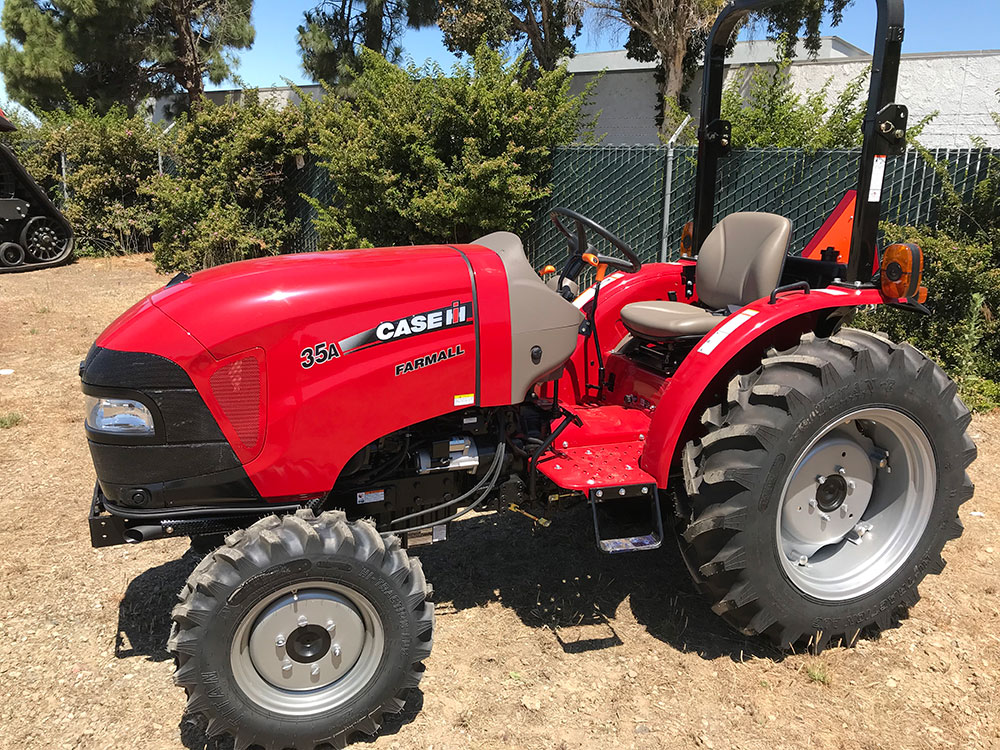

I was at a dealership looking at some LS 2s. The exhaust on them runs forward on the left side of the engine and terminates right at the front near the bottom of the engine cowling. It seems like this is a potential problem. I found this picture of the Case version. You can see it if you zoom in a bit. Has anyone run into trouble with this?
The 3s are higher up and don't go to the end...plus the terminus faces the back. In short it seems much better protected.

I had a SCUT (LS MT125), and now my small compact (LS XG3025) and they both exit as on the Case (by the way, it's made by LS for Case). No problem at all with the exhaust in that spot, except for the loader arm getting a little bit sooty. Basically because when starting, the loader arm is down and the most soot is at startup.

Thanks. I knew LS made Case and NH models. I used this pic because it showed the exhaust well. I am just imagining picking up brush and branches and having them damage the exhaust. LS seems priced well enough that the 3 series or bigger will not be out of reach.

I think you would have a very hard time damaging the exhaust at that location. Mine is the same, and it's tucked far enough up in there that plenty of the rest of the tractor is going to hit the object before the exhaust does. The only reason I wish mine was a vertical stack out of the hood, was so that when I'm mowing, My exhaust isn't blowing chaff up in the air in front of the grill, coolers and radiator.
But damage? I can't see how you could do anything to damage the exhaust that won't tear big chunks of tractor off the front end first.

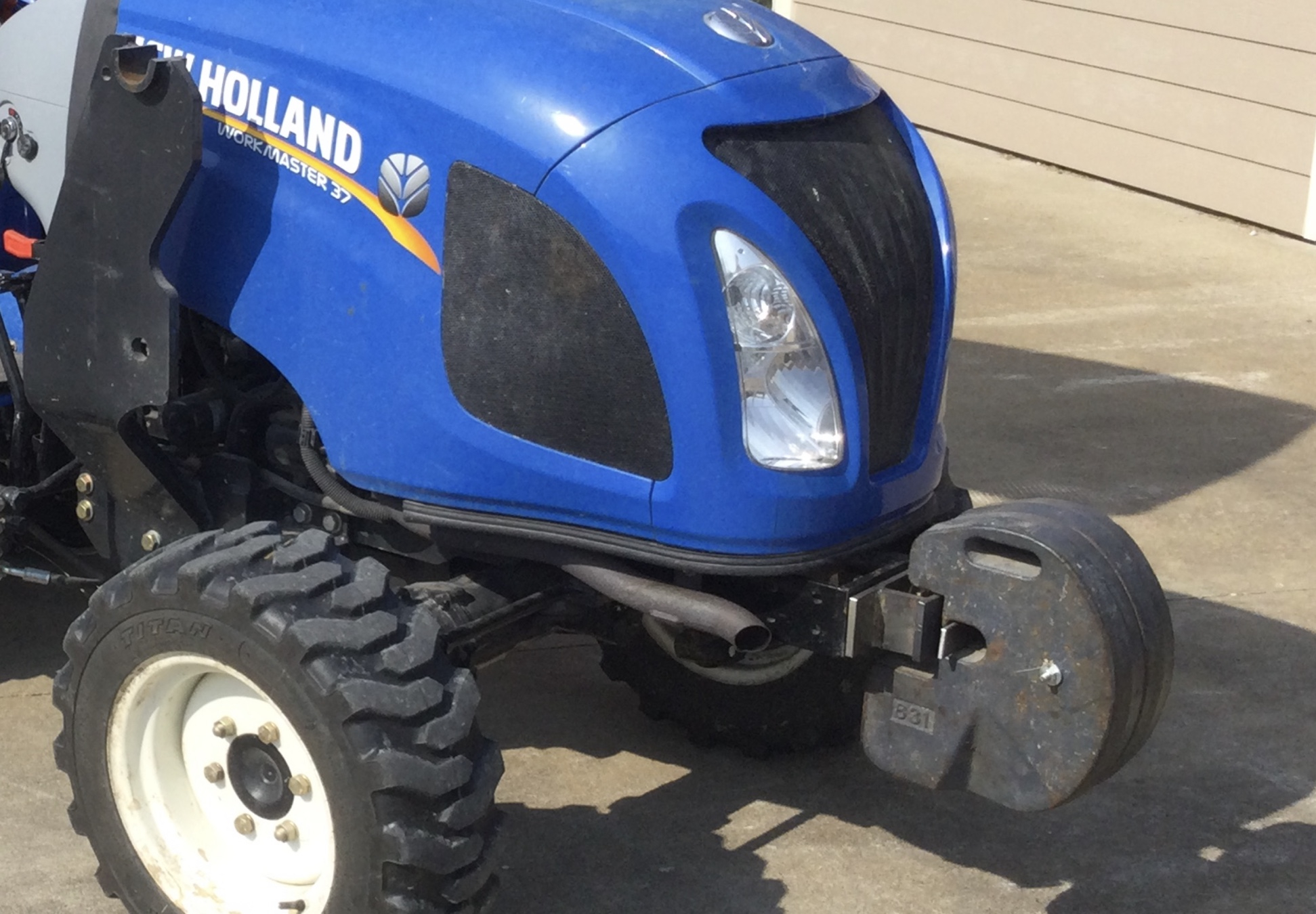

My NH has the exhaust in this location, and it is a little less tucked in, too. There's a picture here that illustrates it pretty well:
I really dislike this. It's the worst feature of the machine, in my opinion. Not because it catches things, but because I'm always breathing the exhaust, and always smell like it after seat time. I don't get it -- why do they put the exhaust plume where you're driving? My biggest customization, which I still have not gotten done, is to add a vertical exhaust a bit ahead of the clutch pedal. My old Kubota had a vertical exhaust and had none of this problem.

My NH Workmaster 37 has it in a similar location on the other side. It’s tucked in tight and has caused no problems.

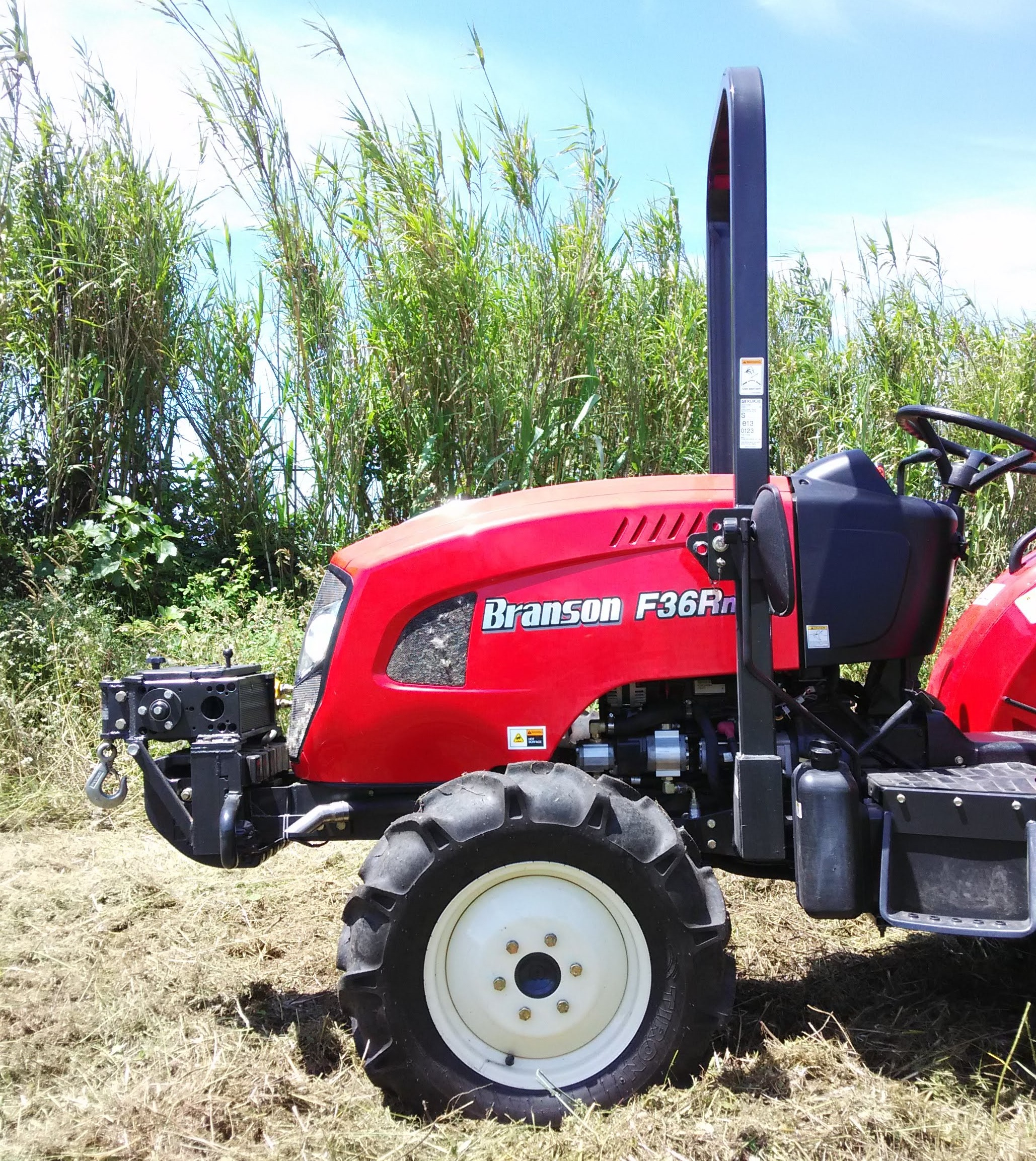

The exhaust there is just fine and the only possible issue really, is that it covers the loader arms full of soot and in my case, the little bumper/light support. To avoid that, I did make a turn down tip out of stainless steel pipe.

See, you protected yours with a winch. 😉

Mine is the same style and I also added a turn down (and to the side) like ptsg. I've never had it get snagged or touched by anything but...like slowpoke slim I have problems with the chaff and leaves etc., etc. blowing up and swiftly clogging the radiator. I'm constantly thinking about different directions and ways for it to exhaust in some other style. Just haven't come up with the right solution yet. Eventually I will.
