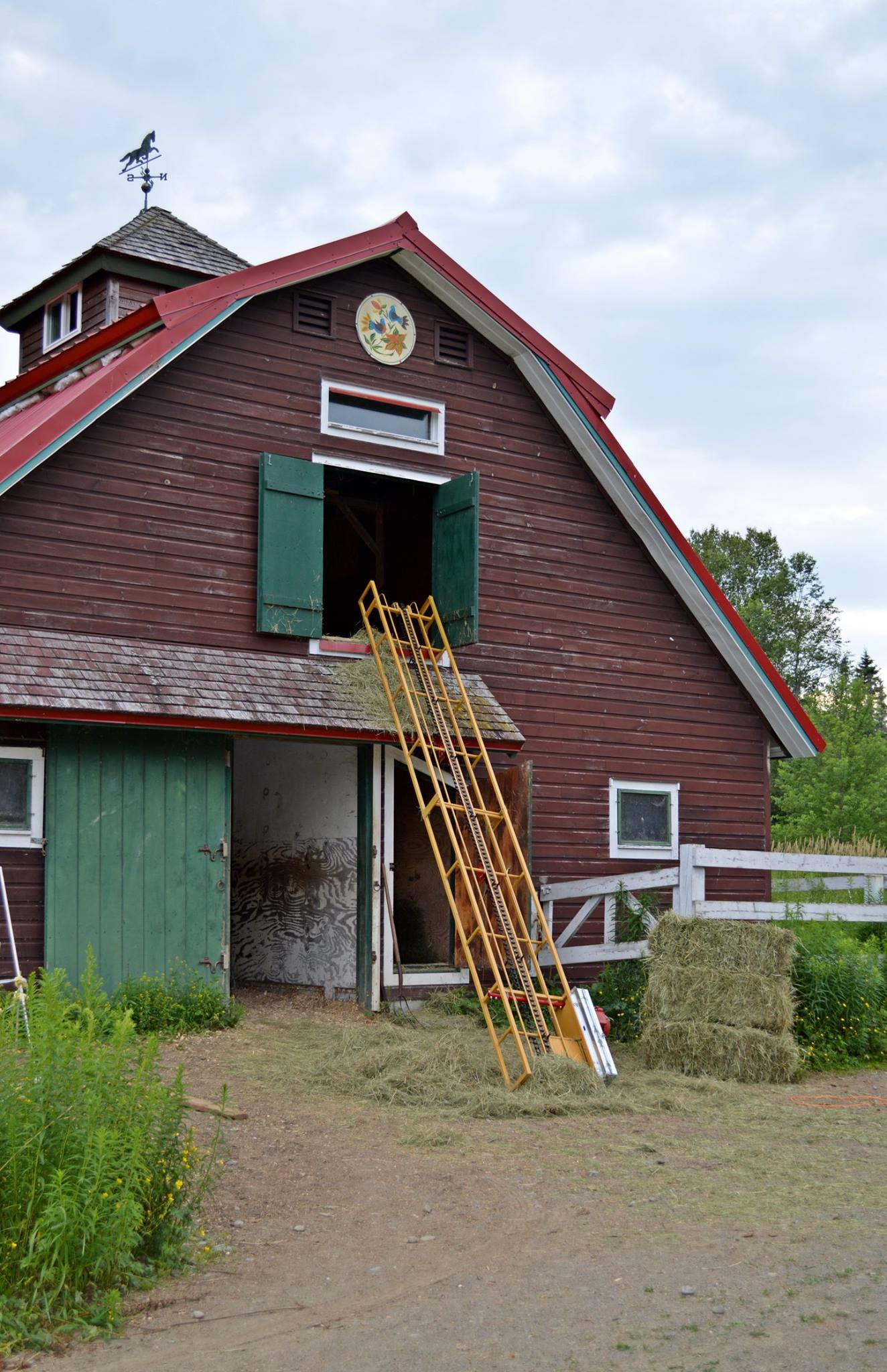

Our two horses enter the barn through the same door we do. Their feet mix the sawdust, manure, in with the dirt and it can get pretty thick. There is a slope to get into the barn and a crosscutting drainage slope fifteen feet from the doorr as well. It still gets mucky.
I find the solution is to start with sloped dirt base, gravel on top of that. The horses add the manure, drag sawdust, and mix it. The rain and snow keeps it moist. - What I do is rake it down to the gravel (like cleaning the barn), and scrape it with the bucket 3-4x a year. Every few years I add more gravel.
This is the entrance to the barn- about end of June. Couple of years without fresh gravel.
