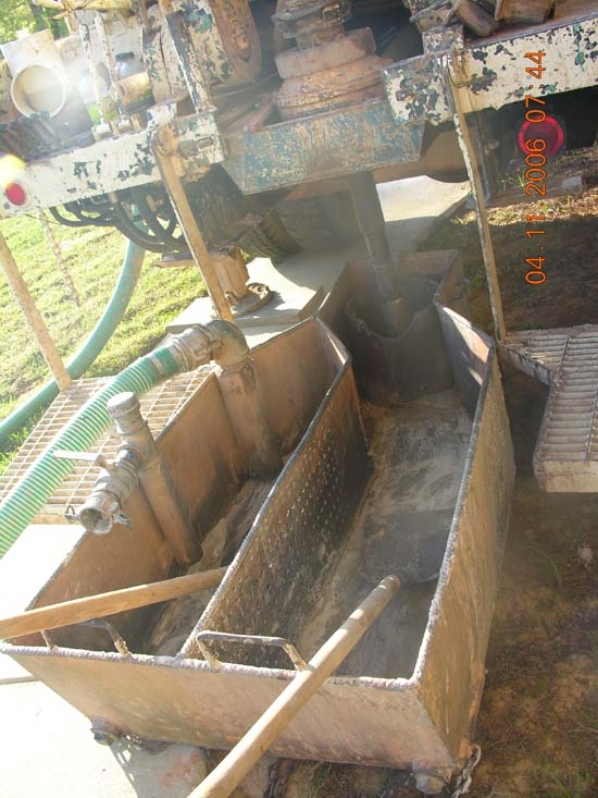

Here is an example of a pan that does not have a hole in it so you had to shove a pipe in the ground that had a lip to direct mud to the pan.

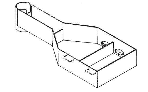

here is a pan that has the hole in it so you can drill through the pan. This is what I used as the weight of the pan would keep the overflow pipe held in the bore and sealed up better. They are a bit more of a pain to move though since the guitar shape is a bit more ungainly.
