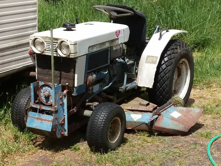

Right, I have the manual, it gives factory part numbers. So what is the actual bearing? 6102, 6202 etc. I have a ton of bearings in stock, but don't want to tear it down and find i need to order something else. Then i have a dead unit laying here untill parts arrive. Just hoping someone out there has worked on one of these before. (P.S. I don't pay factory prices for parts, try to find better alternative solutions for my customers.) Example, factory spot welded idler. Drill out spot welds to say, 1/4", separate pulley halves, drive out old bearing, replace and reassemble pulley using 1/4" bolts w/shakeproof nuts. Now you have a repairable part that will last a lifetime and is only $1.50 to repair instead of $15.

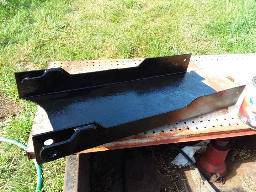

Haban front deck support pan. Scraped off 3" dirt, grease & ?? Sanded rust off and gave it a good coat of bed liner20180602_163334.jpeg
