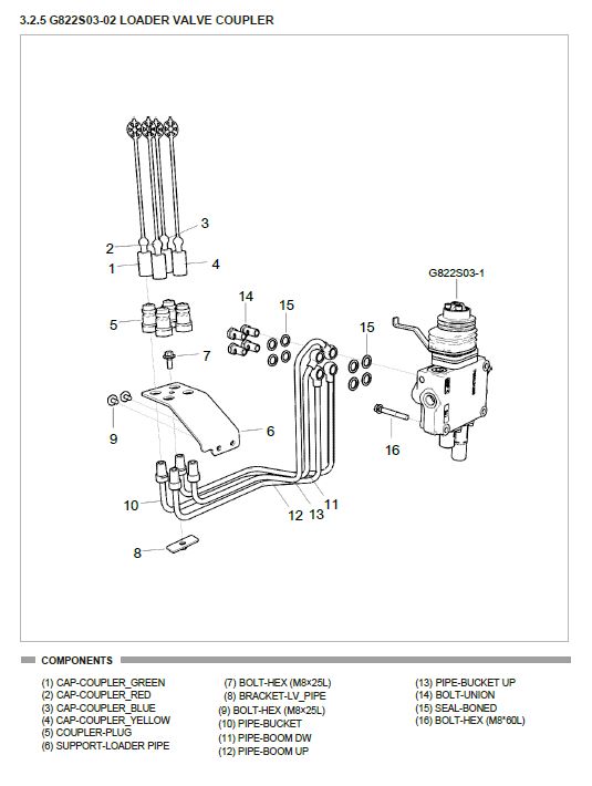

Has anyone had any luck locating parts and service manuals online for the MT125? I seem some old posts, but seem to get nowhere. I’m looking for components to the FEL Joystick valve.

The valve is only sold as a complete unit. However, there is a YouTube video in which somebody repaired their valve using parts from Ebay. LS MT125 FEL Joystick Problem - YouTube
I seen that video. I was going to see if LS actually sells those pieces. Either way the tractor is under warranty. I was just looking to see if it something simple.

This is about it. I see discussion of removing and reinstalling it, but no discussion or diagrams of disassembly or internal parts.
