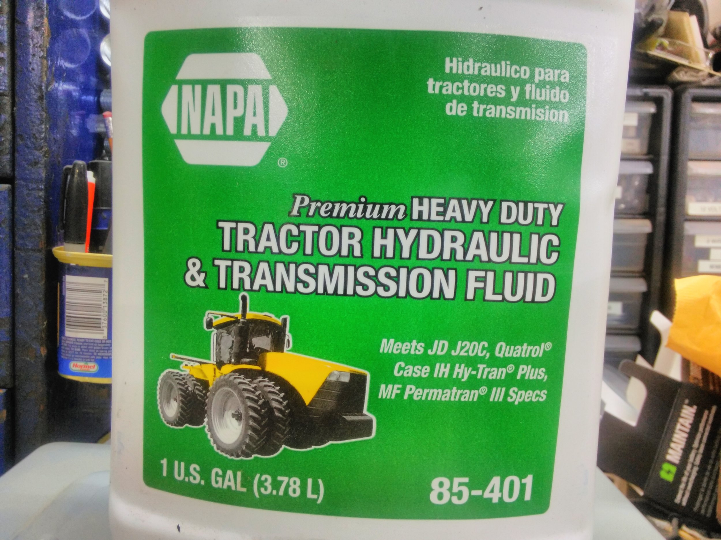

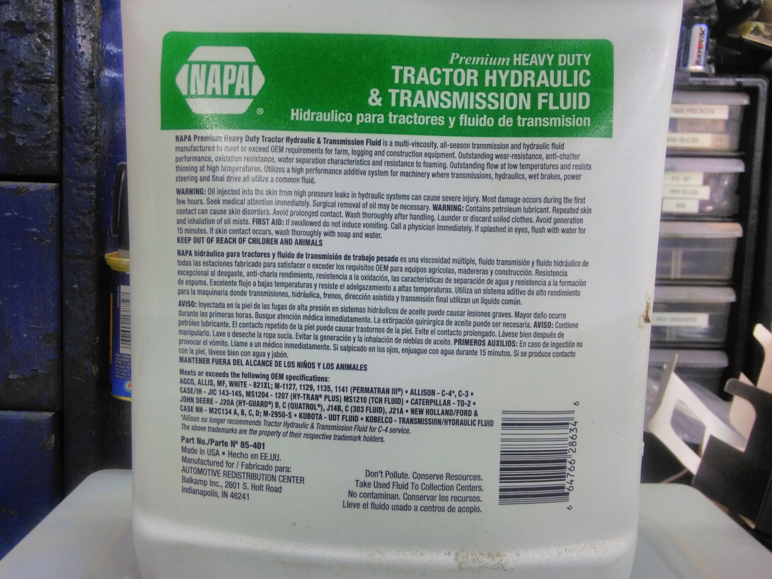

This is what my Dealer uses in setting up all his LS Tractors:
   / MT 125 Hydorlic Transmission oil. #3
The red color should be just a dye. It's used to make it easier to see on the dipstick and identify oil leaks from other oils. You can buy the dye and put it in yourself. It doesn't take much to treat 5 gallons.

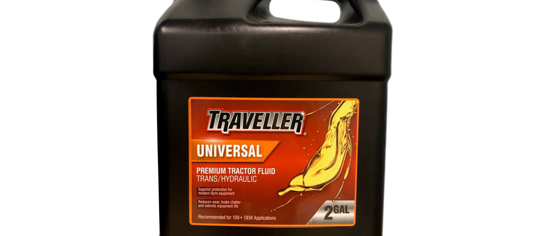

So this is the stuff I got a Tractor Supply Co. Looks like it has the specs of the your NAPA stuff. I didn't want to go back to NAPA because if they did not know what to sell me the first time the probabaly wouldn't know the second time. I told them the specs from the manual and they sold me the TO-4. I called the LS dealer I bought the tractor from and they said they would have to order the oil from LS. Really?! They wouldn't/couldn't tell me anything else to use. Luckily it comes in 2 gallon jugs because the first half gallon went out the drain hole, like an idiot I forgot to put in the plug!
The Traveller 591568 Universal Tractor Trans/Hydraulic Fluid is ideal for farm tractors and construction equipment.
  • 2 gallons
  • Premium Tractor Fluid is a premium, multi-purpose lubricant formulated from select base stocks and an advanced additive system. It is engineered for use in a variety of farm equipment, off highway machinery, industrial tractors, final drives, power take-off units, wet brakes, power steering units and hydraulic systems. It provides the unique combination of ultimate equipment protection and the convenience of using one fluid in place of two or more fluids while maintaining optimum equipment performance and component durability. Balanced frictional properties and shear-stable viscosity modifiers deliver trouble-free operation and trusted performance.
  • J20C
  • UTHF J20C formula
  • Temperature rating: -44 to 439°F
  • 2 Gallon
  • Recommended for agriculture equipment and off-highway machinery requiring the following: John Deere: Quatrol, J20C, J20A, J21A, Hy-Gard J14B/C & Type 303 Fluid International Harvestor: Hy-Tran, B-6 AGCO (Massey Ferguson): M-1145, M-1143, M-1110, M-1127B, M-1129A, M-1135 Permatran III, M-1138, M-1141, White Q-1826, Allis Chalmers Power Fluid 821 XL, Duetz-Allis Hyd Trans Fluid, 25743, 272843, & AGCO-Allis Caterpillar: TO-2, & MTO (Multi- Application Tractor Oil), for older Backhoe Loader rear axles and Challenger Tractors J.I. Case: TFD (JIC-143/146), Hi-Vis (JIC-185), JIC-144/145, MS-1204, MS1205/1206/1207, MS-1210 (TCH) & B-6 Case New Holland: MAT3540, MAT3505, MAT3525, MAT3526, ESNM2C86-A/B/C, M2C134-A/B/C/D, M2C41-B, M2C43, M2C53-A/B & M2C92-A Vickers: I-2986-S, 104C, & M2950S, Denison UTTO, HF-0, HF-01, HF-02 Kubota Universal Transdraulic Fluid: UTD & Super UTD Sundstrand Hydrostatic Transmissions: JDQ-84 Volvo: BM, VCE 1273.03 & WB-101 (wet brake) Allison: C-4
