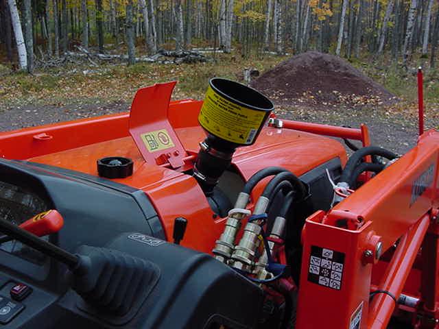

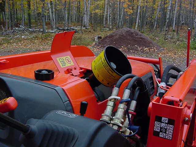

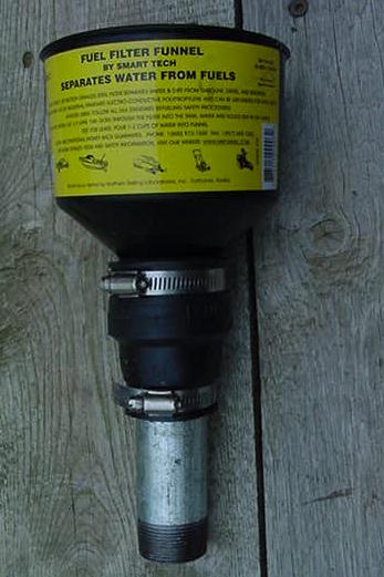

Darren - The diameter of the bottom section of the funnel is so small that it flops over in the tank fill hole when pouring into it. The middle section is too large to fit into the tank, so it doesn't hold it erect. I went to the hardware store this AM and bought a Fernco Fitting and 5" legth of 2" galvanized pipe. Cobbled it together - it aint pretty, but does the job. Put in 5 gal of diesel today without a problem. Will take a picture of it tomorrow and post it, for what it's worth.

Took a few pictures today - first one shows how the funnel tilts and created problems while filling (3 pics altogether)

How funnel sits, and allows me to fill tank without a problem.

Not pretty, but it works.

Nice fix for an ugly problem. The filler on my tractor is in the center of the hood and it's perfectly horizontal.

As I see it," What ever works". /forums/images/graemlins/wink.gif Gerard
