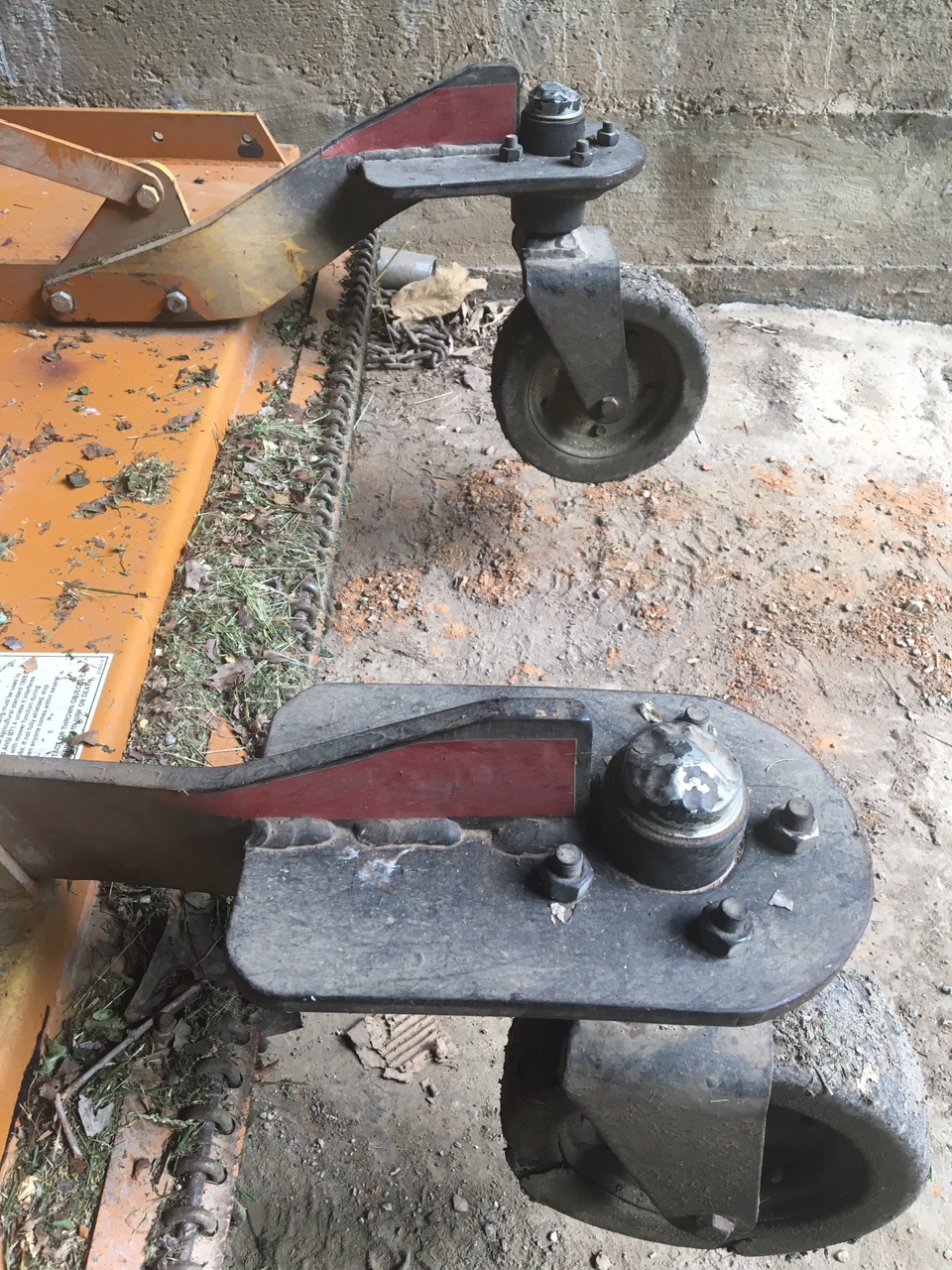

We have tried many different machines to maintain our hilly, wooded property. We used a Kubota B20 and 6’ finish mowers for over 20 years. Upgraded to B26 a few years ago. Better in most all aspects. Installed 2” rear wheel spacers and ballast to help stability. The Woods RD7200 just turned 20 years old. Been a good mower except for the wheel spindles. With all the back and forth trimming we do and with the incredible turning capacity and traction of the tractor would easily bend the spindles. Replaced the 1” spindles with 4140 steel that helped for years but with bushing wear and use they would bend too. Replacement bushing/arm and spindles are extremely expensive and don’t last long in my use. Cut the bushings off, made plates to utilize 3500# trailer axle hubs and stubs. So much stronger than OEM. Harder to adjust height but we never did for our use. No problems for over 6 years. Takes 5-6 gallons of fuel to mow. Wife like to do most of the mowing except for real steep stuff.

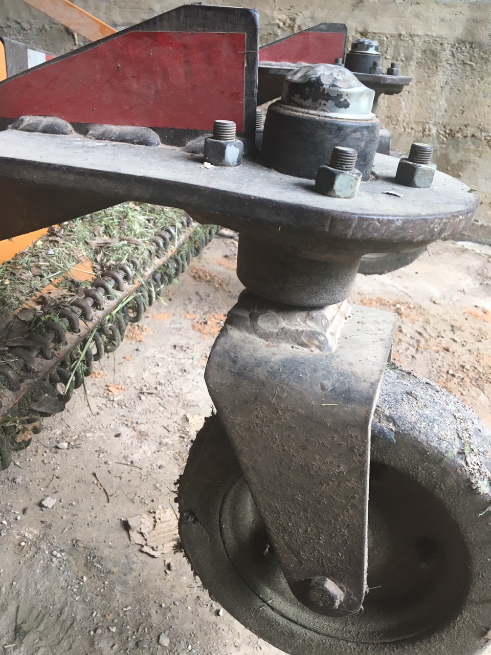

Hope the pictures show enough detail.
4-3500# trailer spindles, hubs and bearings cost $115 eBay.
Plate 7”x0.5” flat bar.
Used best OEM assembly as guide.
Cut worn spindle bushing off arm.
Cut slot and hub holes in plate. Welded to arm.
Cut off old spindles shafts. Shorted axle stubs and then welded them to the yokes. Standard axle assembly.
With bolts and washers/spacers could adjust deck height. I don’t need to.
Axle shafts and bearings much stronger that OEM shafts and bushings. The bearings are sealed in the hub. No notable wear or maintenance in six years.
Other than the wheel spindles, the mower has performed well. One belt and 7-8 sets of blades in 20 years.

Was the quantity of four a typo?
Not familiar with trailer spindles but from the photos it looks like you only used two of them...
Looks great and VERY heavy duty for a finish mower. :thumbsup:

Only showed the rear ones for fabrication detail. Same fit the front.
Trailer axle stubs and hubs.
