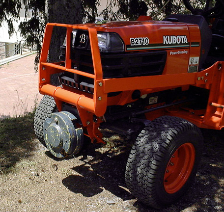

Robert, Here is a photo of the weights I put on the front of mine to help hold it down on the hills. They only weigh about 110lbs but it helps.

   / Mowing with FEL on? #20
Von,
That's a cool idea! I'll have to look at something like that, since the Kubota weights wont hang on to the loader frame now
Thanx!
