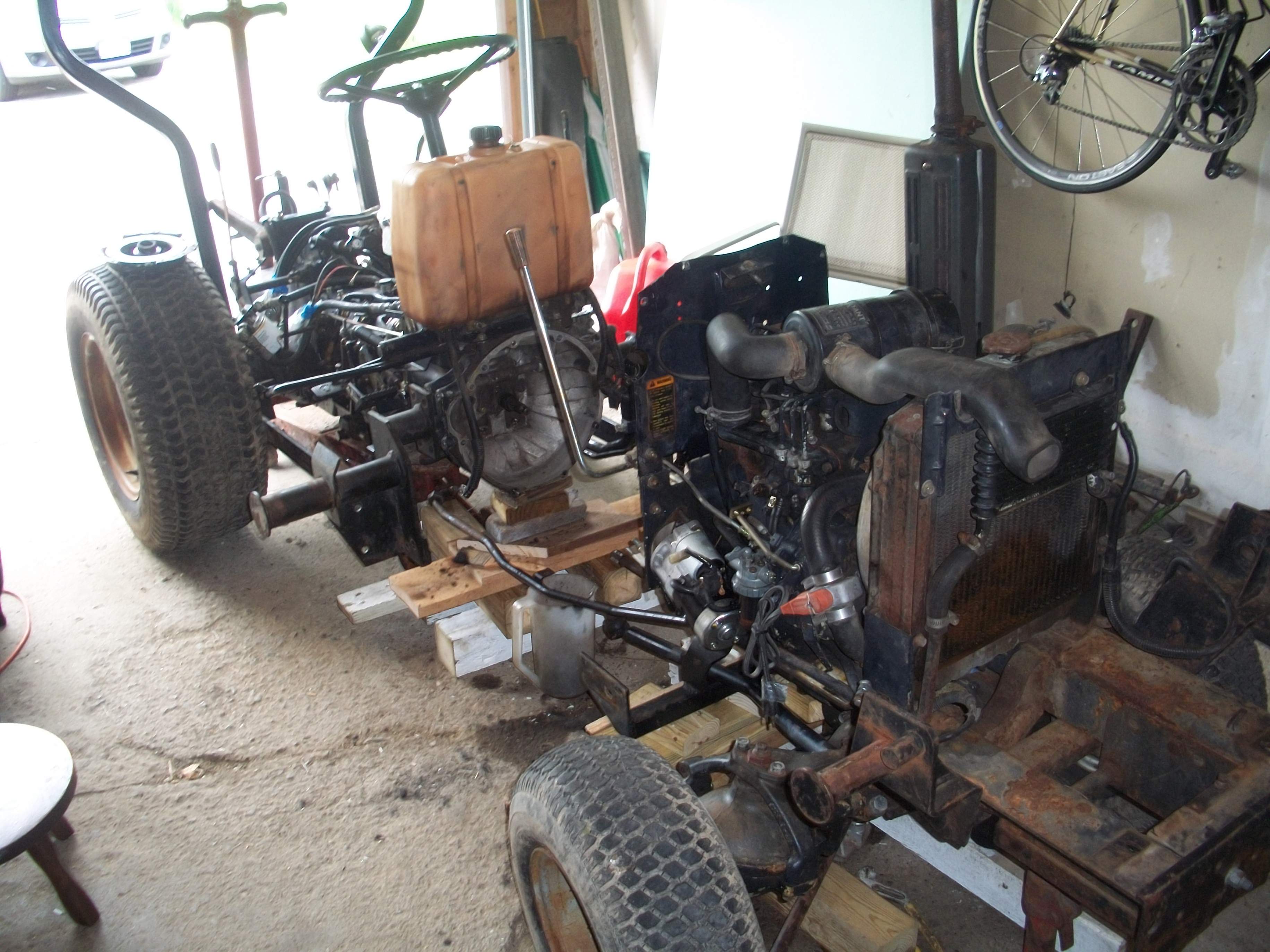

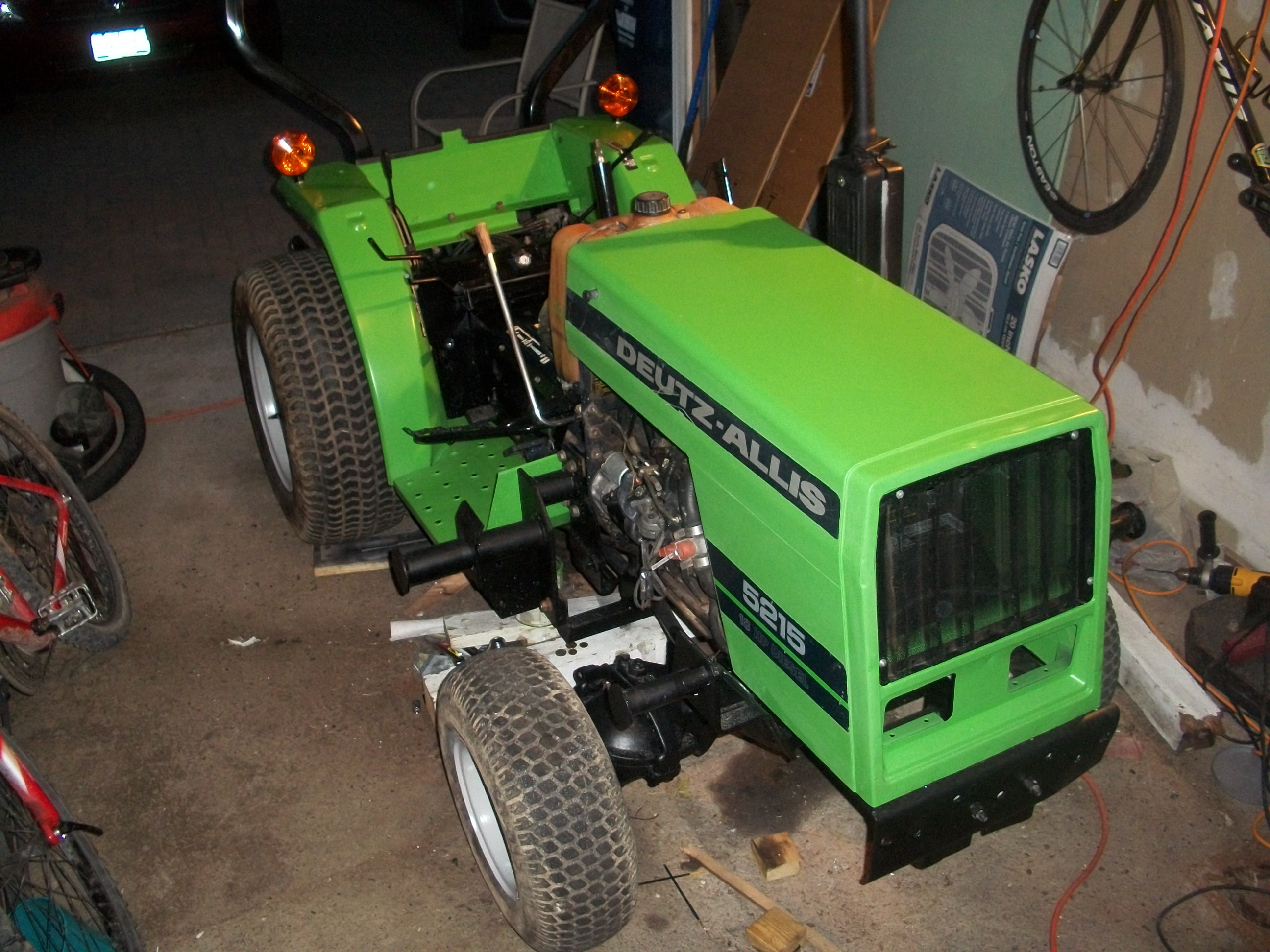

A little history may be useful.... I am a new tractor person having bought this Deutz-allis 5215 from an auction knowing that it needed a new clutch. I did that (always looking for an adventure) and then proceeded to clean up the tractor and put in new filters and hydraulic oil. The hydraulic oil was the inexpensive kind bought at TSC. I did mow the grass when it was dry in mid range with no noticible problem. Wet grass was a problem in mid range. It behaves fine when the mower is not engaged going up slight inclines in mid range with no issue. On the road the tractor goes very well.
The belly mower is run off of the 14hp pto that has a box on it to reverse the direction of the 540 rpm pto so it can drive the belly mower (the mid pto does not run the belly mower). The deck was purchased seperatly from the tractor. I am wondering if the 60inch deck is at the upper limit of the tractors capabilities.
The FEL can pick up just about anything and it seems to run fine in all ranges when no load is applied. I just do not have enough experience to know what I should expect (for example... should I be able to start up a steep hill in high range?) You can see from the pics that it was not much to look at when I started this project... and it now looks pretty good.. I am just hoping it works the way it should.

Yea im gonna say that cutting tall wet weeds with a 60inch mower with 14Hp is probly too much for your tractor in mid range. Untill you said all this i was thinking problems in the HST pump/clutches.
   / mowing speed #10
Yes you should be able to start up practically anything except super steep terrain in any gear if your not mowing or doing any other work.
