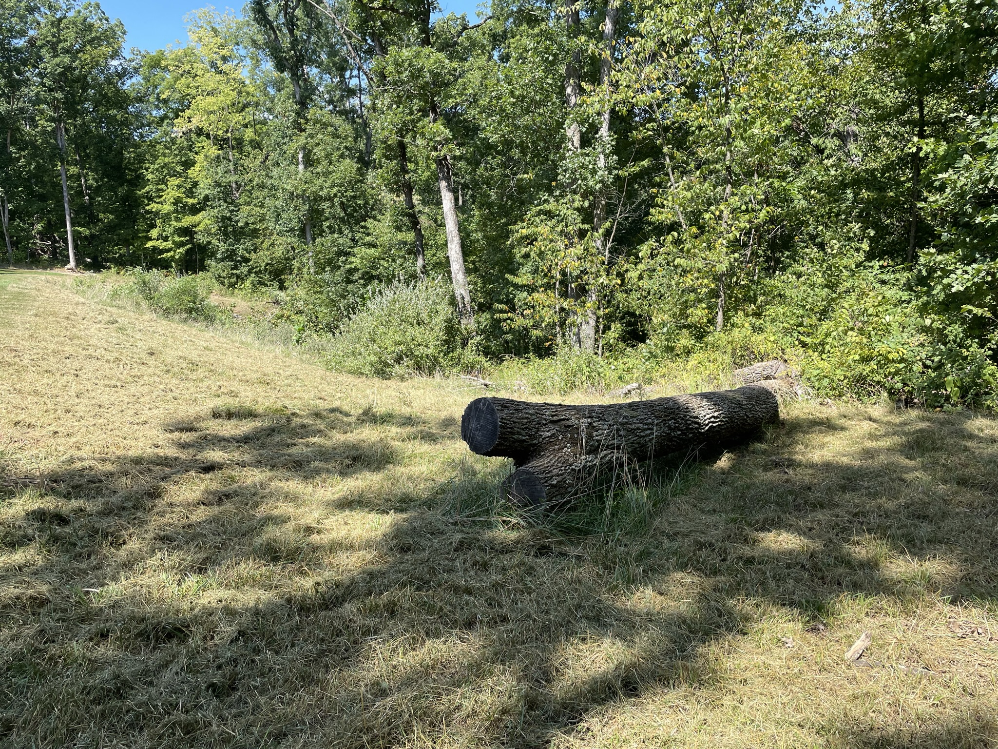

I have a CT225. I’ve spent the day chainsawing the backside of the dam. Pond is 8 yrs old. I haven’t tried mowing the back side. I noticed sycamore or cottonwood trees, locust trees, and some elms were growing up near the base of the dam.
question, whats the best way to mow back there. I have a brush hog that should work well. However, I’m not really experienced at everything, tractor. I have filled the rears with beat juice. I have the medium tread type (not ag treads). I was thinking I could back down the dam and then go back up, just getting four of five feet at a time. Definitely won’t go sideways along the dam.
Any suggestions appreciated. Including the recommendation to just “not” mow it.

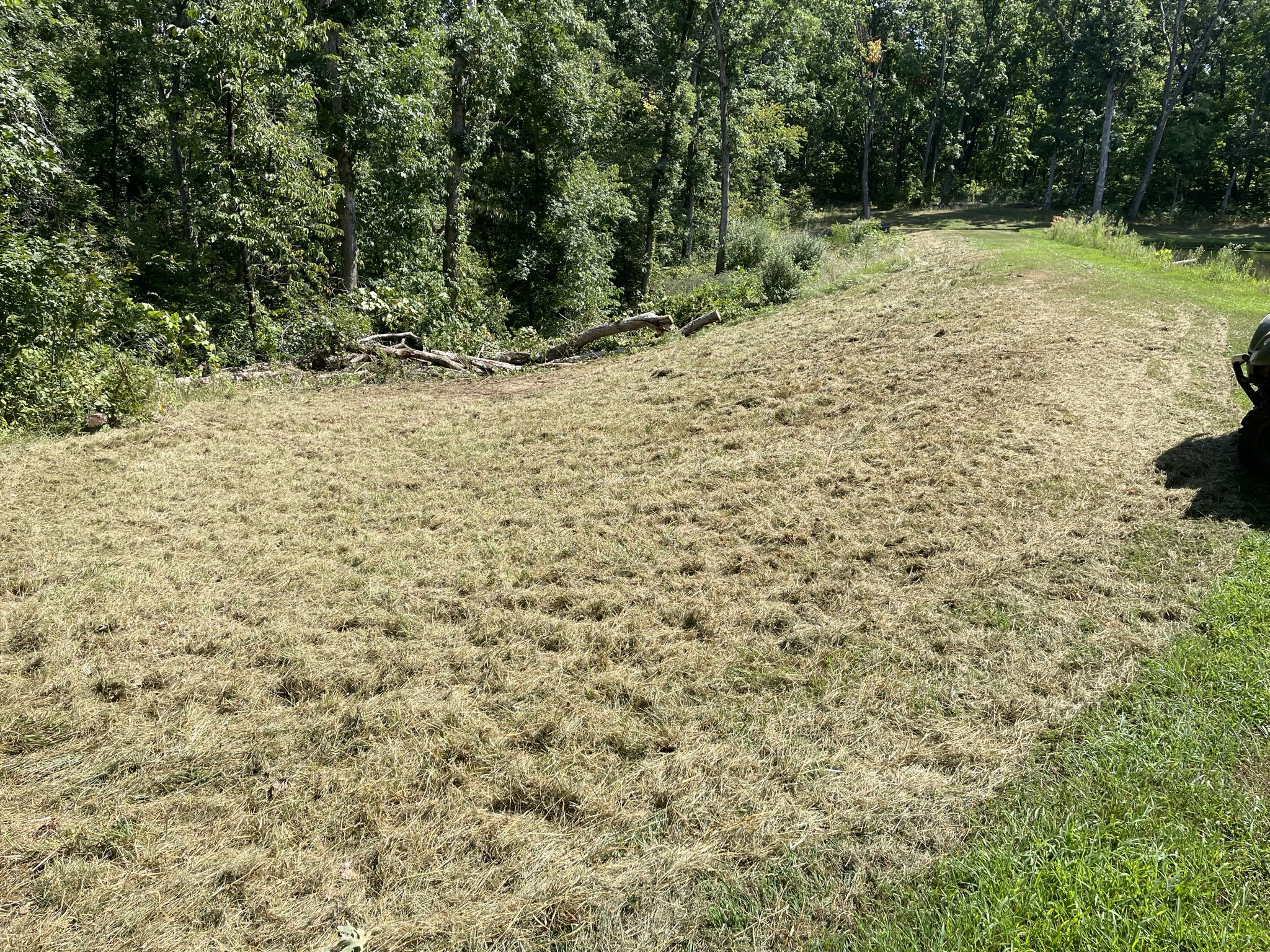

I got both ends done, and a little bit more along the top. I’m just not comfortable getting on anything steeper. Maybe I’m way off, and the ct225 with loaded tires could tilt a lot more. I’m just not going to find out. I’ll weed eat the rest when it cools off.

Looks good. Now you know some parts are "safe" and you get better a look at the hard parts. :cool:
